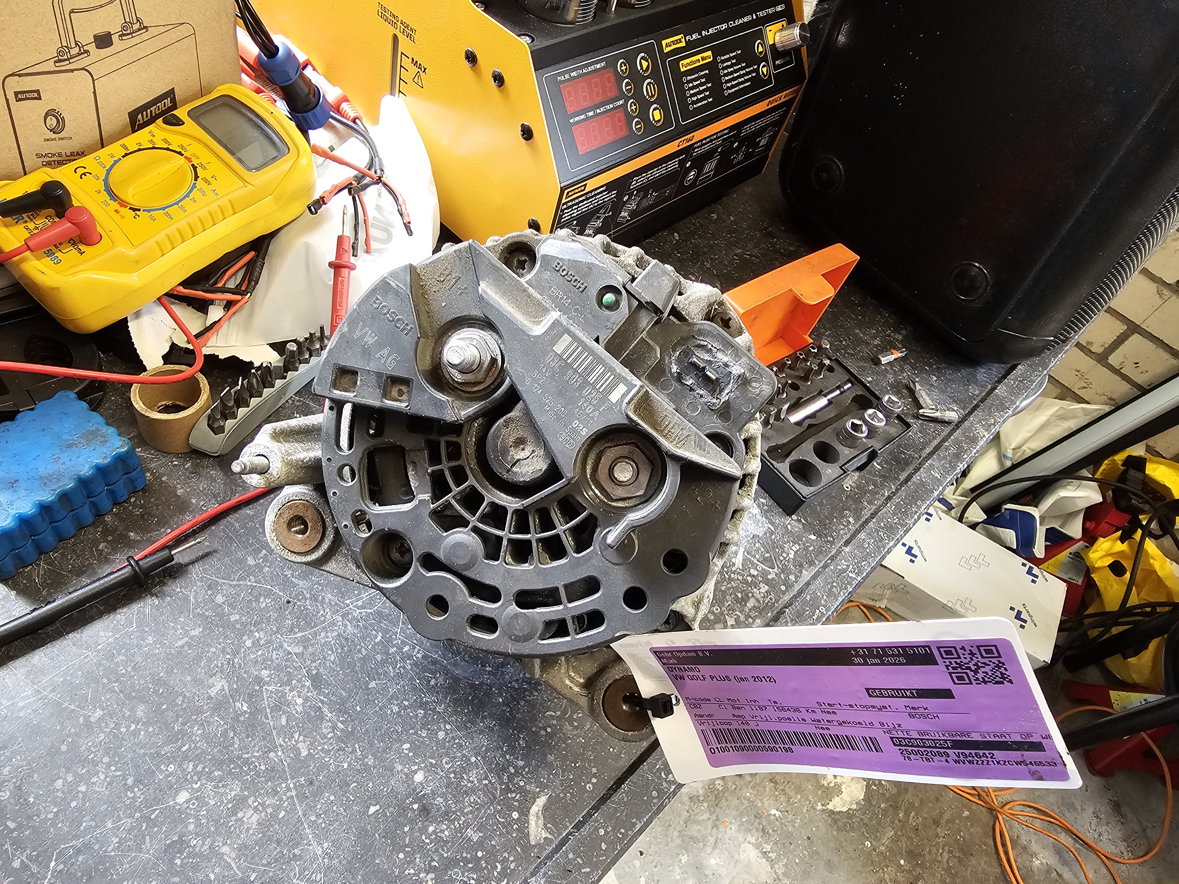

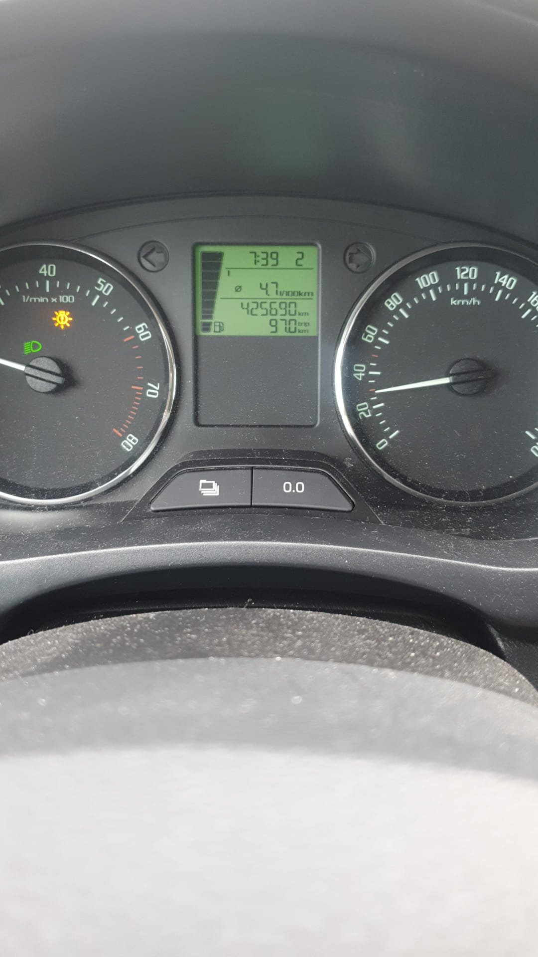

  6. I bought a set of injectors from a low mileage car. I think it had around 40k miles on them. The state of the injectors were so bad because they were so clogged with old fuel, i was unable to get them up to par with our own original injectors. Perhaps you suffered the same problem and this is exactly why i bought the machine. I need visual representation of the state of the injectors, not an assumption of good injectors. I ended up returning them and managed to balance out our own. The most impactful mechanical change were the valve cleaning, EVAP valve, turbo swap, oil separator on the back and chain/tensioner kit. Currently it's doing an insane 4.7L/100km average.
  7. Now that that's done, time to move up to doing your own injector cleaning/balancing and intake cleaning 😅 I payed €275 for the walnutblaster and €245 injector cleaner. Good tool for as long as we have ICE engines. Additional costs will just be consumables .
  8. The battery/charge warning light should by governd by the BMS. Thing is, our car was severely underperforming and leave the battery at 11.4V which way too, however the car never made any notice. When I changed the alternator, I took off the negative pole, however that sucker crept back against the negative pole without me noticing it and holding my wrench against the negative bolt of the alternator, fried the fuse box....which I found out later....i just saw nice sparks haha. Even though I swapped out the alternator and started the car, 12.2V and dropped slowly at idle. I suppose the LIN signal is severely limited what it communicates to the BMS. I wondered the same thing. I later found out that, ofcourse, the fuse board was fried but I always wondered why the car didn't report a "no/low charge signal".

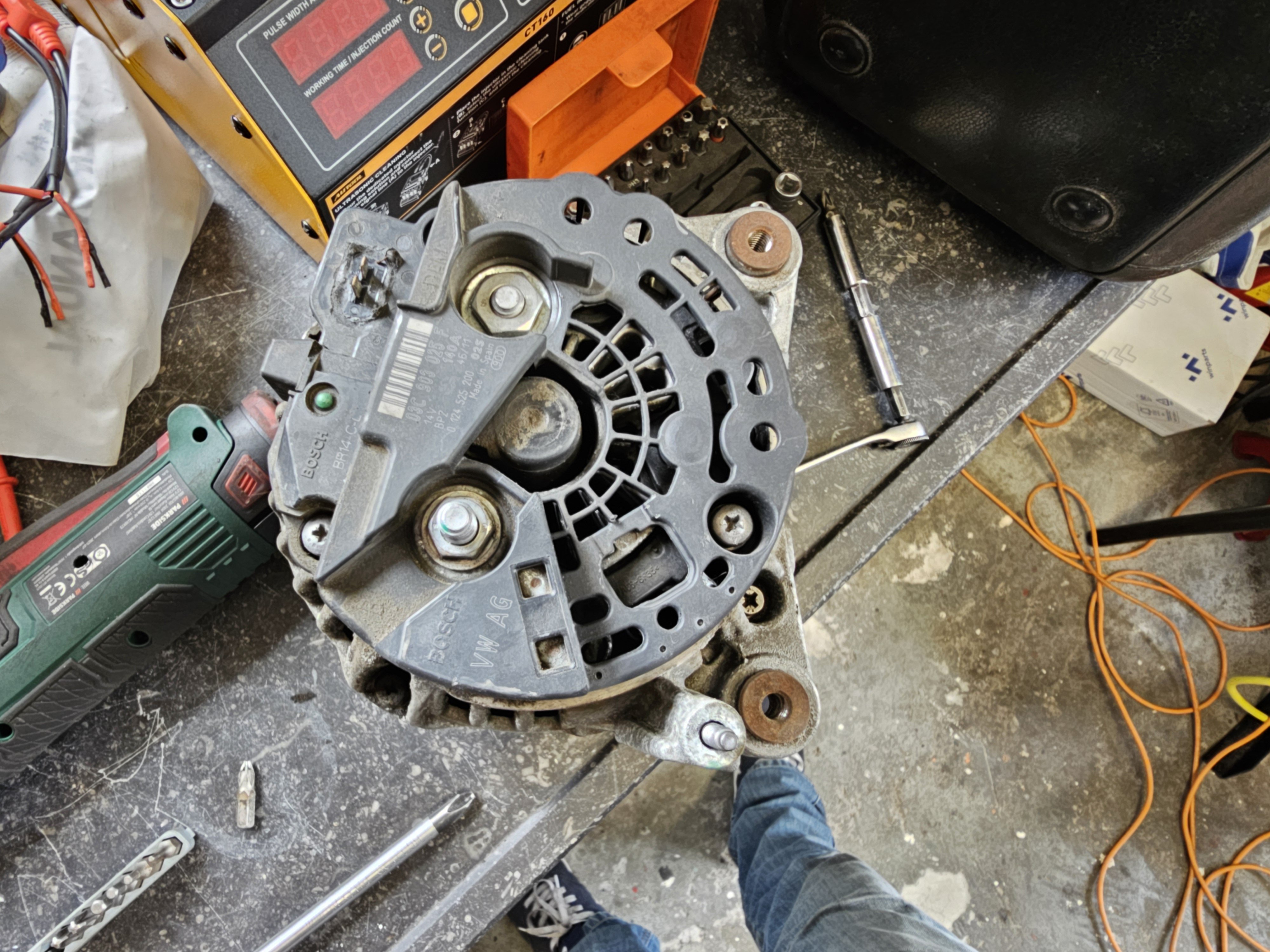

  9. You should be able to swap the alternator out in situ. Disconnect negative battery terminal. Remove the 02 sensor and remove the heat shield fasteners and move aside the heat shielding. Remove the fan shroud, remove the pulley that covers the bolt for the alternator. After that, remove the top bolt and lower the alternator with the bottom bolt still captive somewhat. Disconnect the communication plug, remove the negative clamp and the cable holder. After that, disconnect and lower away and hang the AC compressor aside, pull out the last fastener and then lower away the alternator. Reverse install the new alternator. Make sure you have part 6R0937629B with the 175A fuse for the alternator path.You don't want a lower amperage fuse board or you will end up with a no charge condition pretty quick. GL.

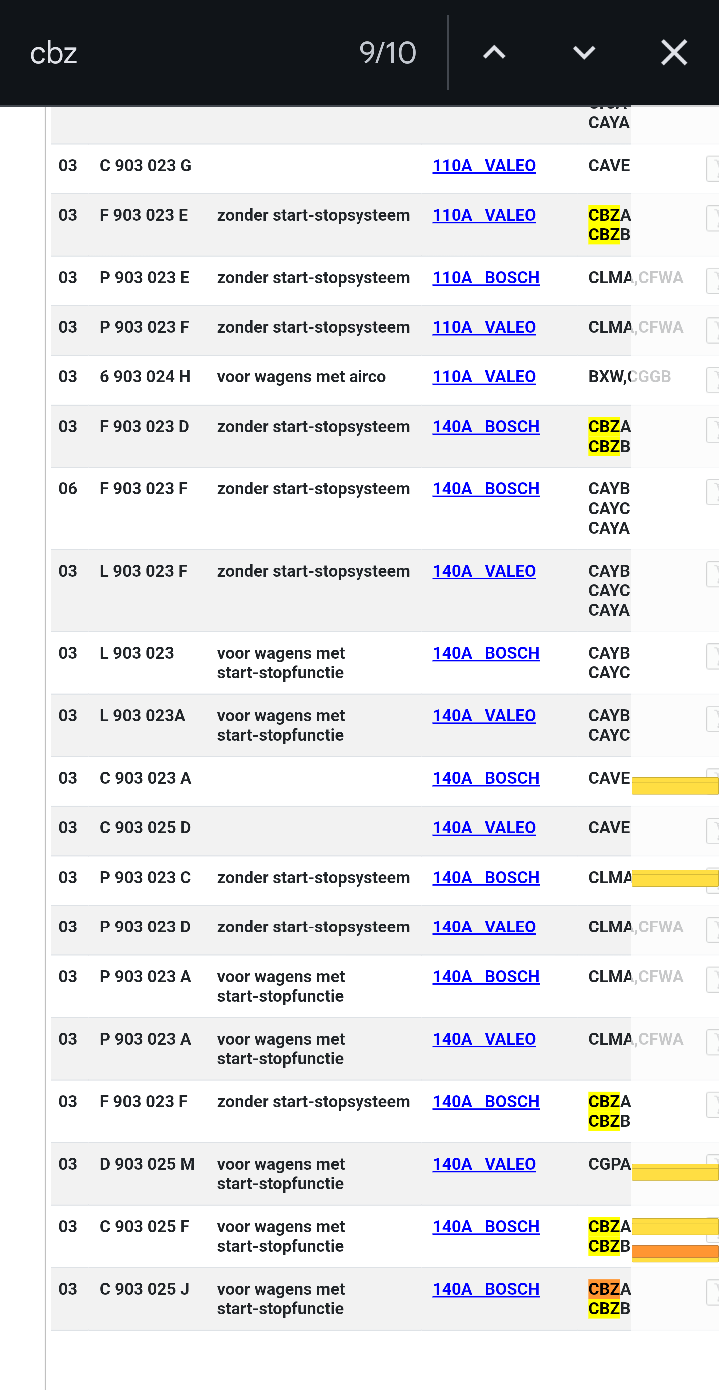

  10. Are you sure that's interchangeable? That one does not support Start/Stop. It also has been superseded by the F model. Perhaps that means it uses a different LIN pin out I'll pull up ETKA
  11. 110 amps? You sure? It's from Bosch? What accessoires does the car have. Aside from parking sensors, electric windows and AC, there are no heated seats, no adaptive headlights or anything like that in our Fabia 2 and it's packing the 140A alternator. Fuse board for the alternator is 175A as well. This is the International portal for our local junkers. This is also where is source most of the parts i slap in/on cars. They are legit. Alternators
  12. Alternator pulley/clutch turns and slips both ways
  13. I'll check in bit. If I remember correctly, it is supposed to freewheel both directions.

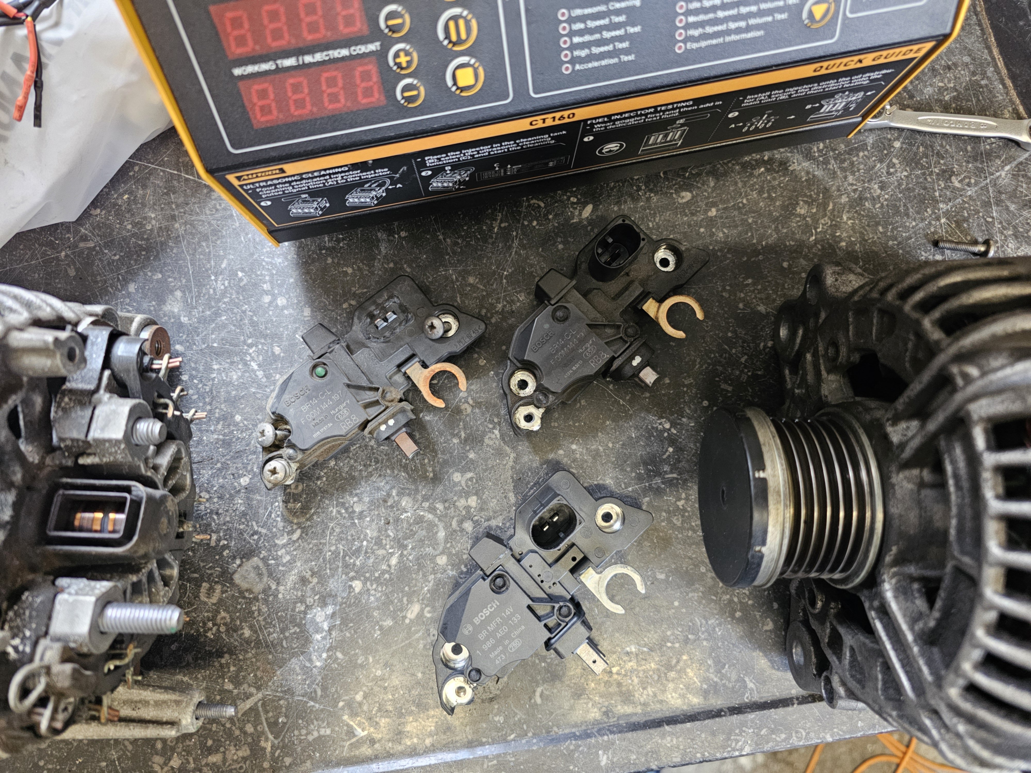

  14. Coincidentally, i had to swap out the rectifier on the Fabia 2 weekends ago. 13.1V output with all accesoires turned on. Replaced then original one with a scrapyard one (snapped off connector) and ordered a new rectifier so it's a cheaper long term solution instead of buying a new one. Hope you get the Roomster running under it's own power again.
