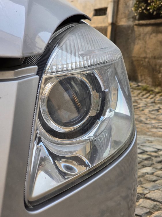

I know I'm bumping an old thread but I couldn't find the right answer. I have Skoda Fabia mk2 2009, the the BENDING BI HALOGEN headlight in the picture bellow.
What's the consensus, will a quality H7 LED (NIGHT BREAKER H7-LED GEN2) work plug and play, as in will the projector focus the light correctly and the main dipped and full beams work, or will it not?

As far as I can tell (I havent fitted these to my car so pinch of salt) if you are using gen 1 / original osram LED you need this adaptor for the projector light on a mk2:
OSRAM 64210DA01 LEDriving Adapter for Night Breaker H7 LED; Lamp Holder, Silver : Amazon.de: Automotive
Link to german amazon as you cant seem to find them here.
part number is 64210da01
If you are using the new gen / gen 2 which is the thinner body of LED I think you use:
OSRAM LEDriving Adapter 64210DA01-1 Adapter for Night Breaker H7 LED; Lamp Holder, Silver : Amazon.de: Automotive
which is part number 64210DA01-1
Id love to let you know how they work but ive ordered 64210DA01-1 by mistake! Ha )
