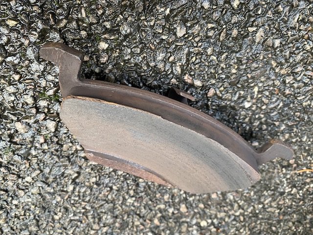

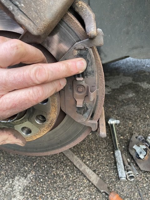

The check engine light kept coming back with the glowplug #4 error so I invested in a set of new Bosch plugs. Fitted without incident on Saturday (done hot) and the light has stayed off since. Smoother when cold too. Old plugs measured from 1 - 4 @ 2.6, 1.2, 1.4 & 16 ohms respectively. So 4 was indeed shot and the others getting weary also. Original Beru /VAG came out and I guess 114k is a decent innings. Also discovered that the reason for an increasing pull to the left under harder braking was caused by this…. ….incorrectly located pad…..😳 Resulting in the need for new pads 🙁 Disappointing as they were almost new. (Disc will go again though). Shows a disturbing lack of competence at the garage where the work was done. Appears to have been MoT’d like this. Also Bluetooth module acquired and cable & microphone ordered. Done about 1400 miles in it now and generally pretty pleased with it. Son has just got himself a 2014 Mk3 estate, also 1.6TDI on 140k.
