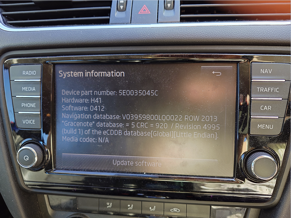

  2. I have the same part number: 5E0035045C @pab567 I can't PM you as not enough posts yet, are you able to PM me for VIN as i'm keen to get carplay into the car and OEM seems like a better bet than the aftermarket Aliexpress units. Thanks!

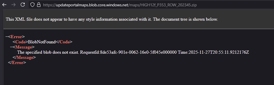

  3. Ok, I made a frankenstein url which seems to work.. Take the bold part of each.. Working BT File: https://infotainment-cdn.skoda-auto.com/base/firmwares/MIB_High_%20BT_%20parrot_update_3_73_0.zip Not-working Maps file: https://updateportalmaps.blob.core.windows.net/maps/HIGH12f_P353_ROW_202345.zip Join them together: https://infotainment-cdn.skoda-auto.com/base/maps/HIGH12f_P353_ROW_202345.zip And its going.. slow (<2MB/s), but going!
  4. hmm.. looking at the error screenshot above, the maps update points at "windows.net" domain. The bluetooth file link goes here: https://infotainment-cdn.skoda-auto.com/base/firmwares/MIB_High_%20BT_%20parrot_update_3_73_0.zip Which is skoda-auto.com
  5. Oh, here's the unit's info.. we're in Sydney Australia btw.

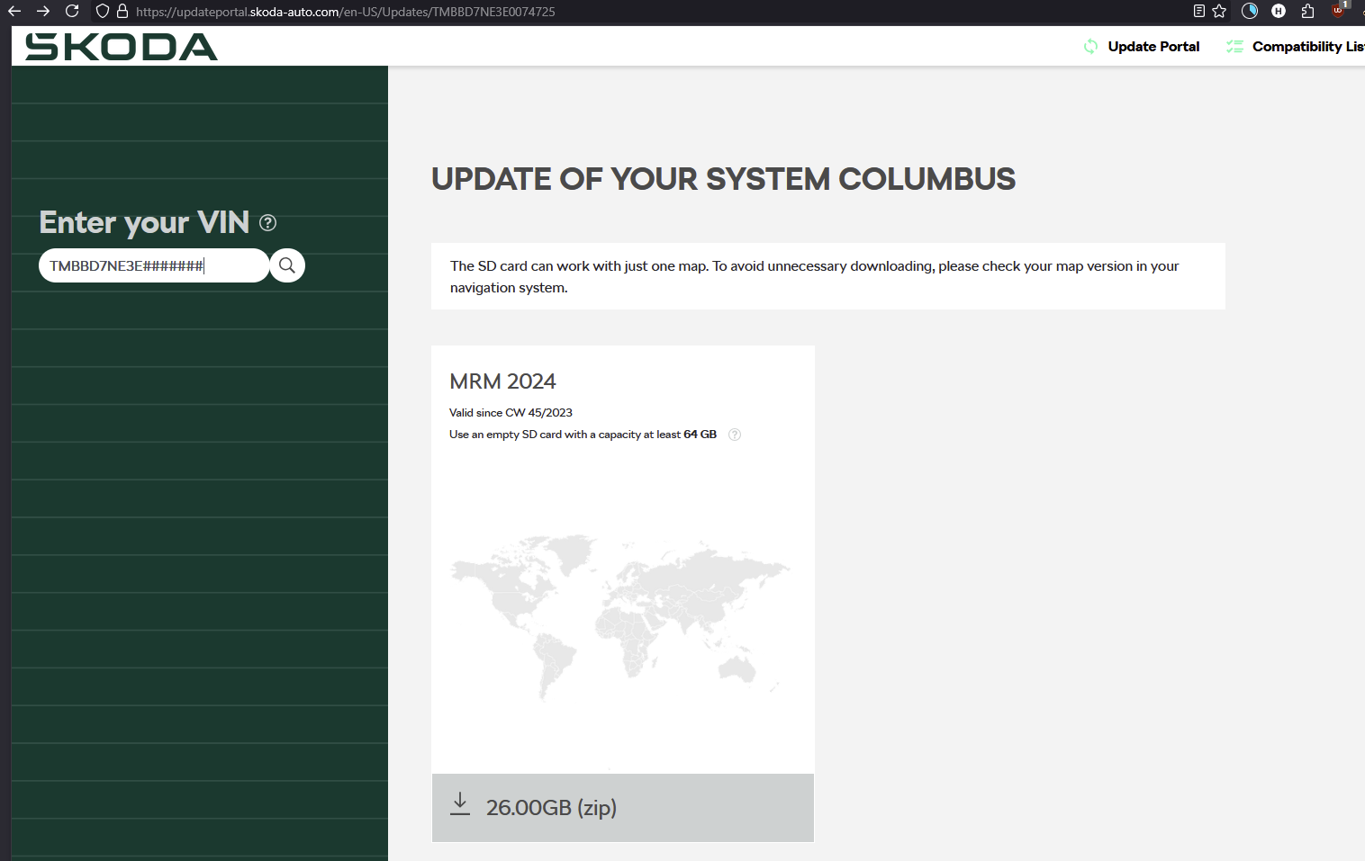

  6. My daughter recently acquired an early Octavia Mk3 as her first car. Careful elderly lady driver, good service history etc. etc. The infotainment system in it still has maps from 2013! When I go to the update portal and search, it shows maps for 2024 which is great. but.. Clicking the link gives an XML error.. is this a me problem, or a portal problem? I don't think its me, as the Bluetooth file downloads. And the 26GB link gives:
