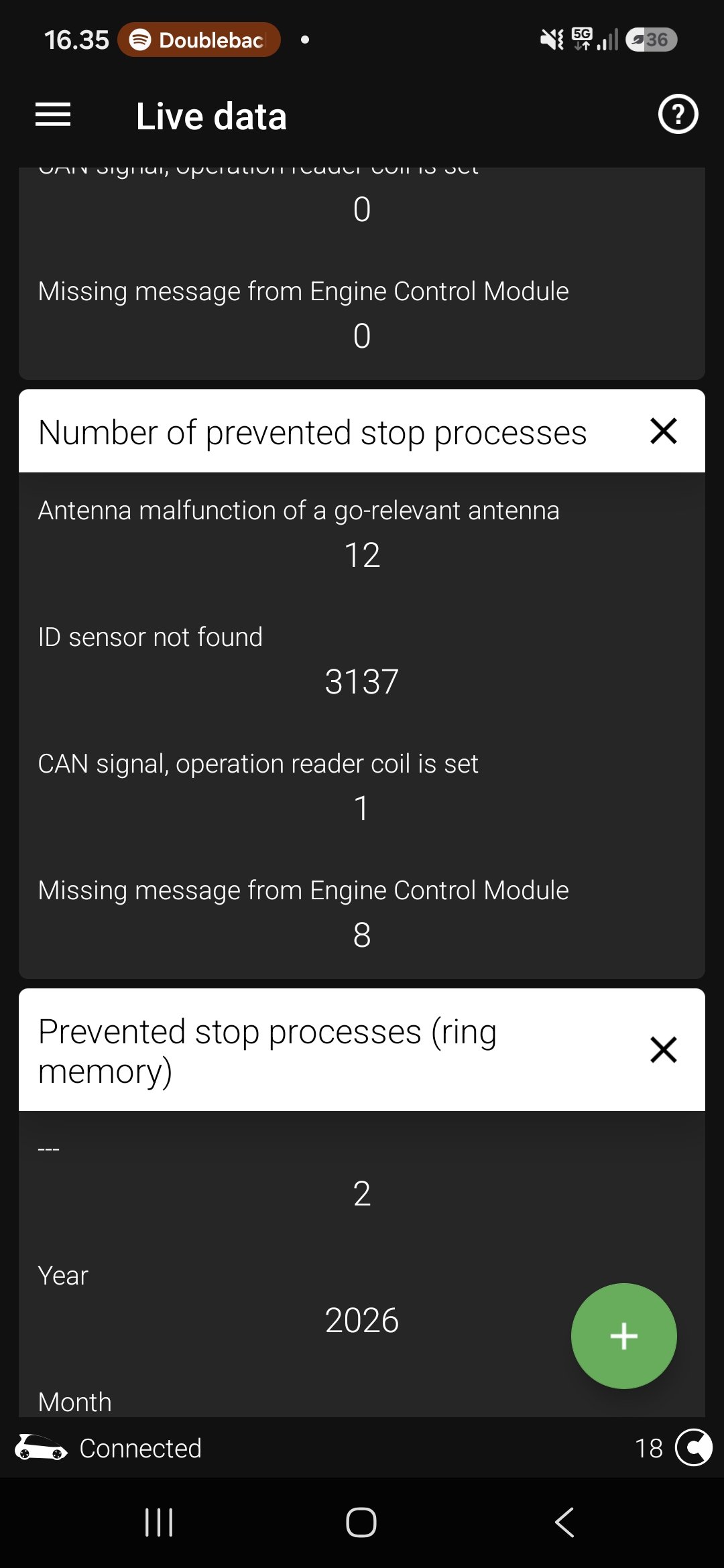

Hello, my infortqinment screen shows sometimes that 12v battery low. I just changed new battery and battery control module which is in ground cable. Also kessy not working and soc shows 0% Then if i open the driver door and close it, then kessy is working and soc shows 90% Is is possible that driver door wiring is broken or something. There is pics what are the only trouble codes
