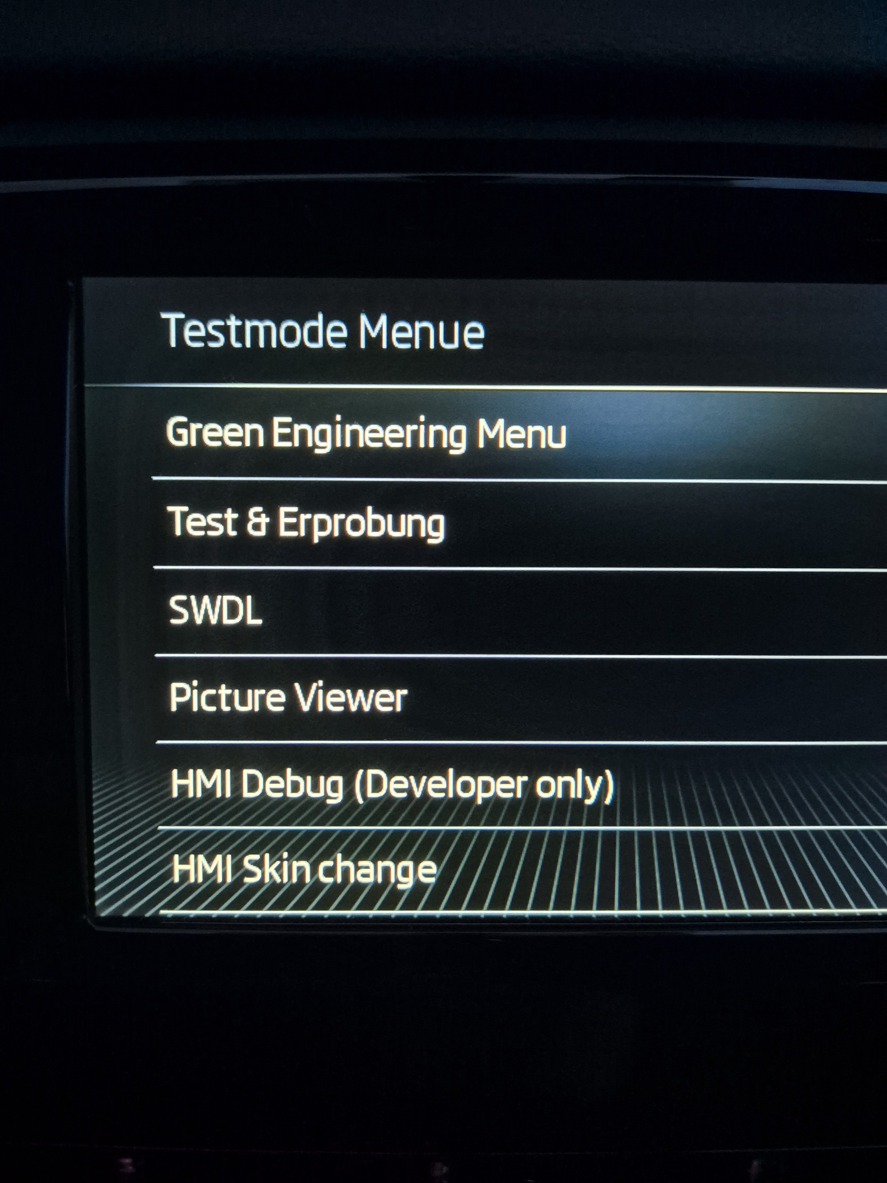

  3. Hi, I have a question about the infotainment car picture. Can the pictures be added ? When I try to change the car using OBD11, there are only two car models / pictures, Octavia 3 FL Hatchback and combi, none of the other bytes do anything, it either stays as O3 FL hatch, or the picture disappears entirely. is there any way to add the pictures, so that I could change it to my O3 hatch non FL ? FW - 480 -- https://mibsolution.one/#/1/9/MST2%20-%20TechniSat%20Preh/Firmware/SKODA_ZR/EU With Green menu unlocked - mib-std2-pq-zr-toolbox

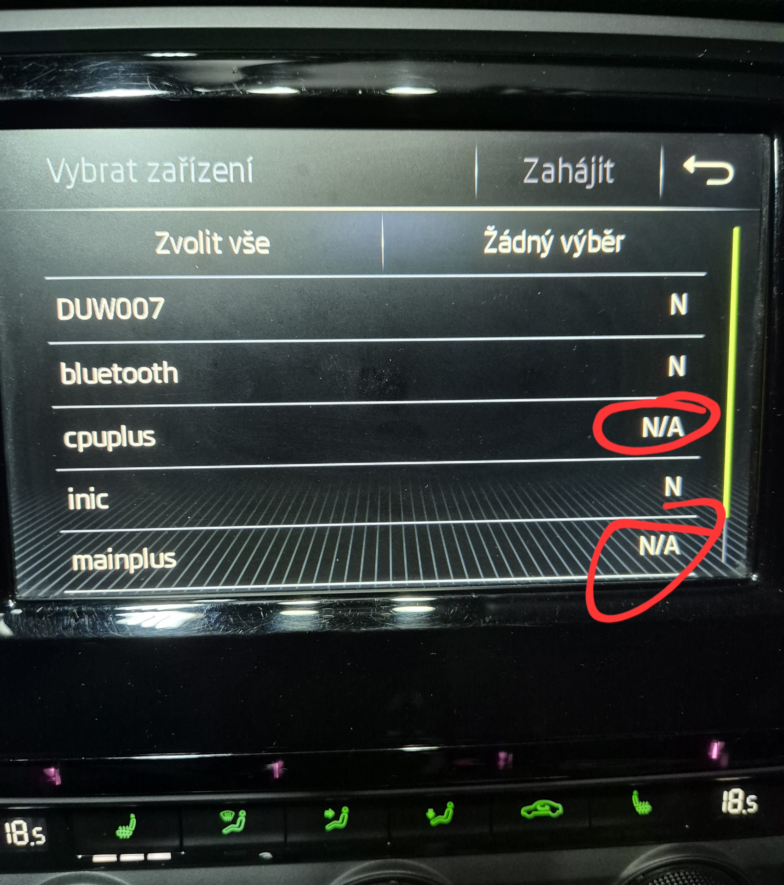

  5. The weird part is, that even android Auto connected and everything, just cannot hear the sound or do anything

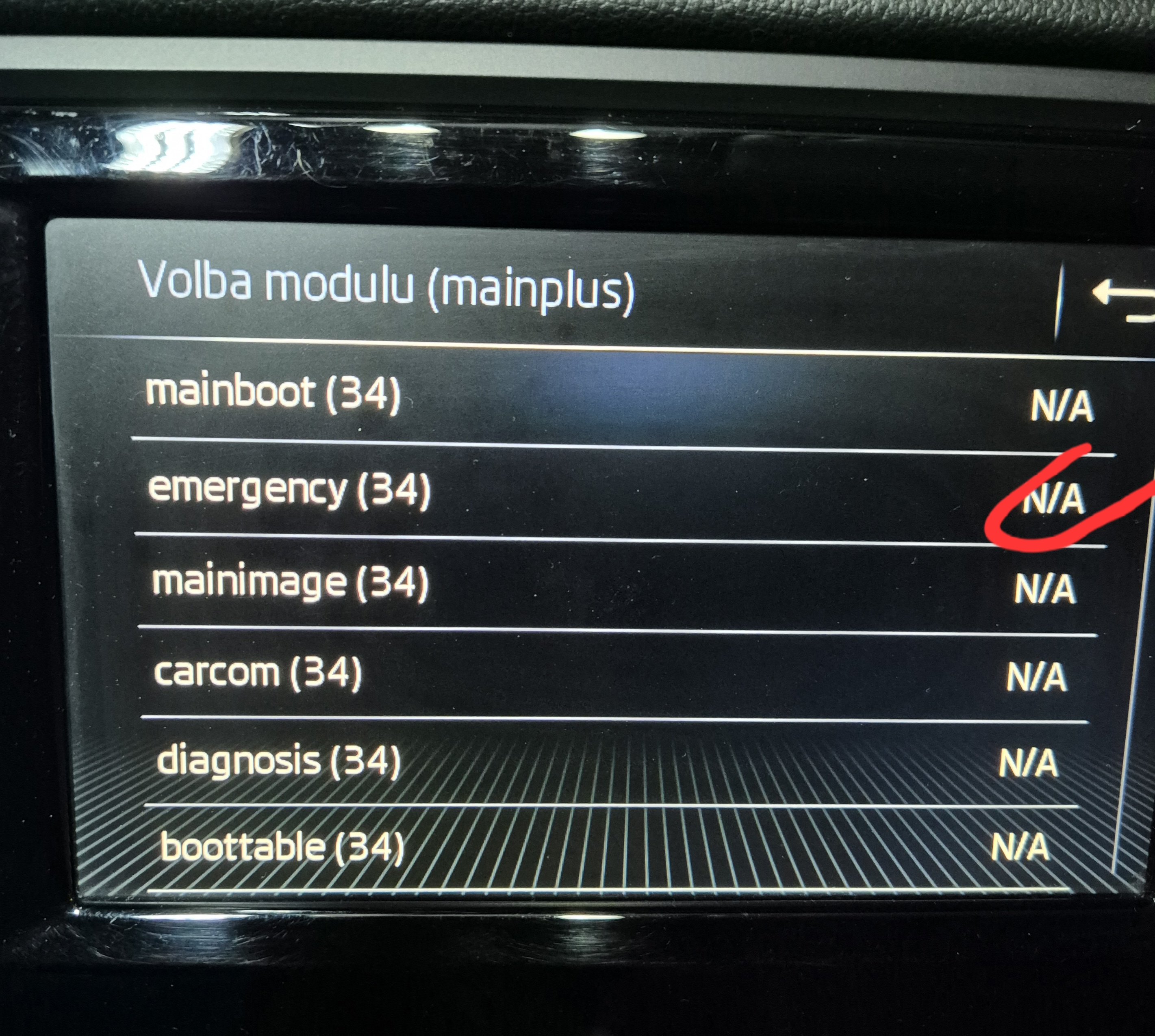

  6. Looks like this, but I cannot unselect the 3 mentioned, they are still N/A
  7. My unfortunately says N/A , is it correct ? (Can't unselect it )

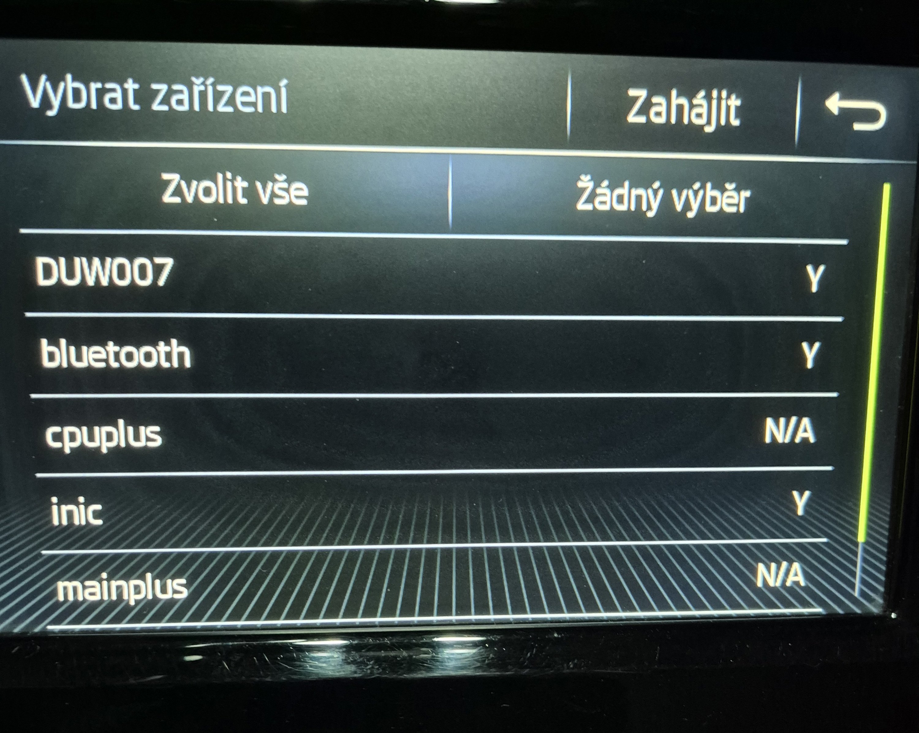

  8. Yes, it unfolds into the update menu I photographed

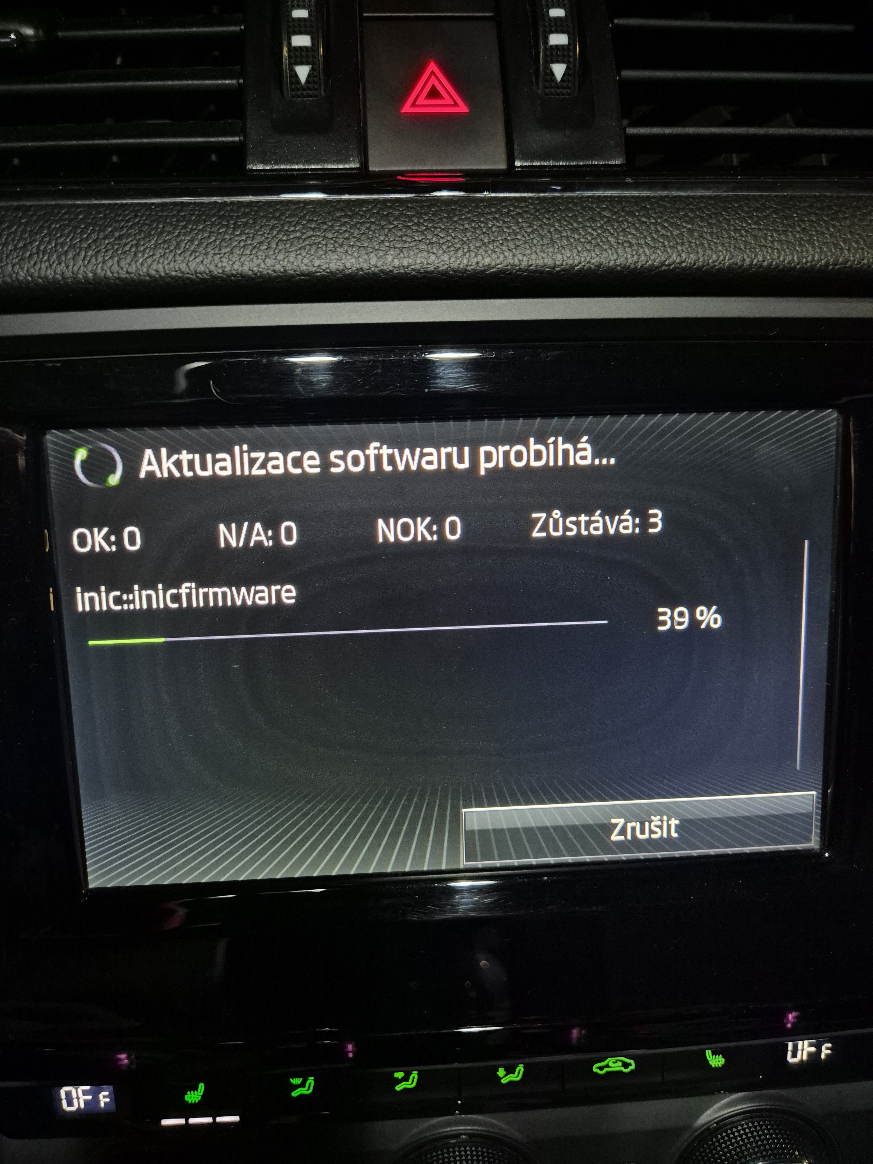

  9. Should I update it ? For me it seems weird, that the main modules have N/A

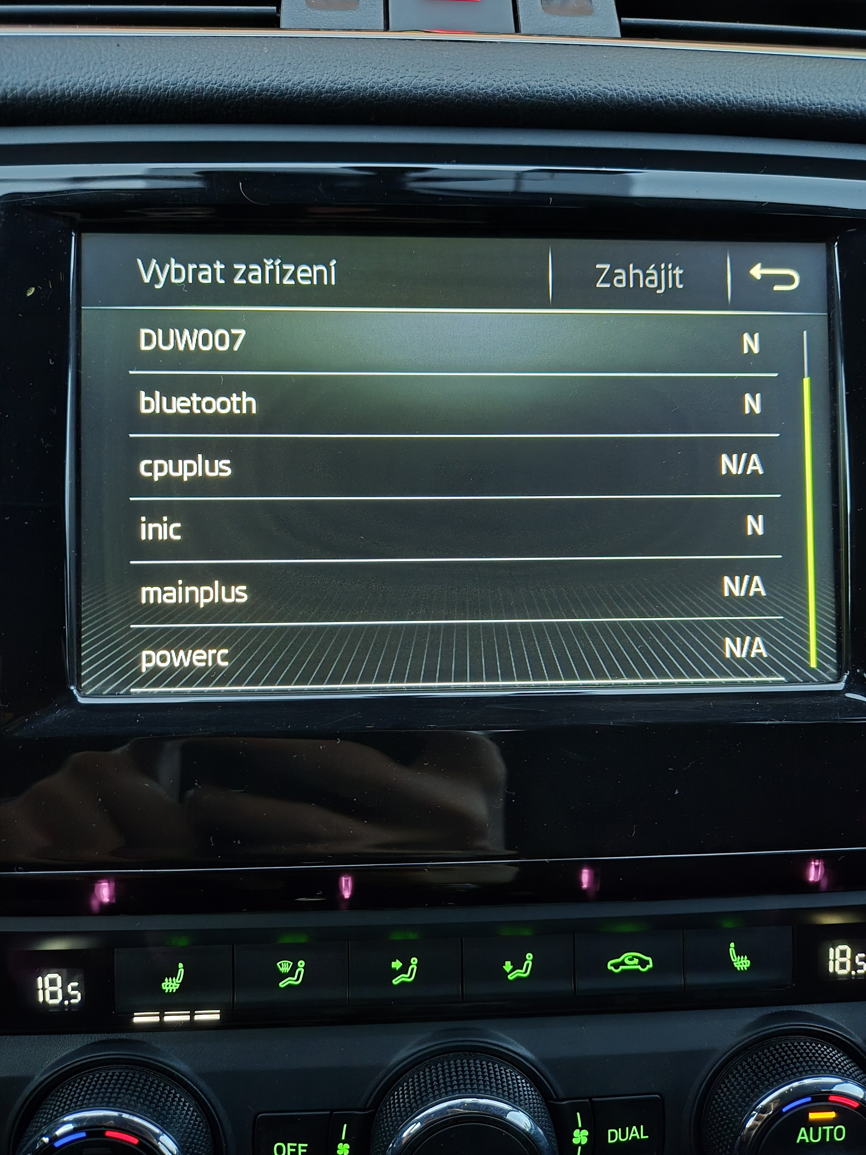

  10. It's this one Or do you mean the green one ?
  11. This is the update menu Should I uncheck something ? There are a lot of N/A
