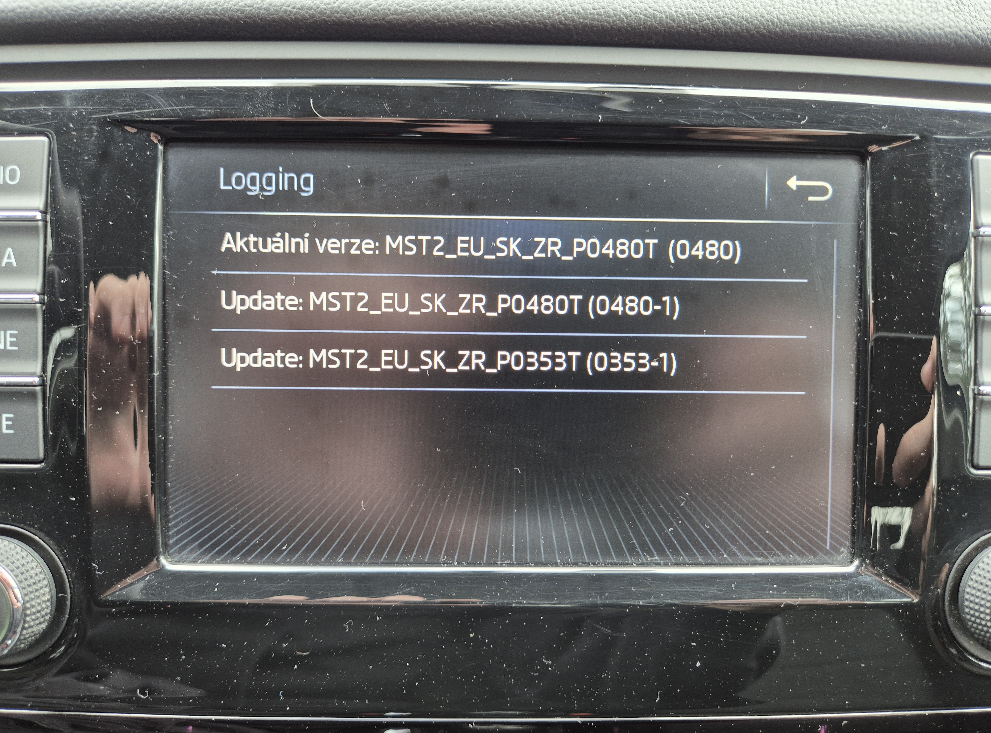

  8. Yes, it unfolds into the update menu I photographed
  9. Should I update it ? For me it seems weird, that the main modules have N/A
  10. It's this one Or do you mean the green one ?
  11. This is the update menu Should I uncheck something ? There are a lot of N/A

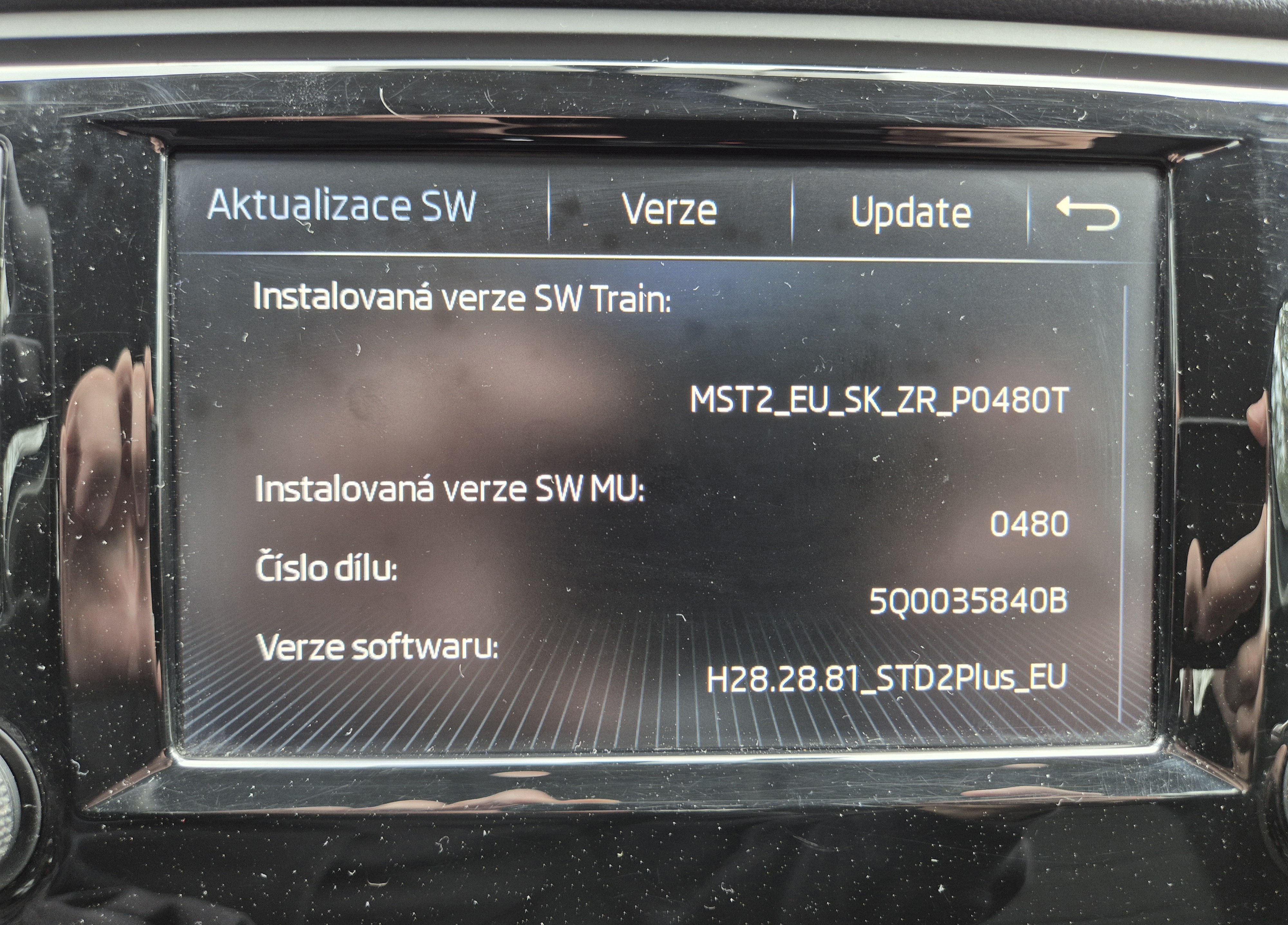

  12. Installed it from here https://mibsolution.one/#/1/9/MST2%20-%20TechniSat%20Preh/Firmware/SKODA_ZR/EU
  13. Yes, but I don't know it it was the right firmware, installed one from mibsolutions but I don't really understand the filing there, so I hope that it was the right one

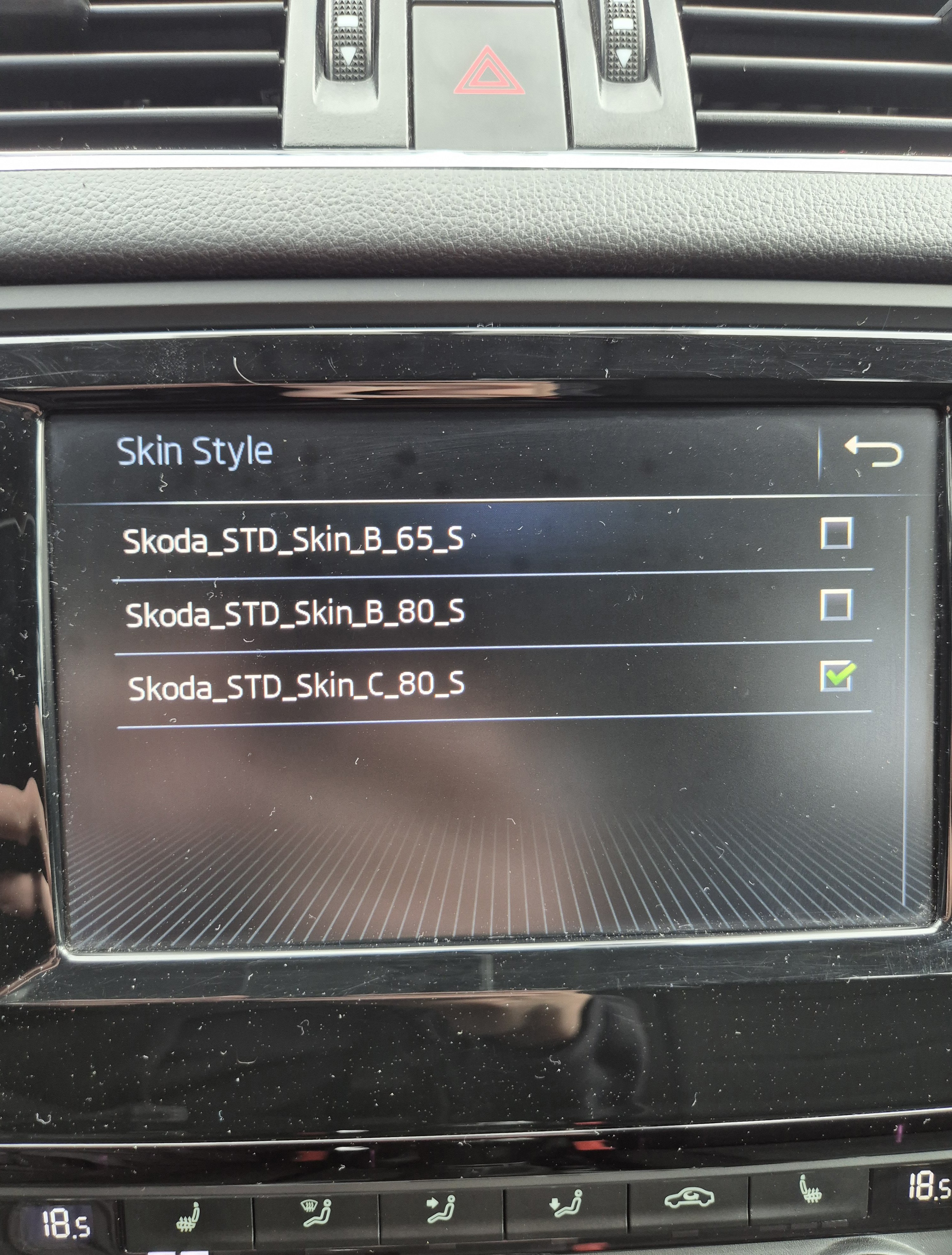

  15. This is the skin selection Tried all of them, none of them prevent the issue
