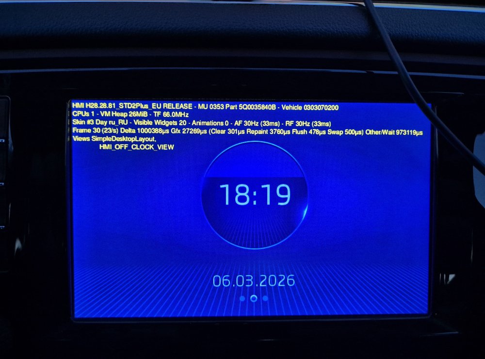

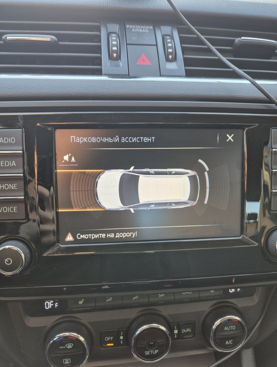

Hi, could anyone please help me with retrofitting, I did every step, from buying the MIB 2 unit and display, to flashing it with "mib-std2-pq-zr-toolbox" but when I turn the ignition on, the display turns on with standby clocks that I can scroll through (different faces ), but none of the buttons do anything (parking sensors normally show up),(by the blue dev screen on the photo below I know that they work even on this screen, they just don't do anything). But when I connect diagnostics, the screen flashes with standard interface for a moment and the turning back to clocks, then after choosing module 5F Multimedia, the screen comes alive, everything works, buttons, touch, with that I was able to change language from Russian, update the software and everything, but when I disconnect the diagnostics, it goes back to clocks.
The software is updated to version 480 (photo is before the update) but even then it is the same.

The unit is always on standby (the clocks), and no matter what I press, it doesn't react, but when I plug in an OBD11 and go to 5F, it comes alive and works like it should tomorrow I will check if it at least reacts to holding the power button in that state

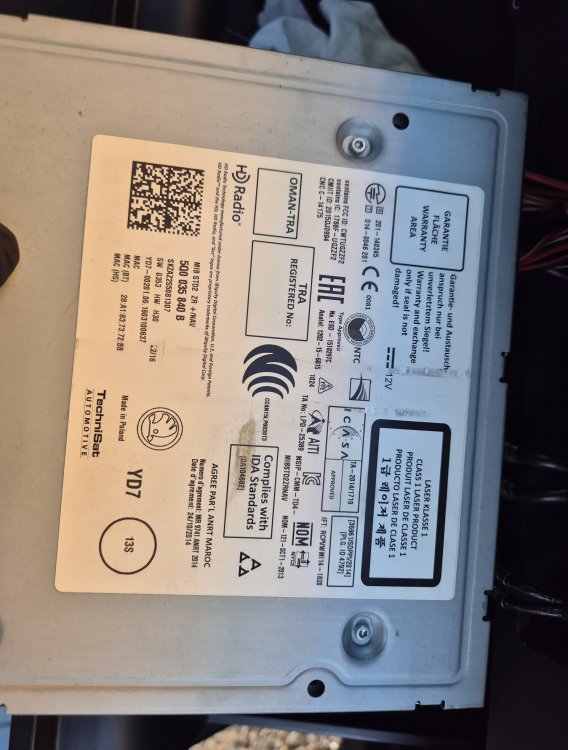

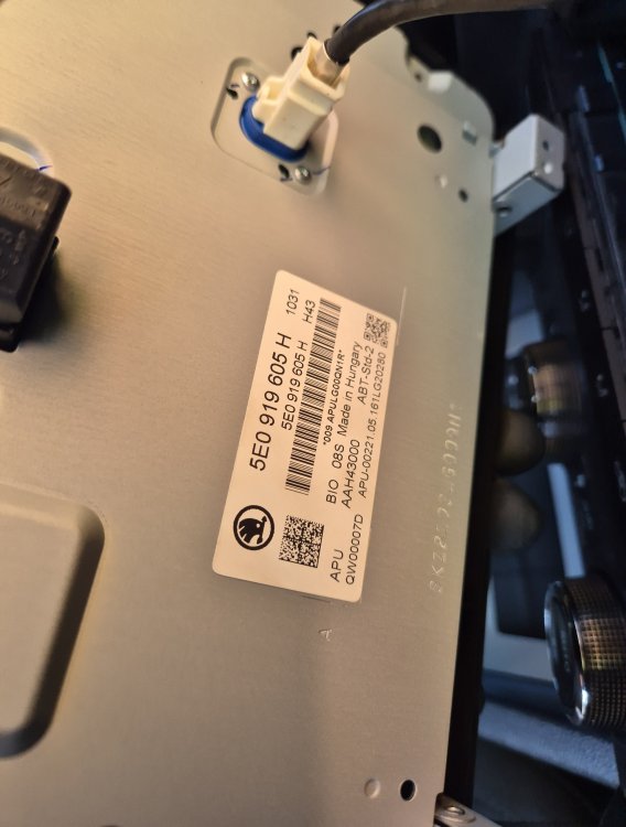

The part number
Display: 5E0 919 605 H
Unit: 5Q0 035 840 B
Yes, I flashed it with toolbox master and this software MST2_EU_SK_ZR_P0480T

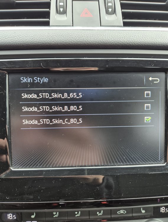

1) Check im Service Menü "HMI Skin Change" what is there aktiv?

Which Mode have HMI Skin?
This is the skin selection
Tried all of them, none of them prevent the issue
Correct is 65skin
