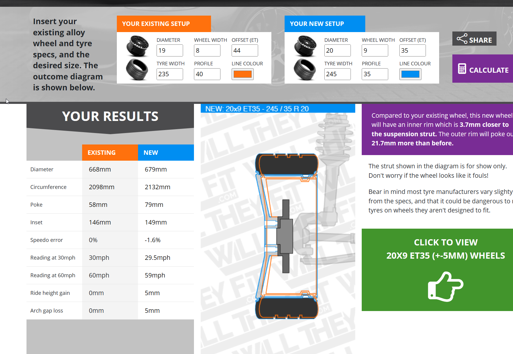

  8. Below is a comparison of 20×9 ET35 with 245/35 against the stock setup. However, below are all the wheel specifications I can run, regardless of whether they are Performance, Mid, or Deep concave. Which combination would you choose? To be honest, I prefer a sporty look—I don’t like tires with a very tall sidewall. On the other hand, I’ve seen setups like 235/40 R19 where the sidewall looked huge… but I believe that also depends on the wheel width, right? 19×8 ET36/40 – 225/40, 235/40, 245/35, 245/40 19×8.5 ET35 – 225/40, 235/40, 245/35, 245/40, 255/35 ET45 – 225/40 19×9 ET40 – 225/40, 235/40 19×9.5 ET35 – 235/40 20×8 ET36 – 235/35, 245/35 20×8.5 ET35 – 235/35, 245/35, 255/30 ET45 – 235/35 20×9 ET35 – 235/35, 245/35
  9. Good day, group members, I need some advice. I’m planning to purchase new rims for my Škoda Superb 2017 Sportline. I’ve decided on CVR1 rims, which I really like, but I’m unsure about the best size and tire setup. What I’m aiming for is a MID to DEEP concave look with a sporty appearance. Here are the TÜV-approved options available for my car: Option 1 – 20” (MID Concave) • 20x9 • Tires: 235/35 or 245/35 • Concave: MID Option 2 – 19” (DEEP Concave) • 19x9 • Tires: 225/40 or 235/40 • Concave: DEEP After some research, my current preference is 20x9 MID concave, but I’m unsure about the tire size. I’m leaning towards 245/35 mainly for better rim protection, but I’m not 100% certain if that’s the best choice for the Superb. I’m aware there’s also a Performance concave option, but it doesn’t give the visual depth I’m looking for. While it offers more sizing options, I’d prefer to avoid the Performance concave if possible, as the concave look is important to me. My main goal is visual impact and a sporty look, not track performance. Currently, I’m running stock VEGA R19 wheels for summer, but they’re scratched and damaged, so they need replacing anyway. Tires will be Michelin or Continental. I’d really appreciate your opinions on: 19” vs 20” for the Superb Best tire size for rim protection and stance What setup looks best without ruining comfort too much Any suggestions are welcome. Thanks in advance! 🙌
