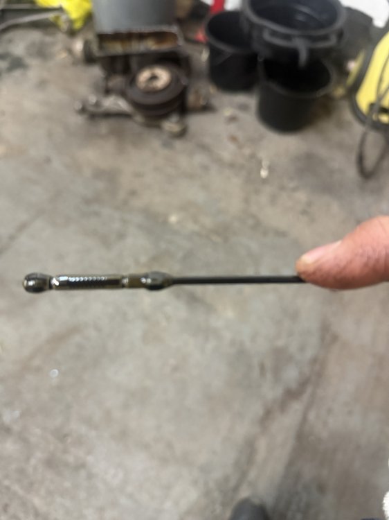

So after we towed the car back to my mates unit I checked levels properly.
Turns out it’s way higher than I or the garage noticed it seems (see pic, it’s up
to my finger).
Could this be the cause and my turbo may be ok after all??

From a problem solving perspective I would do this - and nothing else - before testing the car again. If you 'fix' allsorts and the car works OK you will not be able to identify the original problem uniquely.
If the oil level is upto your finger thats very high. Its either been overfilled by a lot or something is raising the level. If it was water it would be emulsified so wonder if diesels getting in somewhere which would make oil very thin and explain the run on.
It is the correct dip stick?

Well after realising the oil level was high, last night I dumped all the oil out to see how much by!
To my surprise there was about 8.5 litres in there!! That’s about double!! 😮.
It also smelt of diesel and was thin like water so likely cause would be long term failed Regens by driving lots of short journeys. Yes it could be a failed injector but it still drive really smoothly so is looking less likely.
I also had all the turbo pipes off and drained the small amount of oil in the intercooler as best as I could.
I did find that the oil starts in the system from the crank case breather, which is BEFORE the turbo, so is now looking less likely the turbo seals are at fault 🤞.
