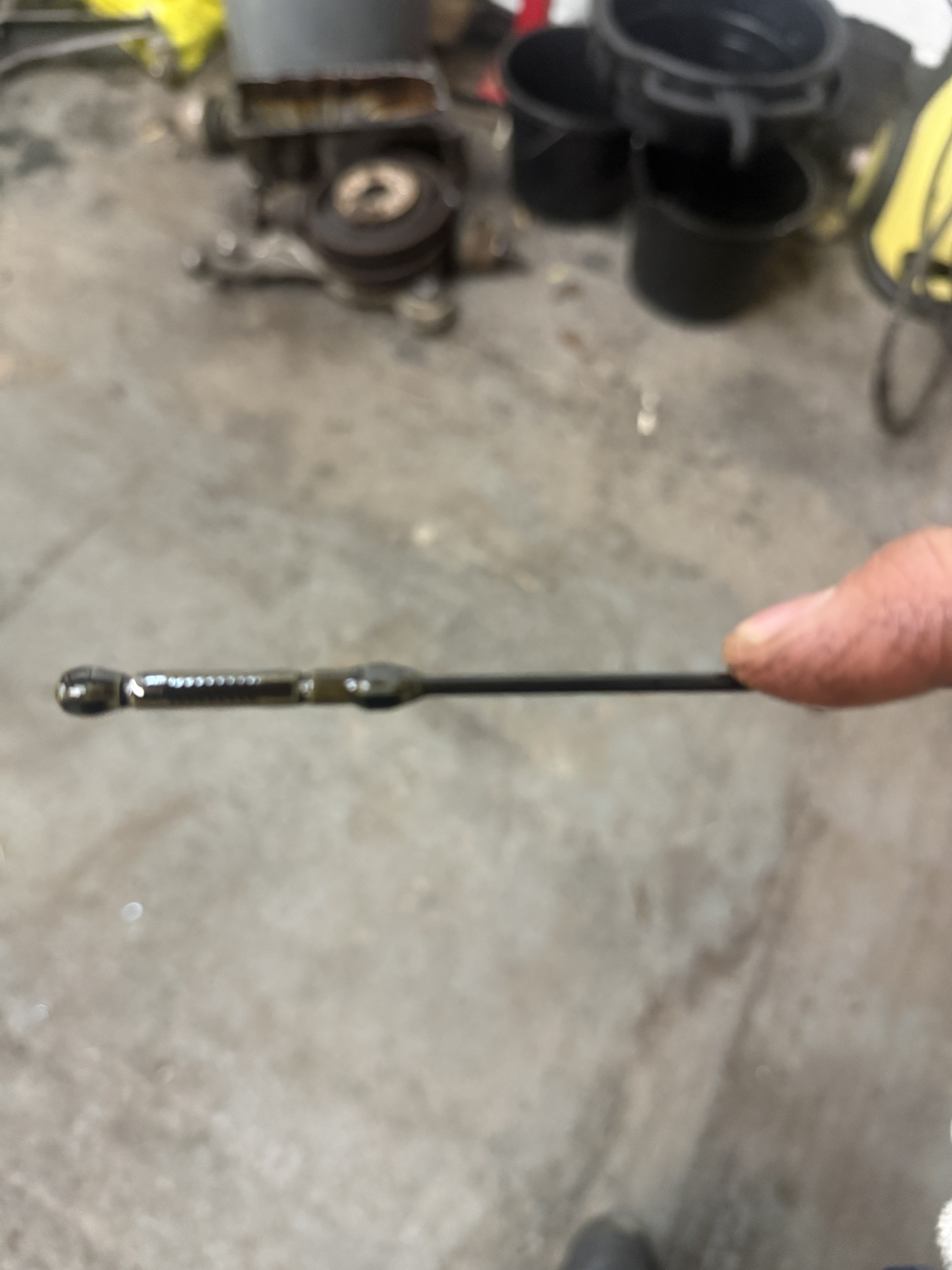

Hi me again 👋 This follows on from my earlier post about a possible blown turbo oil seal on my 1.6tdi. When I went to collect the car from the garage this evening where it was going to be MOTed, but they ended up looking for the cause of the runaway, they said it’s definitely the turbo failed as there was lots of oil in the intake, BUT the oil level was also high (they said 1cm too high). By chance I got chatting to a guy outside who turns out to be a VAG specialist and told him about my runaway issue. He said it’s likely to be turbo seals BUT it could be the oil over full being sucked up through a breather into the intake. So after we towed the car back to my mates unit I checked levels properly. Turns out it’s way higher than I or the garage noticed it seems (see pic, it’s up to my finger). Could this be the cause and my turbo may be ok after all?? Current symptoms: There was never any smoke or loss of power prior to the engine runaway, It drove perfectly for 20 mins before the runaway occurred. The runaway occurred while I gave it a boot full while going up a hill, After the engine was shut down, I tried a start and it ran fine but did try and runaway again as there is obviously still oil in the system. The garage had the car idling during the day with no issues or any smoke. They did not rev it! When I collected the car at the end of the day I did have to start it and drive it to turn it around before being towed across town. There was no issues or smoke at all. My next plan is to drain the oil to the correct level and clean out all the hoses going to the inlet. Probably check the intercooler too. Is there anything else I should check/clean? Thanks all, Fingers crossed 🤞
