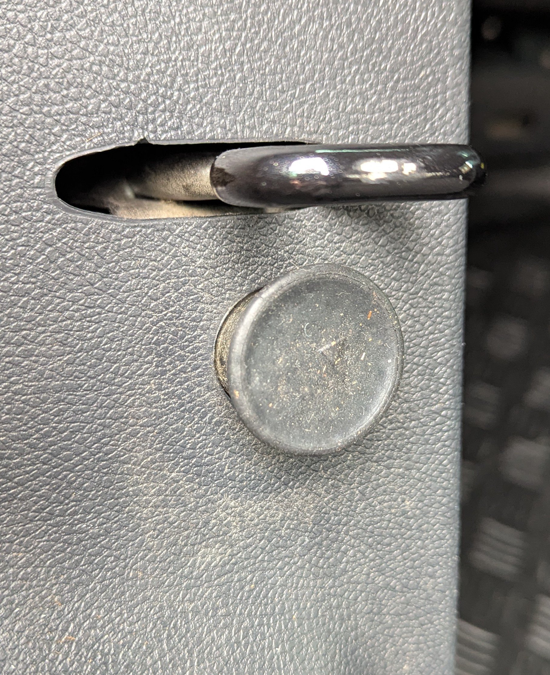

  2. I've recently purchased Fabia 2014 for my daughter and experienced the same noise. See my reply in this thread: https://www.briskoda.net/forums/topic/298881-rear-end-creaking/page/2/#findComment-6000325
  3. I've recently purchased Skoda Fabia 2014 for my daughter and experienced the same noise from the off side rear "suspension" (it wasn't the suspension in the end). A Google search brought me to this thread. The noise on her car was caused by this: "the clips that lock the rear seat back rests in place". However, I did not use insulation tape as there was a threaded grommet bump stop type thing below the bar/lock catch and this could be adjusted. I wound it right out to check but then put it back in. It only need a small 1/4 to 1/2 turn unwound to make a 'tighter' fit and the squeak has gone! See circular bung in the photo.
