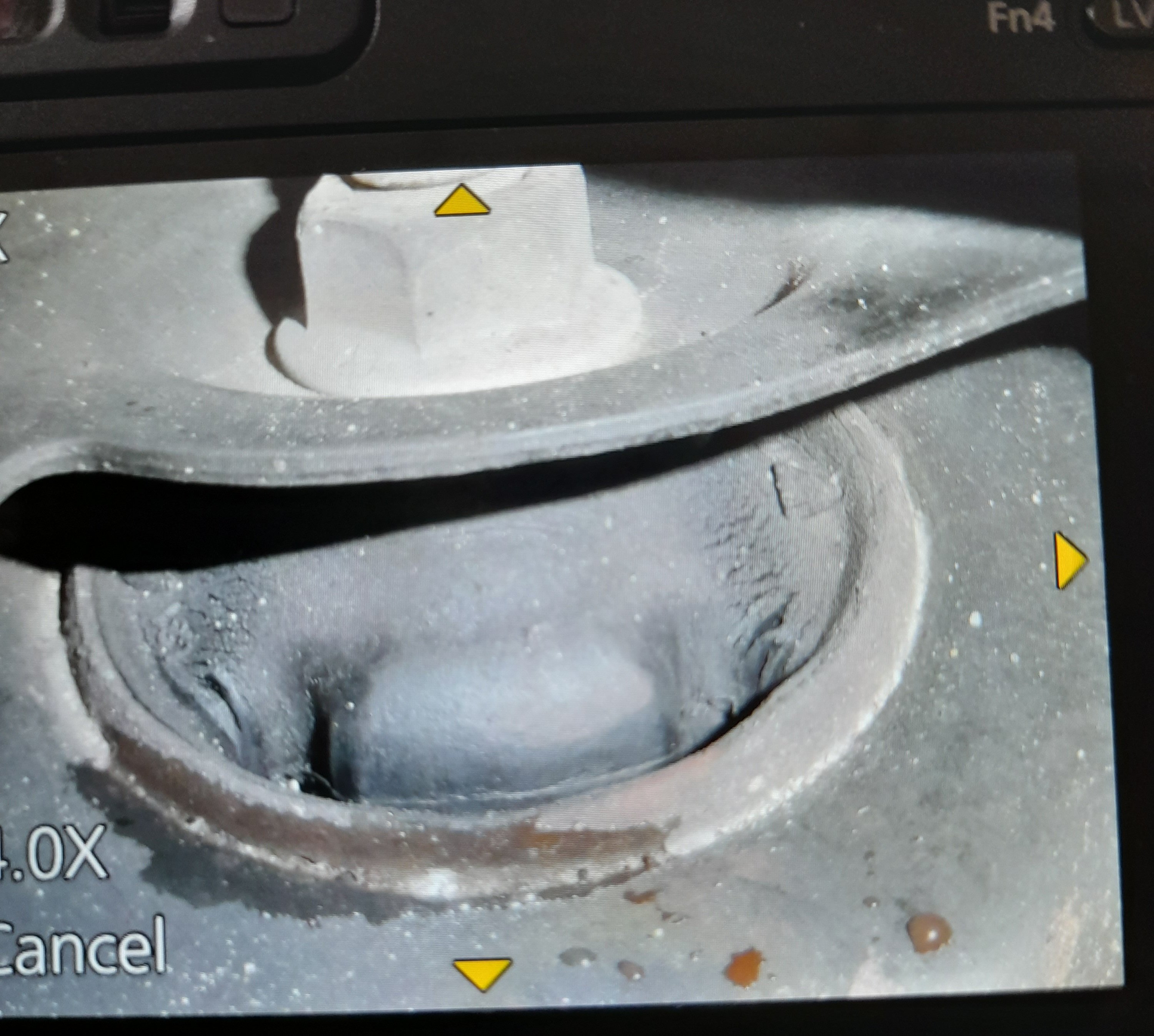

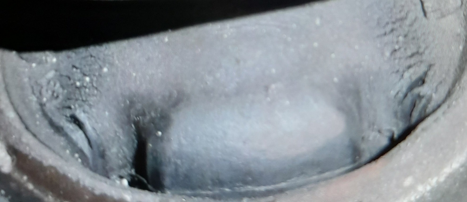

  9. Hi All, changed outer tie rod still squeaky ONLY over bumps also tried silicone spray on all bushes. With better light & further investigation I have supplied a photo of as far as I can tell the only sorry looking bit of rubber is the bush on the (wishbone) or lower arm. Would you say the wear in the photo is enough to give a squeak?
  10. So would you say I need tracking checked again? Because the outer tie rod nut was tightened much later after the wheel alignment? What? What?
  11. So would you say I need tracking checked again? Because the outer tie rod nut was tightened much later after the wheel alignment?
  12. Hi All, replaced tie end rod needed to work quickly & in the dark. Replaced tie end rod tightened it to 45nb tighten locknut on rod reassembled car. Had the tracking done (they said all is good) after this I torqued the tie end rod nut to the 50nb (manual said) I did it while the locknut is locked ( didn't see any reason to disturb it). I can't see a problem and the car drives straight. Is it a must that the locknut on the rod be tightened after the tie rod nut?🙂
