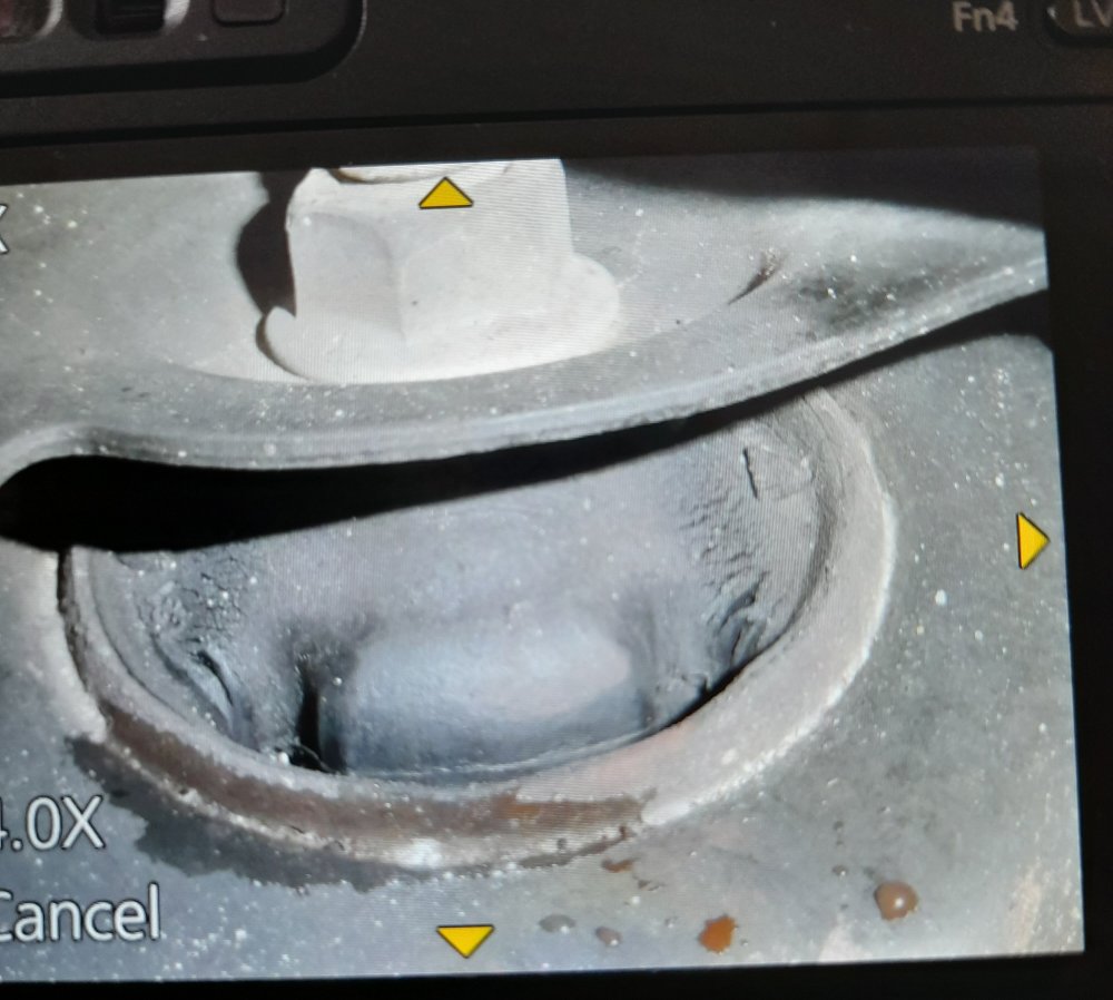

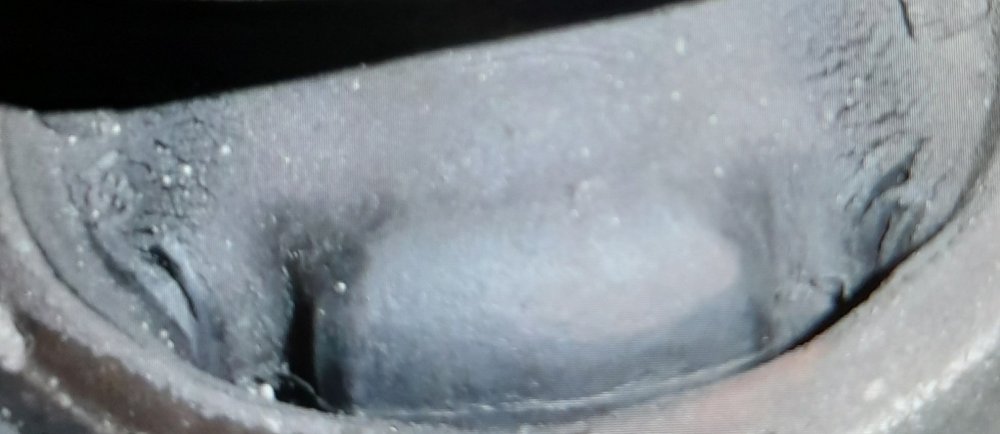

Hi All, changed outer tie rod still squeaky ONLY over bumps also tried silicone spray on all bushes. With better light & further investigation I have supplied a photo of as far as I can tell the only sorry looking bit of rubber is the bush on the (wishbone) or lower arm. Would you say the wear in the photo is enough to give a squeak?20240329_124849.thumb.jpg.e04feae0b2df97258debc9a52bee42a9.jpg
The photo shows what appears to be metal to metal contact, what more could you want to see?
Or am I mistaken?
Rubber to metal bonded bushes do not squeak unless mounting bolts are loose, metal to metal contact through excessive joint articulation is what squeaks.
Edited by J.R.
