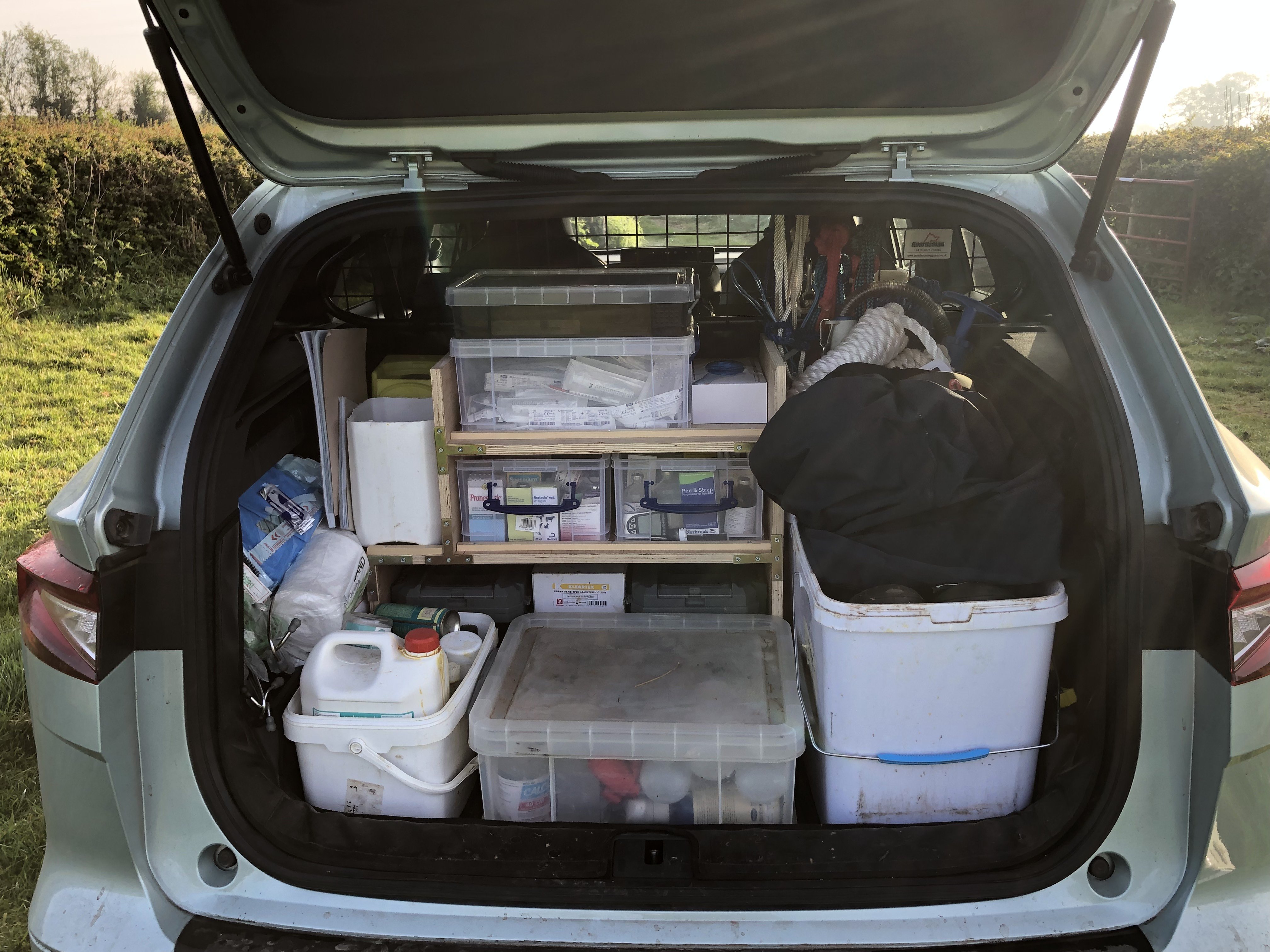

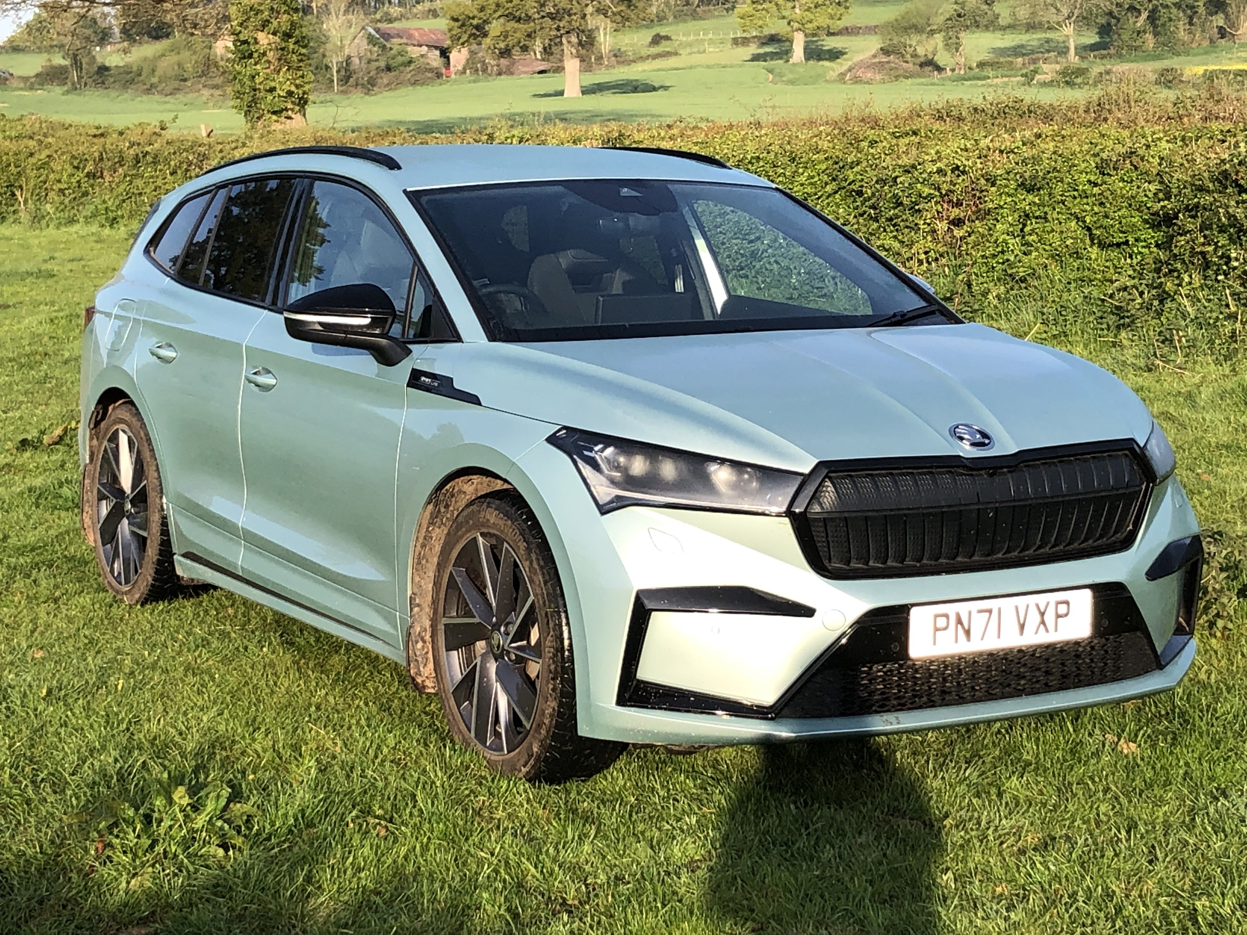

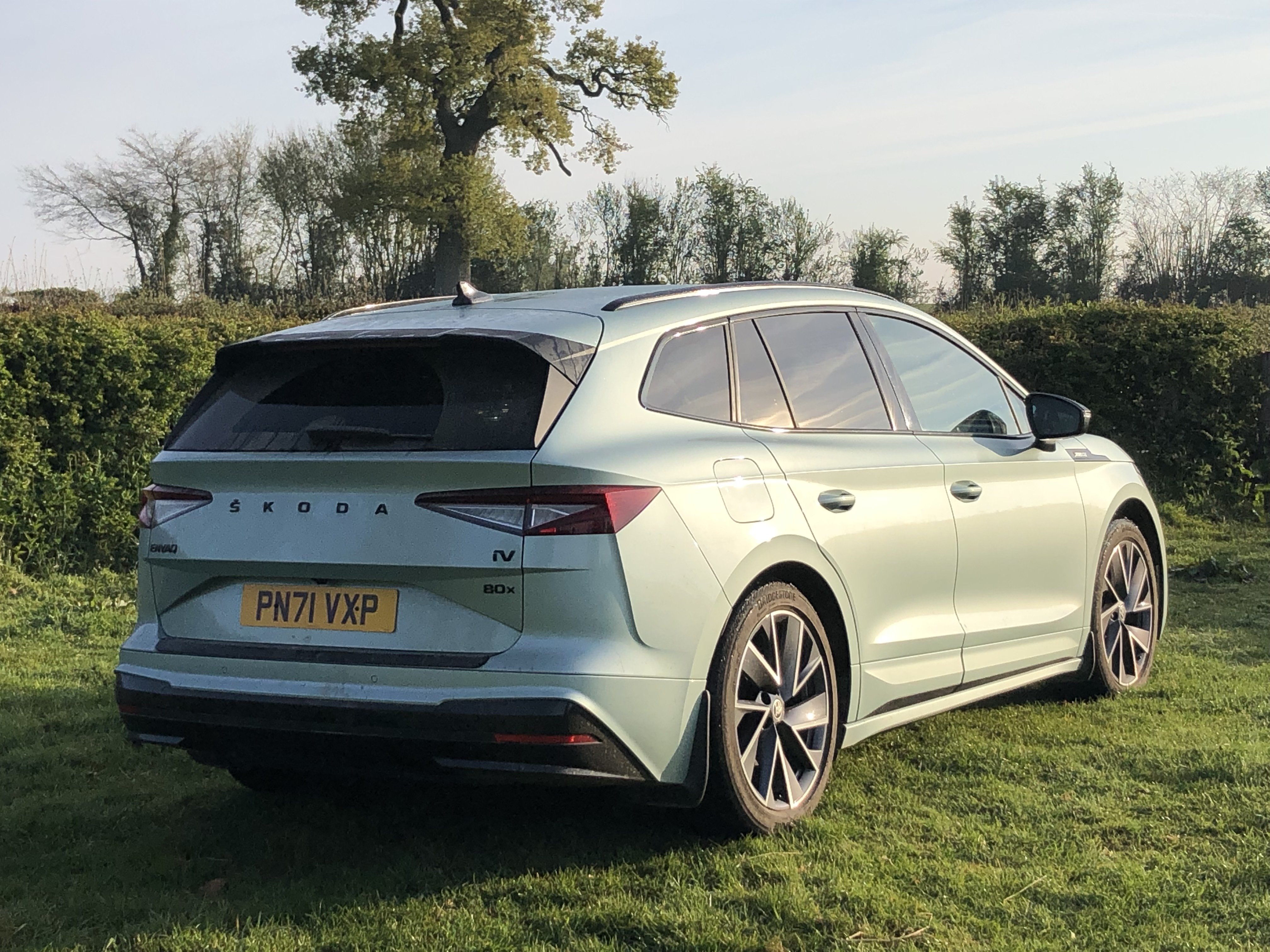

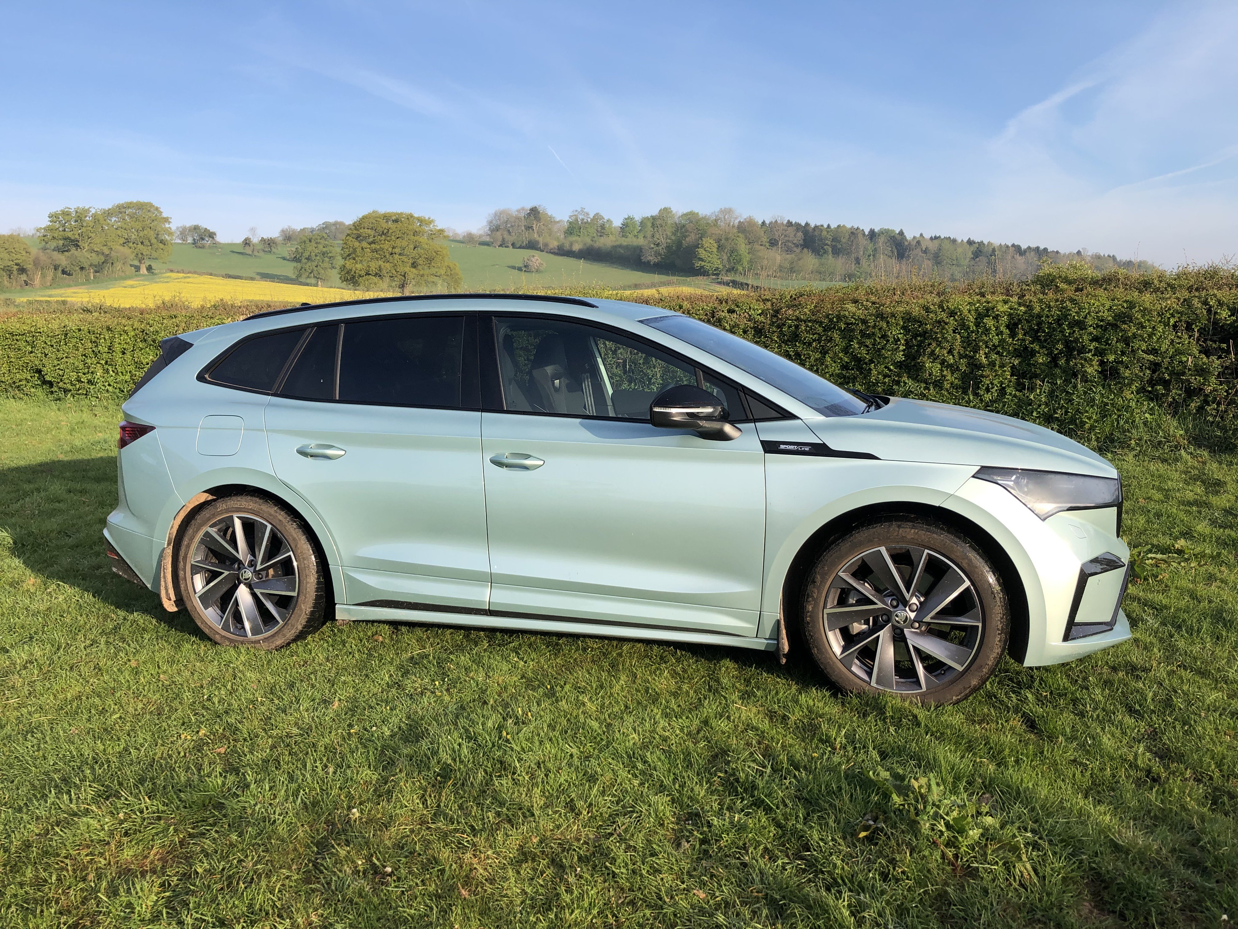

Hi all, Just wanted to share a few pics of my month-owned Enyaq 80x that I use for work. Being a farm vet's car, it's fully loaded in the boot with kit and has to navigate a lot of single-track roads and muddy/rocky farm tracks. It's been handling its duties very well and I've been very impressed with its off-road ability (at least equal to my previous Octavia Scout). Overnight charging gives me full range every morning and when on-call (and often driving / attending call all night) an hours break and a snooze at a 50kW charger (the fastest we have in Herefordshire) keeps plenty of range in the battery. I've also been relieved at how my farming clients have responded - the vast majority are fascinated and amazed that an EV can cope with the life of a vet's car!
