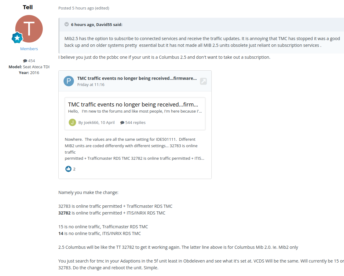

I read this and tried 14 again as per Tell's advice - success! https://www.briskoda.net/forums/topic/512443-tmc-traffic-events-no-longer-being-receivedfirmware-update-required/page/22/

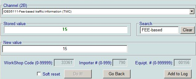

I spoke too soon. The Superb VCDS has a very different stored value, 15 rather than 32783 as the default. I tried 32782, 14 and 16, resetting the MIB in between - none of them worked, so I've given up for now. I did check that Android Auto will display Google Maps on the head unit if necessary. I also spotted after my post that this topic is being followed on another Briskoda thread. It's probably best to watch that one:

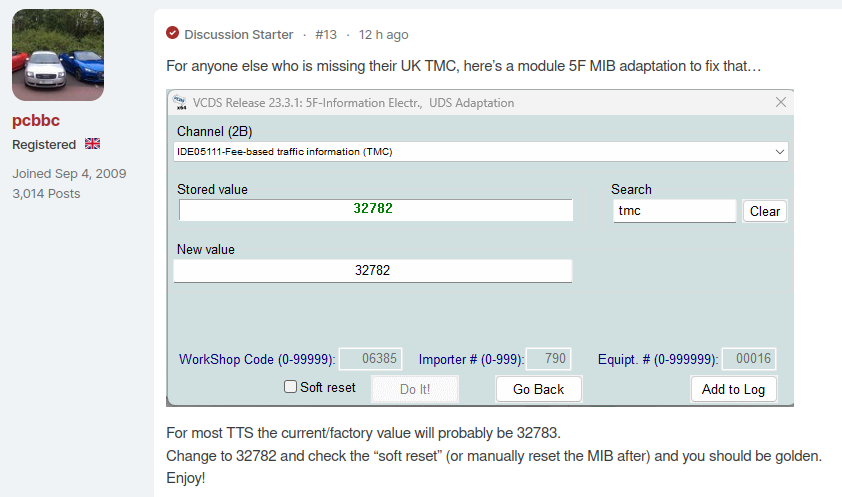

There's a post about this over in an Audi TT forum: https://www.ttforum.co.uk/threads/fixed-rds-tmc-no-longer-working-in-uk.2032197/#post-9622024 In summary, Trafficmaster supplied TMC, but they have stopped providing the service. It affects VW group and many other car manufacturers. However, if you have VCDS, there's a fix that work on the TTs. It enables the alternative VW Audi service instead. I haven't yet tried it on my Superb, but it uses the same maps and software so I expect it will work: As ever, pcbbc has found this. Top man!
