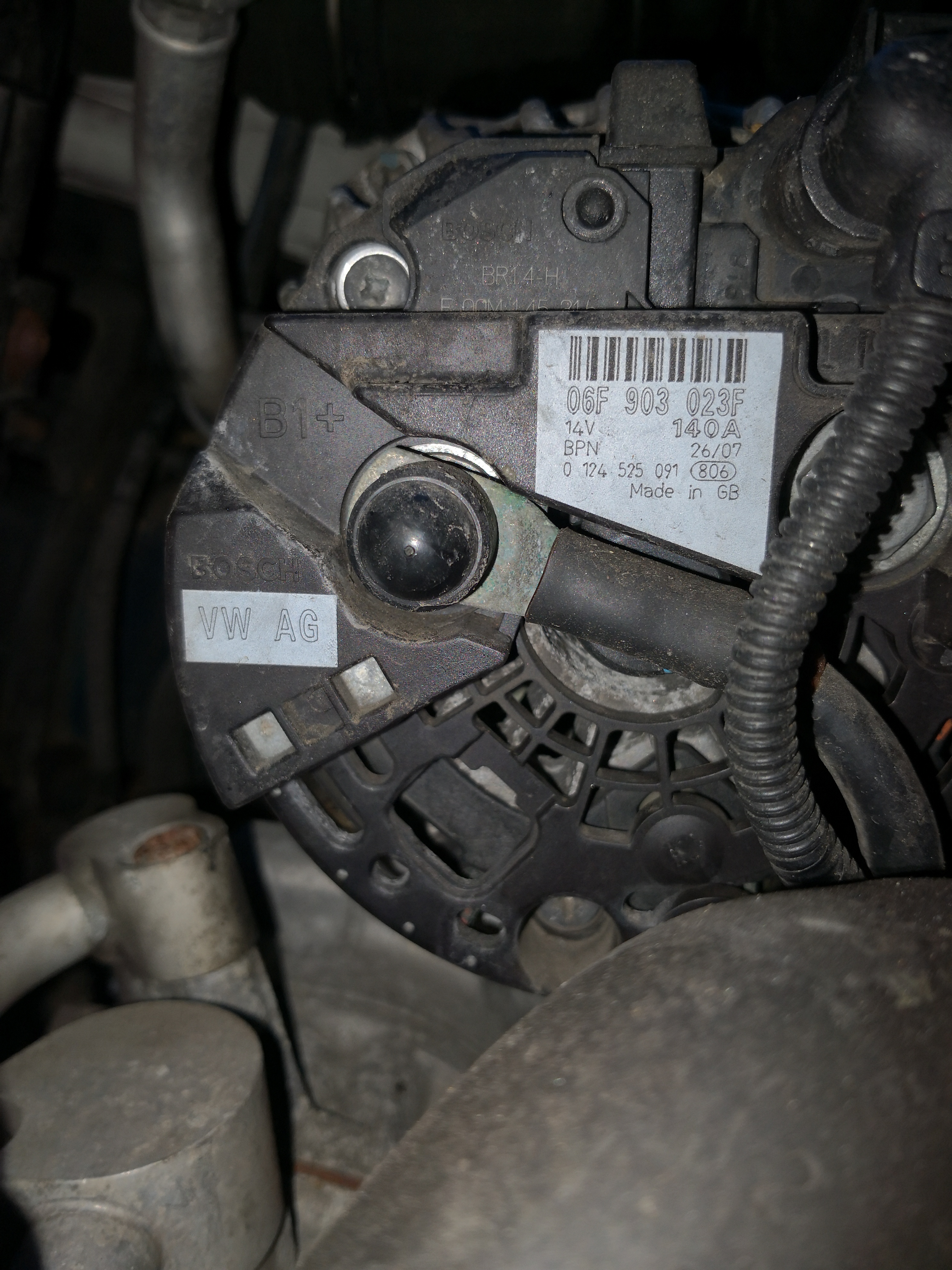

Hi Everyone, thanks and update: First, thanks to everyone who replied. As always with Briskoda, I learned a lot more than I expected, and I was once again struck by the helpful, well-informed and friendly tone of the discussion. Second, update. I wanted to do the job myself but ran out of time, needing the car at short notice over Christmas. So instead of spending twenty-odd quid on a new regulator, I had to spend £290 😥 on getting a new alternator fitted. Bloody Norah. But now I know better for next time...assuming I ever own an IC-engined car again. Thanks once again for your input. Kind regards, scandalxk -

Thanks. Understand now re. part numbers...probably. Yes, that "Made in GB" caught my eye too, but only because it is unexpected. I assume this means it is likely to be a replacement part? Surprising, because I have had the car since it had done 39,000 miles so it must have been replaced before then. And yes, that power cable is too thick to be cavalier with! Ah, just read @krisp1's post above...perhaps it could be an original part. -

Sure, but they are also available as independent brush sets. -

OK, so are you thinking I could replace just the regulator, and not have to faff about soldering new brushes into the existing regulator? That hadn't occurred to me. Google tells me the part would be around £22. Is it likely I'd be able to do that without removing the alternator from the car? And, further stupid question: what do you mean by "genuine part number" for the regulator? Surely that would be the same as the Bosch part number, given that it is to fit a Bosch alternator? -

OK, I decided as the battery is six years old I would change it anyway, and see what happened. Warning light is still on. So now I am thinking about the alternator, and J.R. said the worn brushes would be "a very easy cheap repair". I can't find an appropriate video on YouTube or instructions anywhere on Briskoda - can you help me with that? It's a Bosch alternator, see picture. I did find this video which is quite good but I think he says it applies only to alternators up to 2001: my car is 2007. Alternatively I could change the alternator, and I found this one (the second one down, 14V for climate control models) at £104. Perhaps this would be a reasonable alternative, if I can't do the brushes? It can't be that difficult to fit...can it? Cheers, scandalxk -

Thanks for your detailed reply, J.R. One thing you haven't addressed is whether the alternator warning light (an illuminated picture of a battery) could also indicate a problem with the battery rather than the alternator? I just dug out all the receipts and the last time I seem to have bought a battery for the car was in January 2018, nearly six years ago. It had a three year warranty...😆 Perhaps I have identified the problem? 😊 -
Evening All, My 2007 Octavia Scout has been sluggish in starting for a week or so, in the cold weather, and yesterday the alternator warning light came on, and stayed on while I was driving. It took me about an hour to get home. Today, just now, it started fine. It's a little bit warmer today. The alternator warning light stayed on again, though. So if there was actually a problem with the alternator I would expect the battery to have gone flat during the drive home yesterday afternoon. Can the alternator warning light also indicate that the battery itself is getting a bit tired? Or could it indicate some other problem? And how can I tell which it is? Many thanks as always, scandalxk
