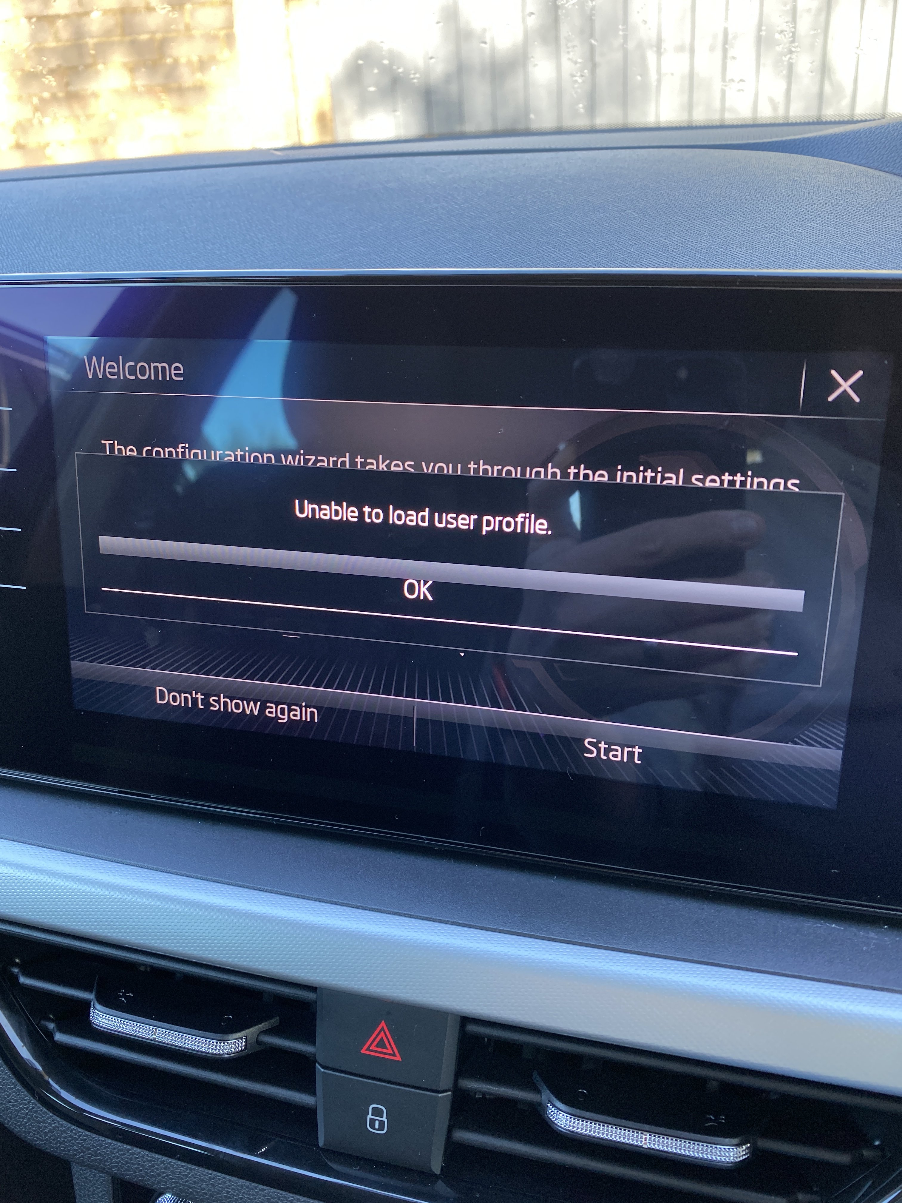

    On the Top of your Display to the left of the middle is a little world icon, is it greyed out? Mine was when I got my car and the Skoda connect would not work at all or pick up any software updates, i believe the icon means that the car is connected to the internet. I went and registered the car on https://skoda.cubictelecom.com who deal with the data side of the embedded sim card and the following day after I registered the internet started working and the car started to pick up software updates and I could register on Skoda connect as it could connect to my skoda profile. It also picked up my years subscription to the connect services. The Website is actually listed in the Kamiq handbook but its not easy to see, and the handbook does not contact as much info as i thought it would for a skoda.

    I picked up my New Kamiq Yesterday from Skoda in Aylesbury. The Car is brilliant and by far its the best skoda I have had. But the New connectivity systems they are putting on the cars are giving me a headache. The car has Skoda connect but it won't load my Skoda profile and complete the Skoda connect activation, it feels like the data connection is not working. how do i fix it..? I have been on the skoda.cubictelecom.com which is listed in the manual and created an account on there, I have tried to use my mobile as a hotspot and connect the car to that and still nothing. I have tried to do a software update but nothing happens, and if i do a new user registration on the car i also get nothing but the same screen saying that the car is activating but i have had that screen for over 45 minutes and it should not take that long.
