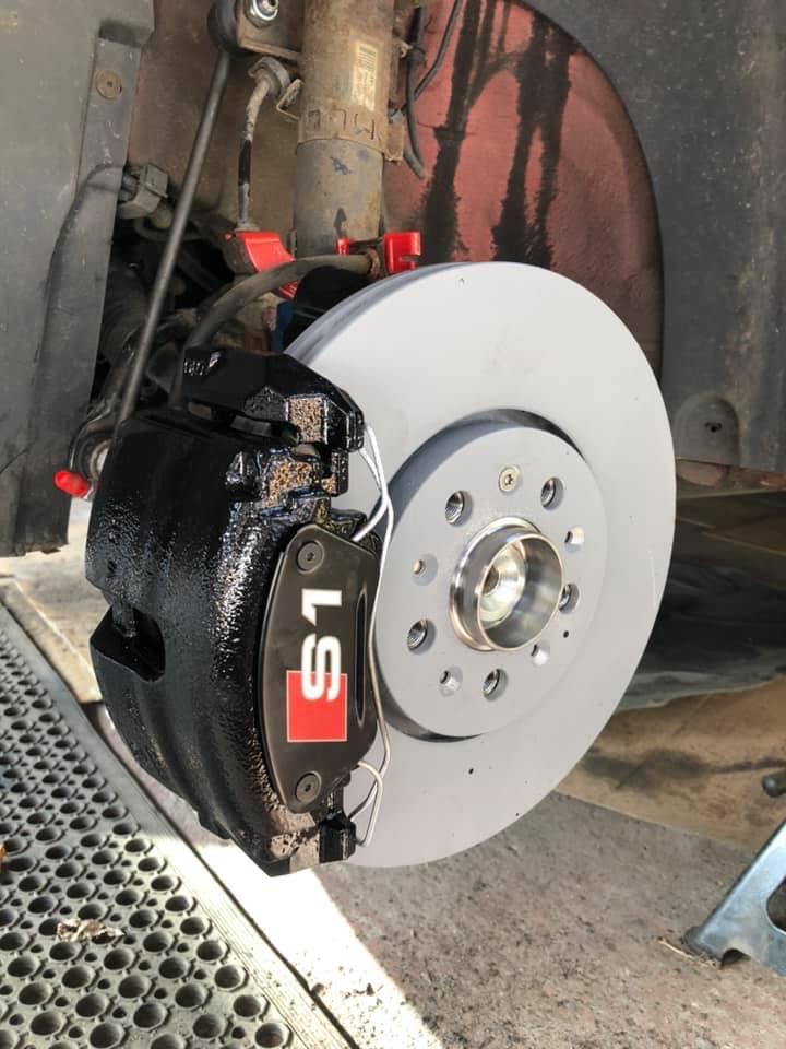

  6. ABS converted from Bosch 5.7 to 8.0 heat protection for brake and clutch lines

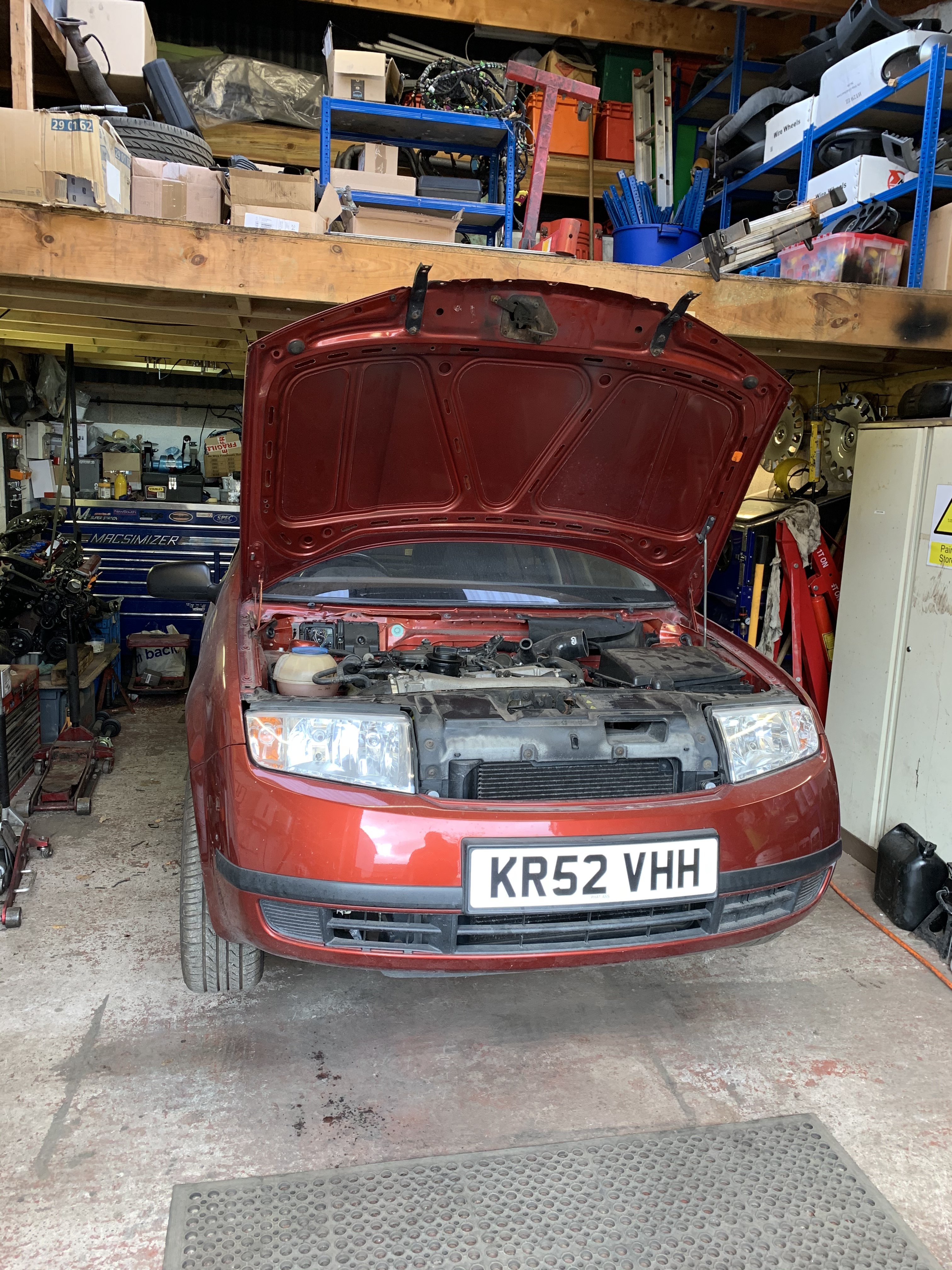

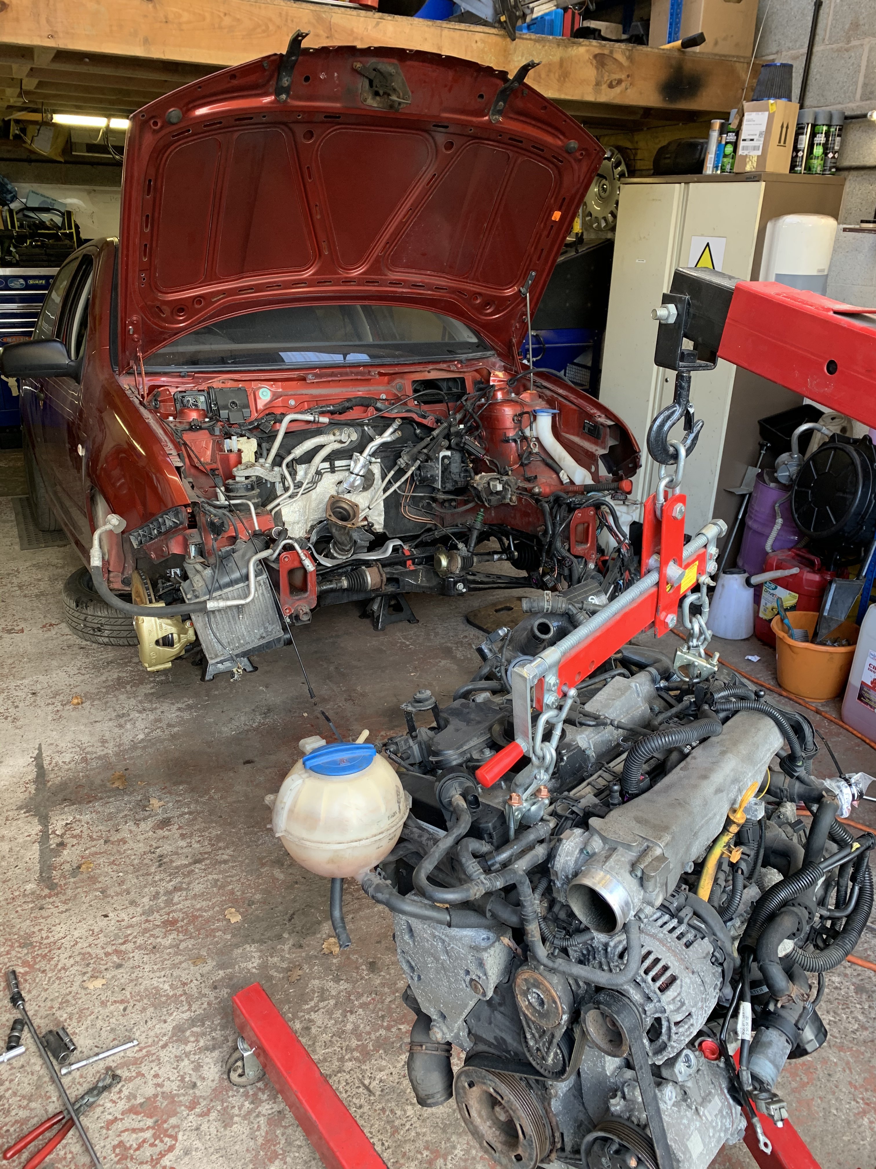

  8. SEAT wiring loom and ECU. The easiest way to do it is to build the Ibiza in the Fabia shell.

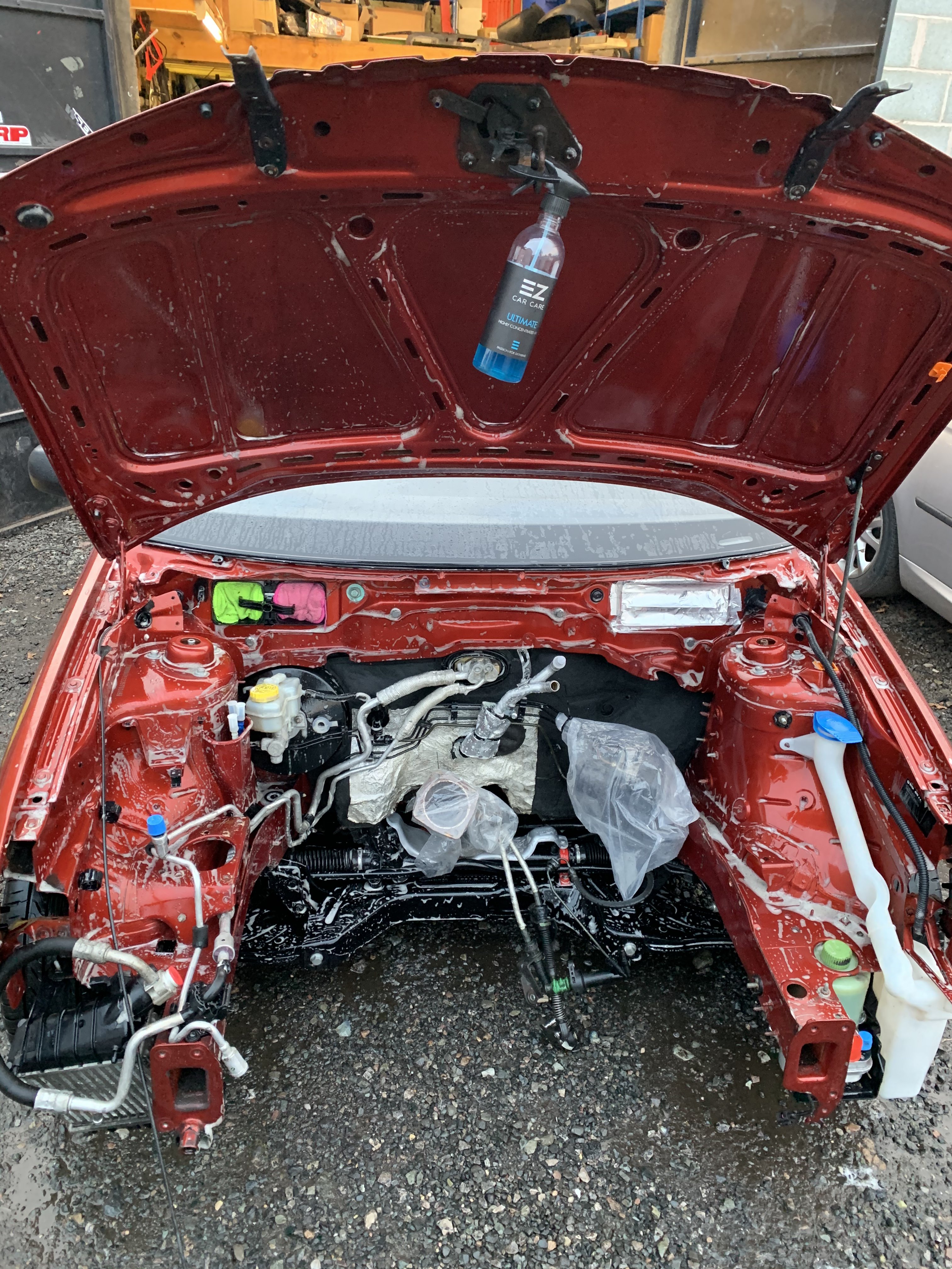

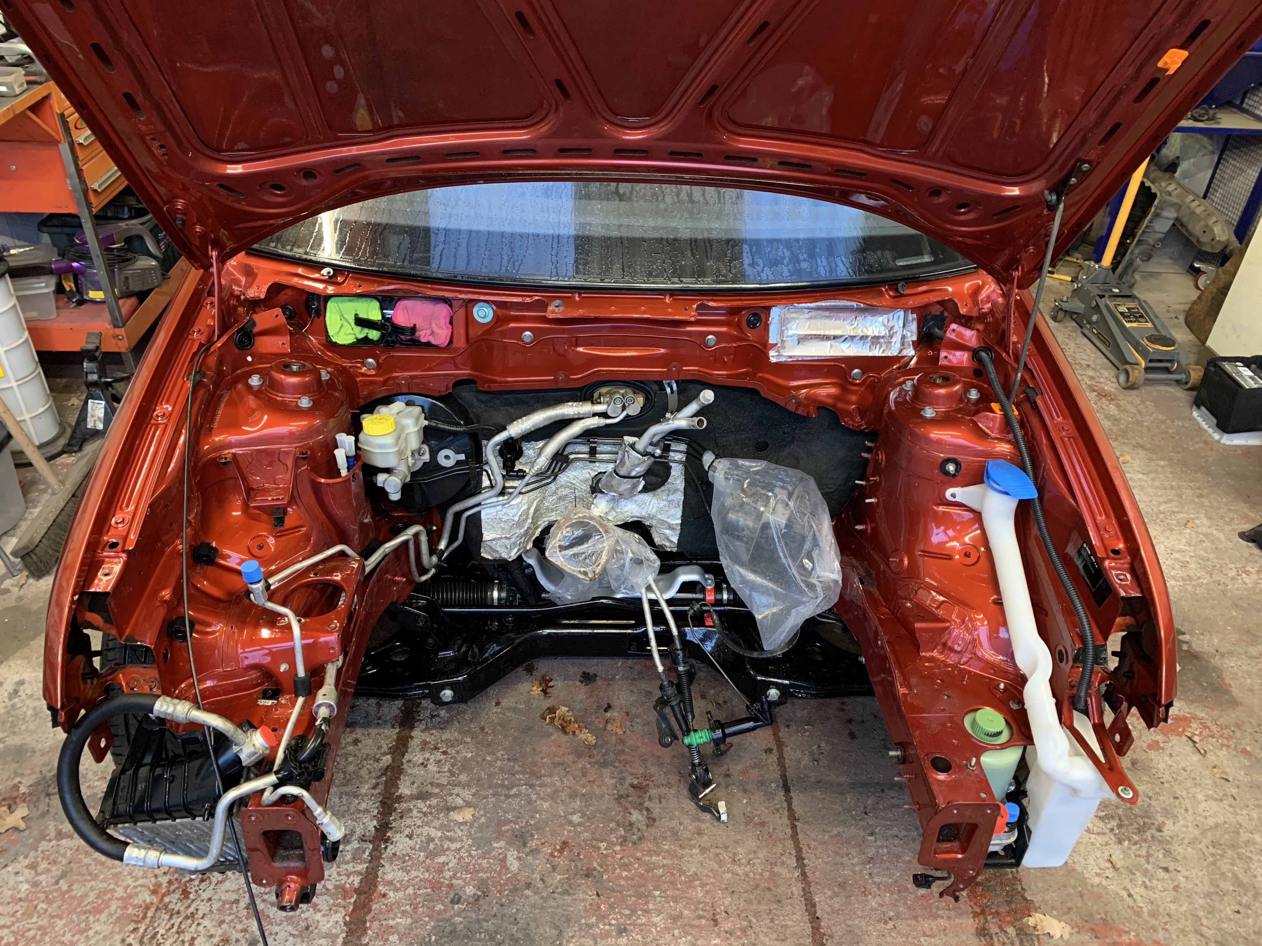

  10. Wiring harness is being swapped over with one I have remade deleting all the surplus waffle. Brake pipes are all still there, bagged the ABS unit for protection although I need to swap it over for the later type which I have upstairs. Mounting brackets to be refurbished of course.

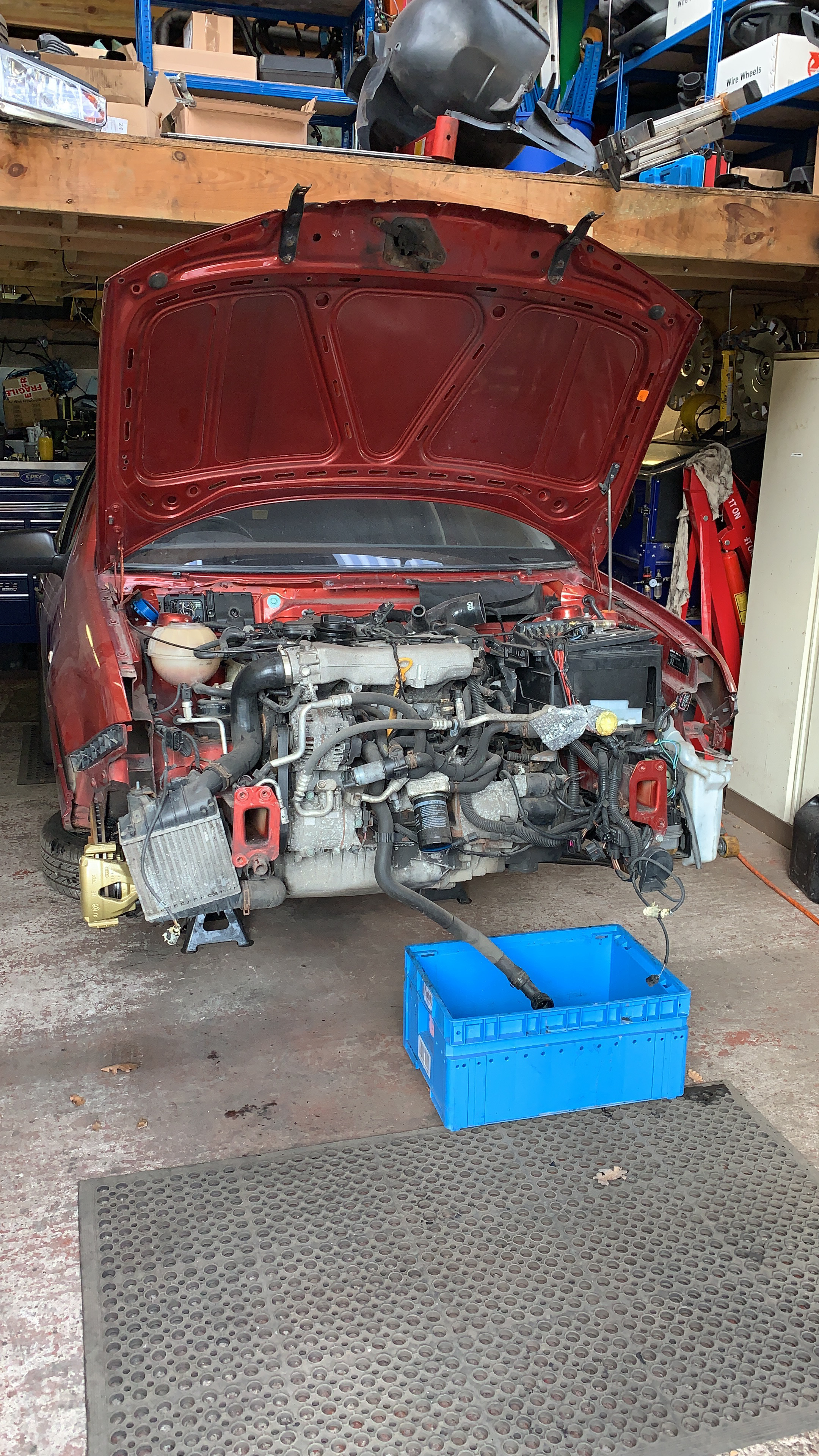

  13. Soooo here we go, it’s on. that’s Day 1 done. More fun tomorrow.

  21. You will need 310 discs (it does clarify that in the eBay listing) and the Audi A1 /S1 is 5x100. You can trust me on this one as I have them on my Fabia.
