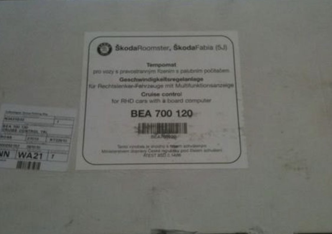

What gearbox are you using?- Retrofit Cruise Control Skoda Fabia mk2 2007 1.4L 16v Manual Transmission.
Just go straight to the engine ECU and the other is just an ignition live. You don’t need to worry about the nodes- Retrofit Cruise Control Skoda Fabia mk2 2007 1.4L 16v Manual Transmission.
Just buy yourself a kit https://www.ebay.co.uk/itm/For-VW-Polo-9N-2001-2009-Original-GRA-Cruise-Control-Lever-Cable-Tree-Complete-With-MFA-/133233441459?mkcid=16&mkevt=1&_trksid=p2349624.m46890.l6249&mkrid=707-127634-2357-0- Retrofit Cruise Control Skoda Fabia mk2 2007 1.4L 16v Manual Transmission.
Back in the day I used to buy the kit that included everything, even fitting instructions. now you have to be a bit clever, think laterally and you can make up a kit.- Retrofit Cruise Control Skoda Fabia mk2 2007 1.4L 16v Manual Transmission.
1 - Yes, that looks correct to me. 2 - they aren't terminals, they are a connection (node joint) inside the vehicle harness. 3 - Yes, I would presume so. I haven't made a loom myself for the MK2 before, I always bought them rather than mess around.- Retrofit Cruise Control Skoda Fabia mk2 2007 1.4L 16v Manual Transmission.
You will still need the wiring harness anyway.- Retrofit Cruise Control Skoda Fabia mk2 2007 1.4L 16v Manual Transmission.

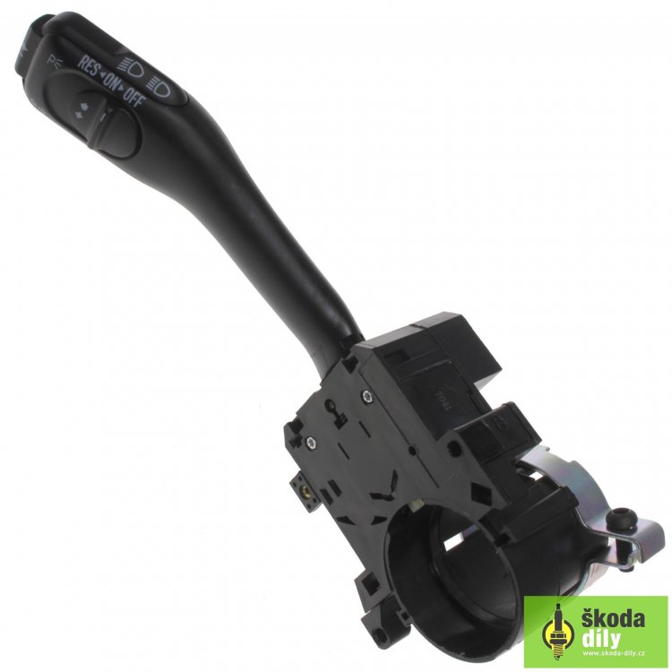

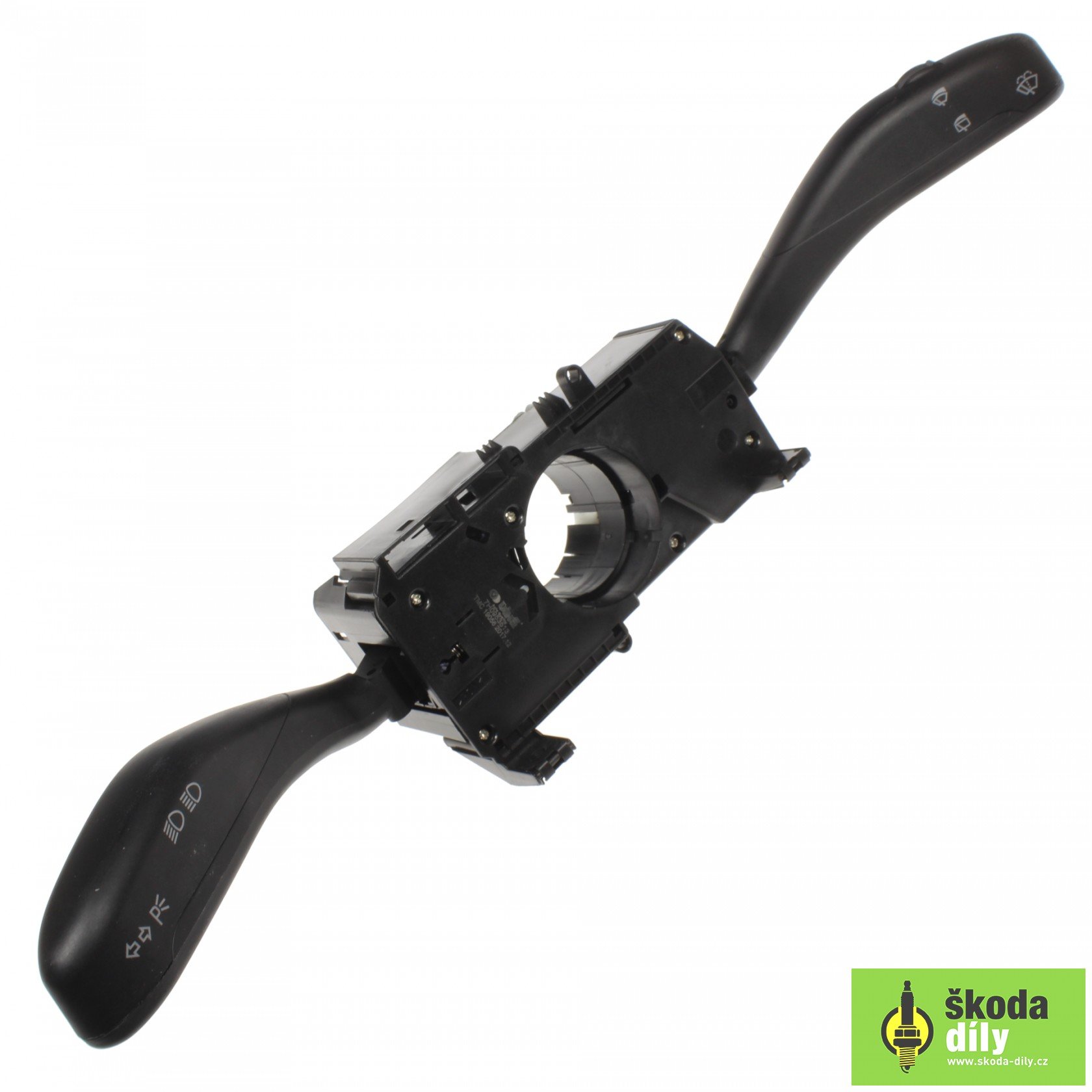

Need to have a look up under the dash above the throttle pedal and see if the control unit (square black box) is labelled with a part number 6Q0 or 6Q1. Various switches are available, it's not a one fits all. Need to work it out off your chassis number. You can see the differences in the switches and why they are different. MK1 MK2- Retrofit Cruise Control Skoda Fabia mk2 2007 1.4L 16v Manual Transmission.
On the MK2 Fabia you need to install a wiring harness and run it through to the engine control unit. Also requires the correct central electrics control unit on the car to enable CC. ...and the switch you linked is for a MK1 not MK2. Cruise control would be £240 supplied and fitted.- Cruise control won’t turn on
