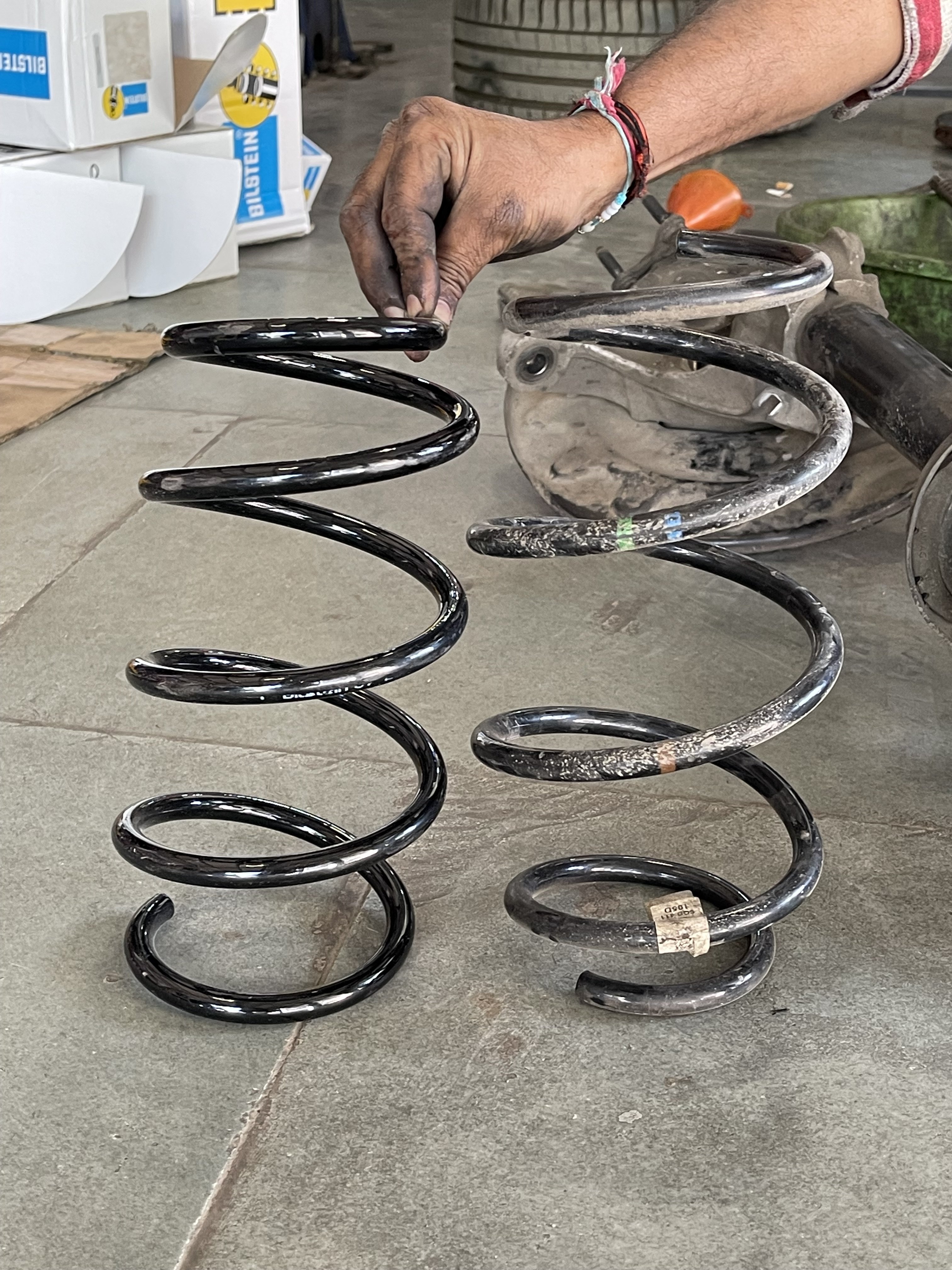

  6. Automatic gear box. Bilstein B3 Springs are the same as Euro Springs that came in the EU octavia. Here is a pic for comparison.. OEM (india) Vs B3 (new one)
  7. Hi The car came with a rough road package and the car came with 15mm lower set up. That is out of the car as of now. I am on Bilstein B6 + B3 (also known as Euro spring) and even though the spring is shorter than the OEM in the front and the back, the car still feels a bit high at the front and does feel a bit nervous around corners. B6 with H&R with 20mm drop seems to be a good solution.
