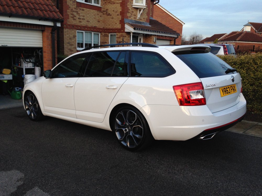

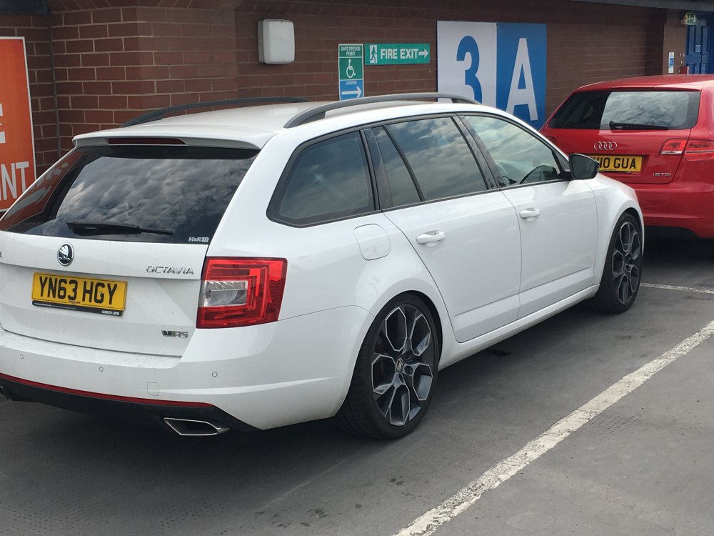

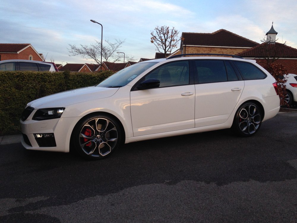

EIBACH and H&R do springs specifically for the MK3 vRS, personally i would go h&r about £150 posted from ebay.de
that white vrs is the mutts!
Edited by JohnnyType2
Yep mine on H&R has been for 60k miles and no problems with the shocks etc. Ride is better than standard.
thats the perfect stance.... i need a set of 19s :biggrin:
are you running spacers as well?
i would have assumed the ride would be much harsher?

Yea that’s on 12mm spacers all round.

Haha yea I know what it is. Lol. Nah mine is a 2013 model soooo no chassis control. The H&R are a 40mm standard drop which is about 25mm on a vrs

Just be aware that the new 2017 facelift vrs’s are already 20mm wider track at the back than the prefacelift ones. So I would think any more than 8-10mm spacers and you’ll be rubbing.. I had 20mm on and it just didn’t feel quite right, so I went to 12mm each side all round. however that pic of mine has 235/35/19 tyres on so that makes it slightly wider than original 225/35/19 anyway.
