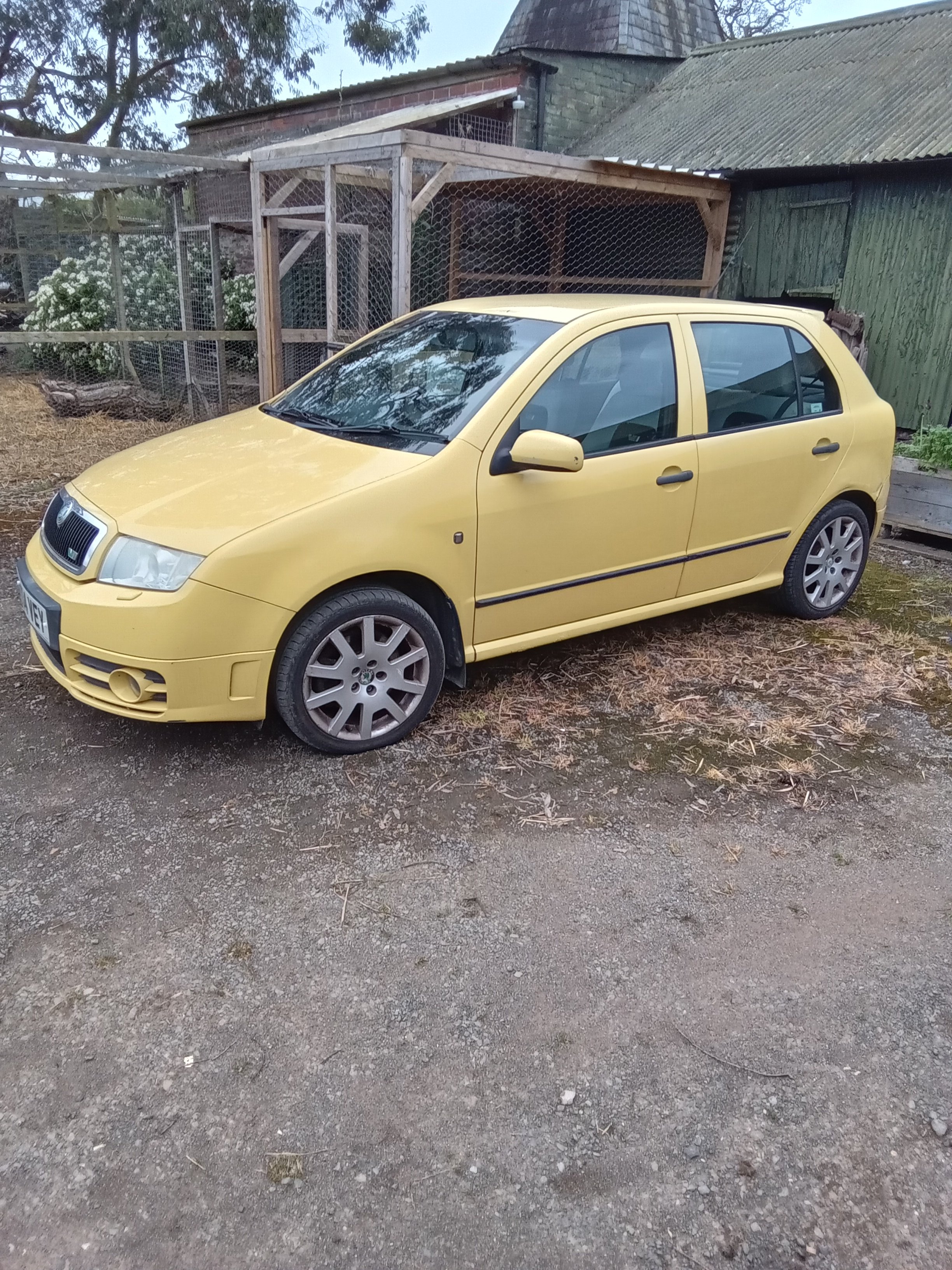

  12. Hi Pete, the thing was that the light was not on, ever, I checked the fuses, they are fine, I did then run my diagnostic kit and it came up with an historic error, right rear sensor, I cleared the error and the warning light comes on and goes out after a couple of seconds, just as it is supposed to. thanks for your help, case closed. Will
