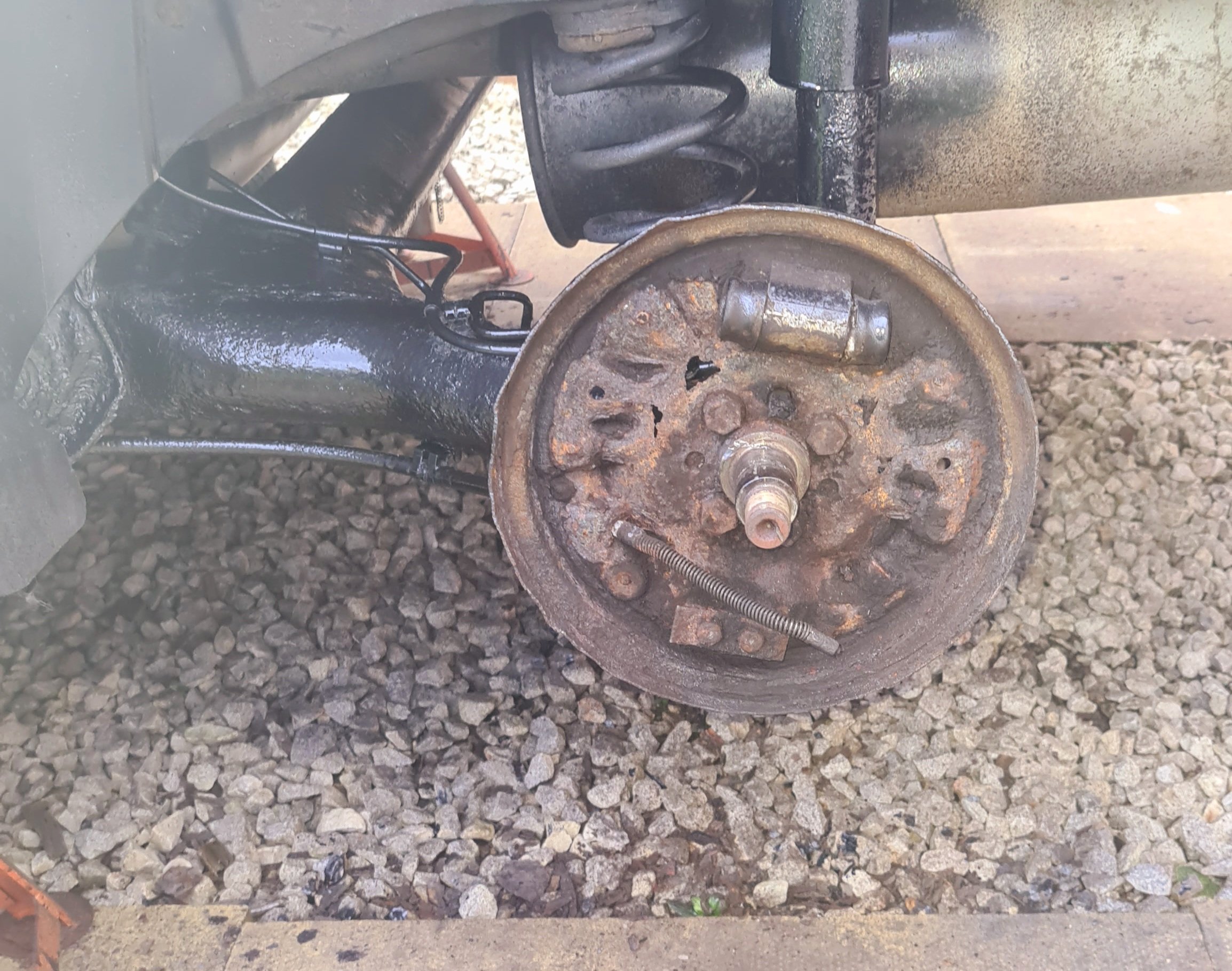

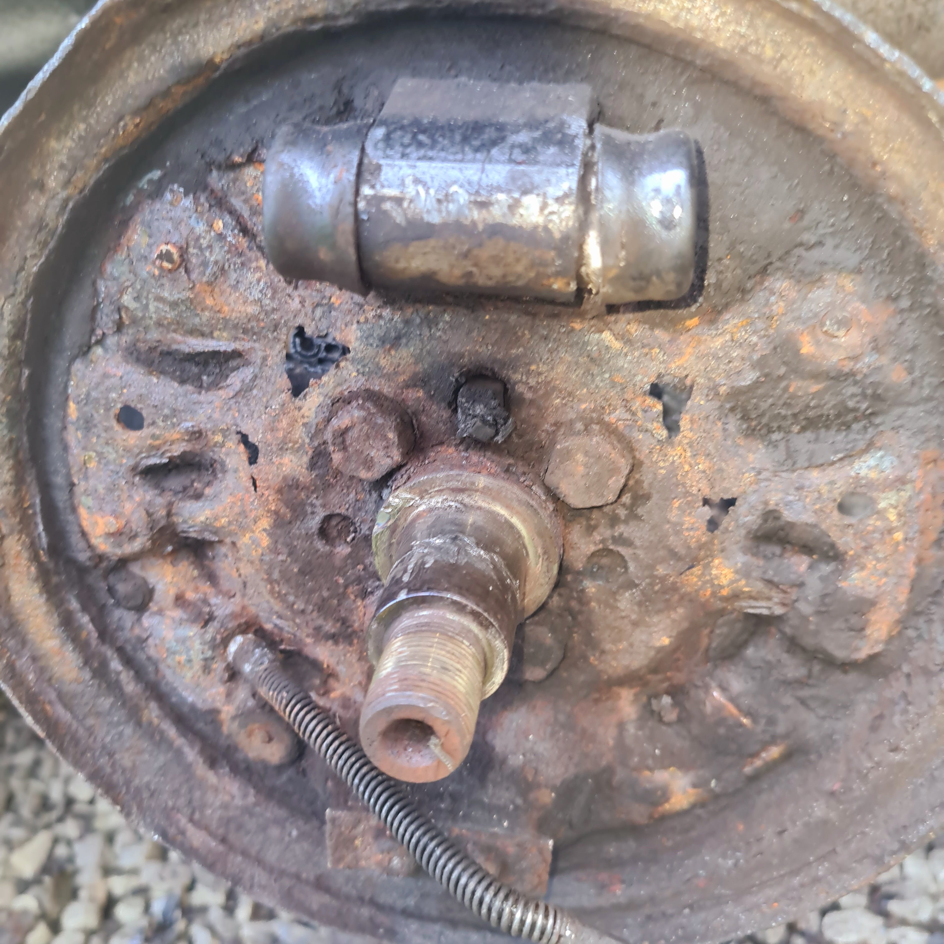

  4. Hi.. Does anyone know of a supplier of the above drum backplates? Can't find any online, even good used ones would be ok, especially a n/s plate as mine is rusted out.

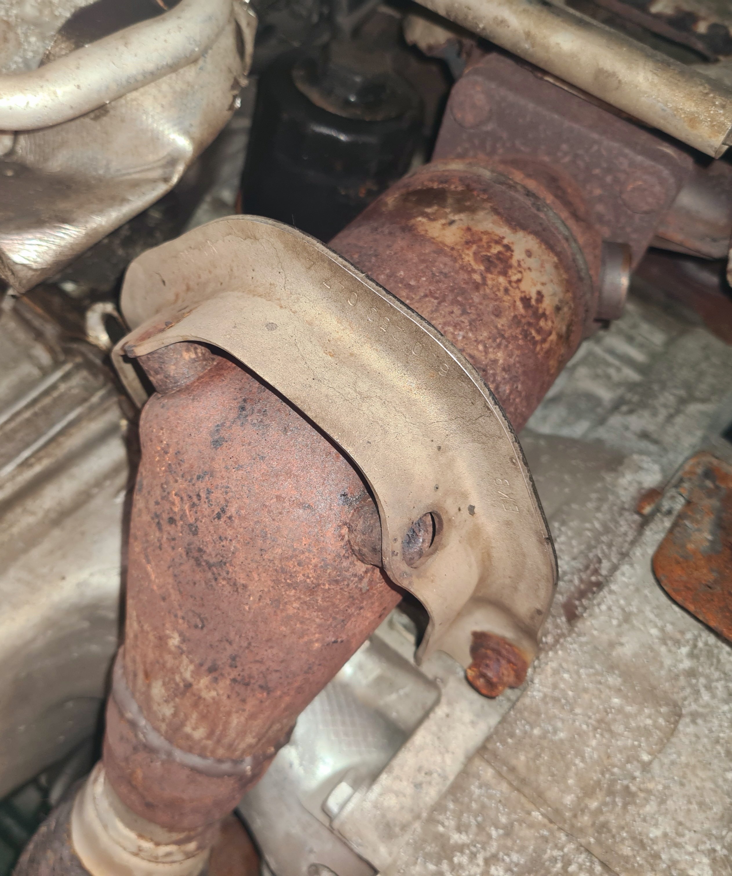

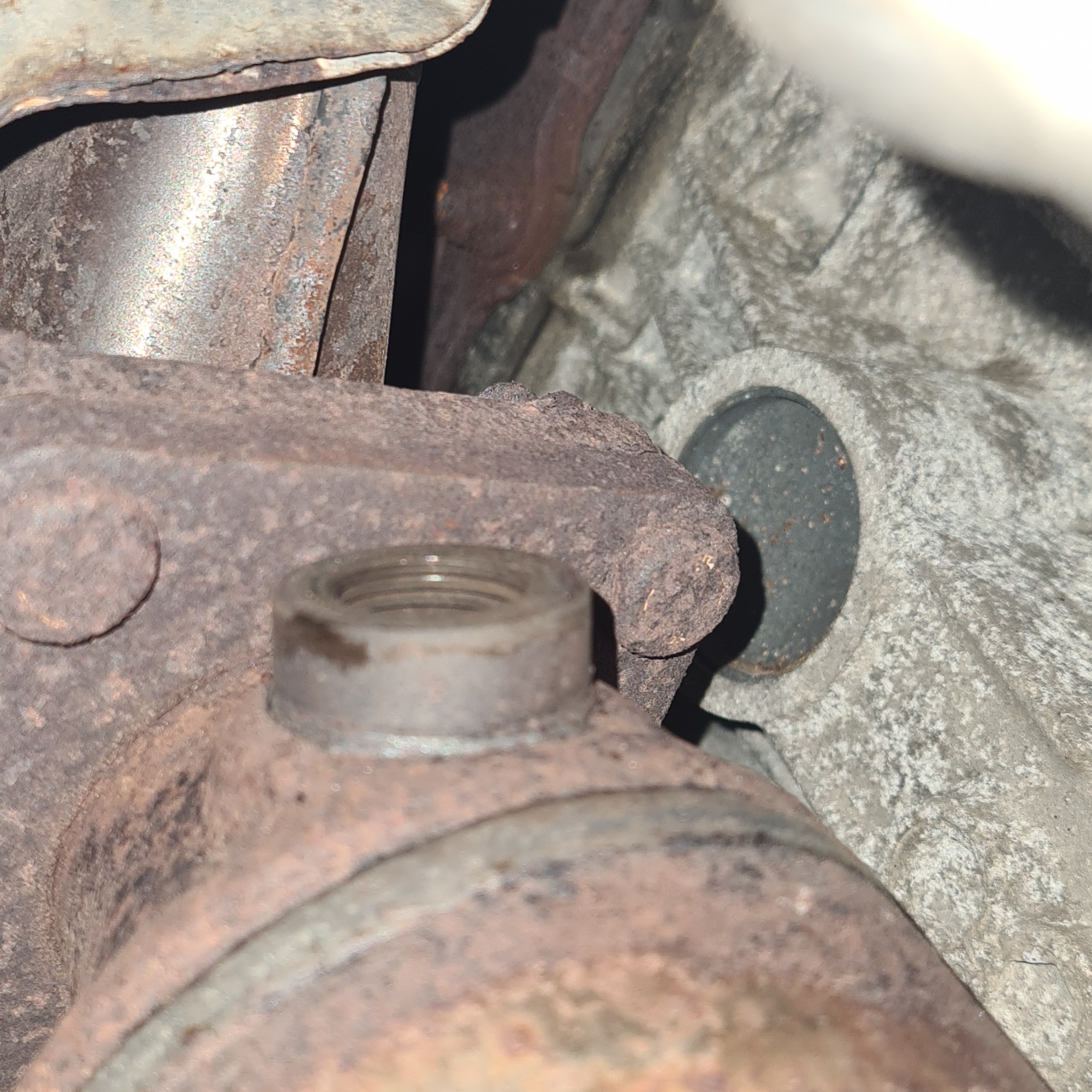

  5. Hi.. I need to replace my main cat as its blocked and leaking. I thought it would be a simple matter of cutting out the old one and fitting an equivalent Euro4 replacement. Problem I'm having, is that I cant find a suitable unit as the pipe is 1.75" diameter and none appear to be Euro4 anyway. So, It would seem I have to replace the front pipe section from the exhaust manifold. On my car, there is a big pre-cat can with an O2 sensor port atop it, but the replacement sections on line don't appear to have a pre-cat, nor a sensor port. Can anyone please advise me on the best way to resolve this. Cheers..

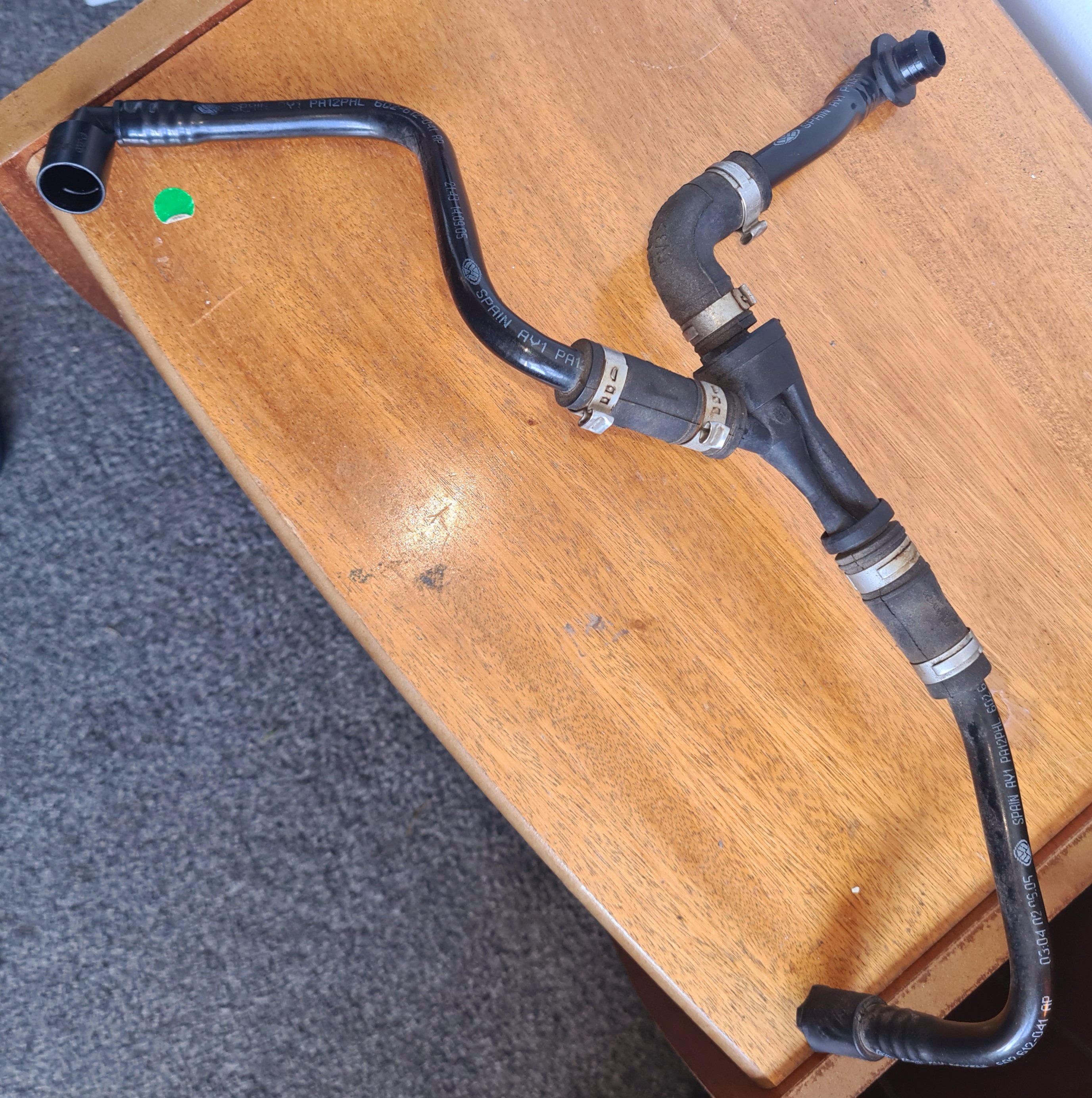

  6. Hi.. Can anyone explain the components on my brake servo pipe please? The end with the spigot goes to the servo, and the other end to the throttle body, ..but what is the other end for, next the green sticker on the table. There is a fair amount of vacuum on this pipe when I put my thumb over it and it attaches loosely to the left side of the airbox lid. Surely this would create a vacuum leak as I am having MAP issues and the motor (2006 1.4 16v) won't rev..

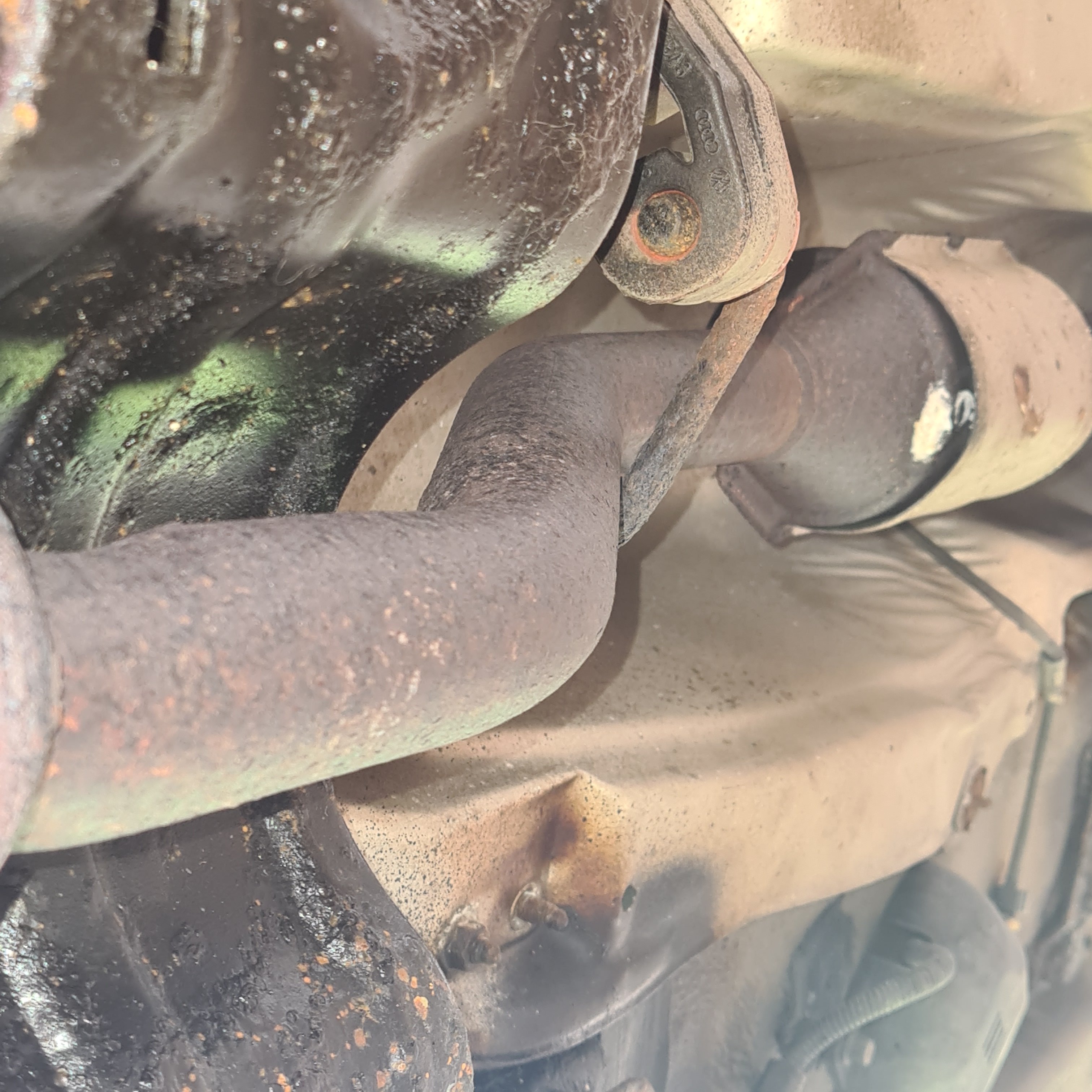

  13. L98 started following VCDS (VAGCOM)
