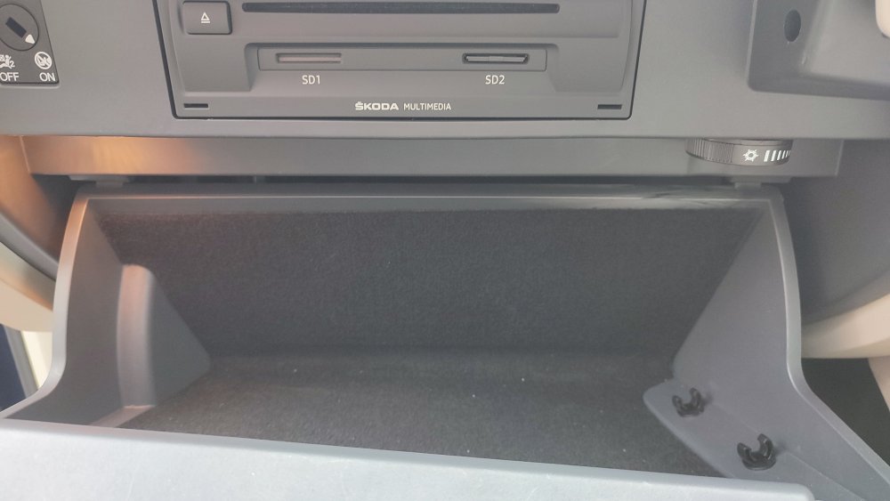

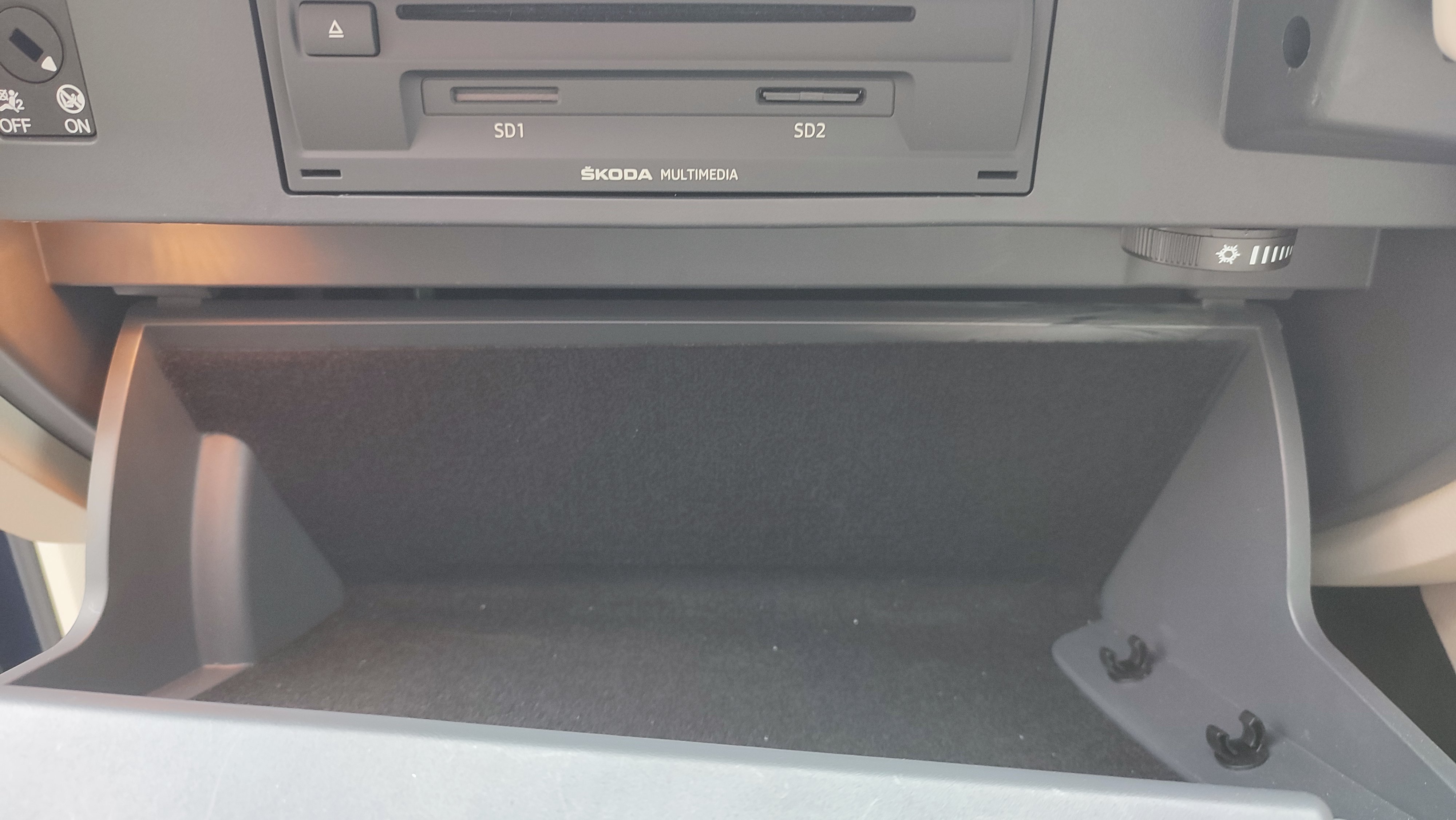

  22. Thanks for all the help everyone - however having looked at the glovebox it is not immediately obvious to me quite HOW you lower the glovebox. The picture shows interior of my glovebox and the DVD/CD drive
