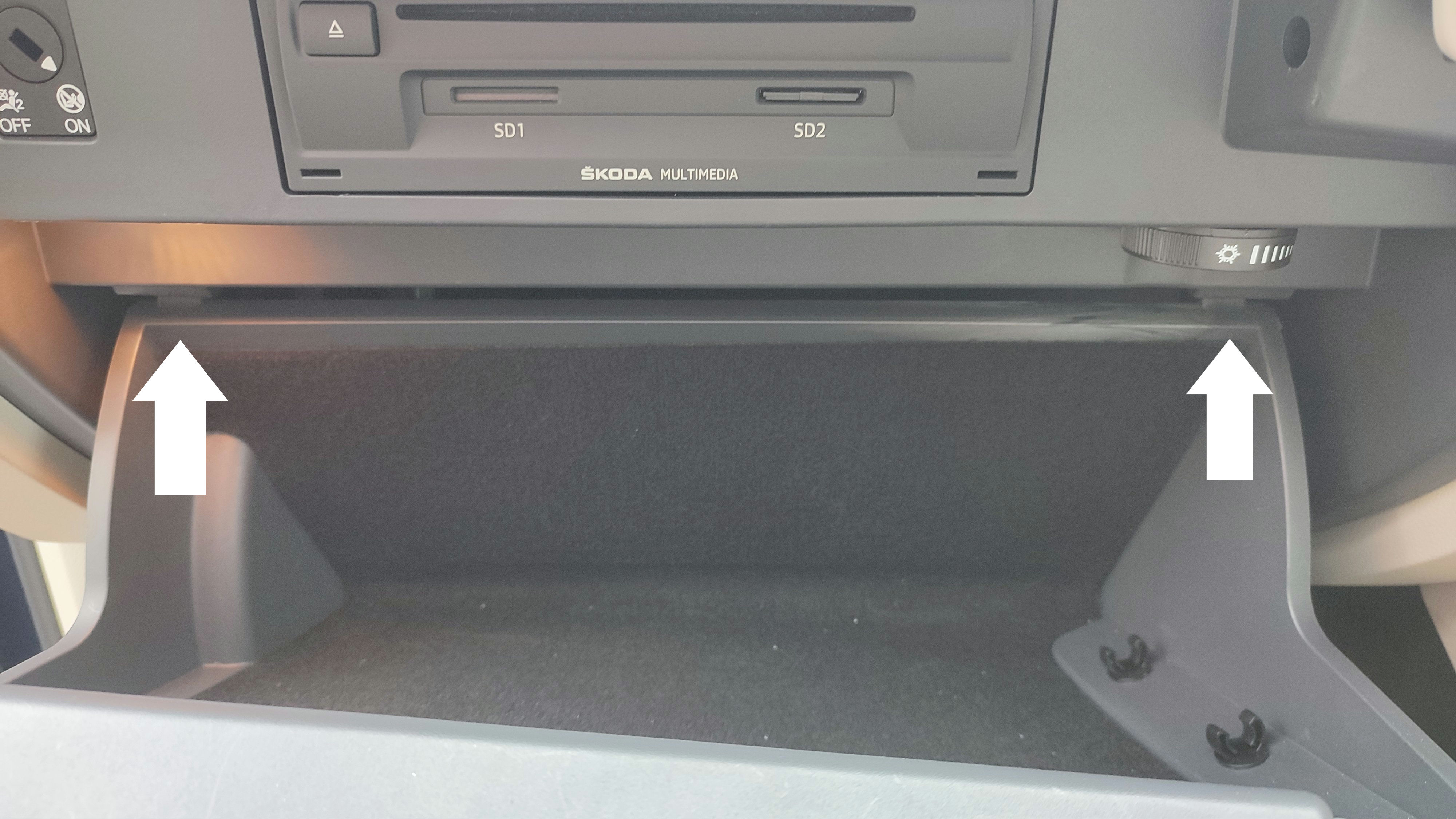

Thanks for all the help everyone - however having looked at the glovebox it is not immediately obvious to me quite HOW you lower the glovebox.  The picture shows interior of my glovebox and the DVD/CD drive1521448763_IMG_20210724_1159591.thumb.jpg.28a31821f71f1ddc095f19db943e4457.jpg
A little bit of pushing - pulling - squeezing and tugging required where the moulded box reaches its end stops..........it's plastic, it 'gives' quite a bit. B)

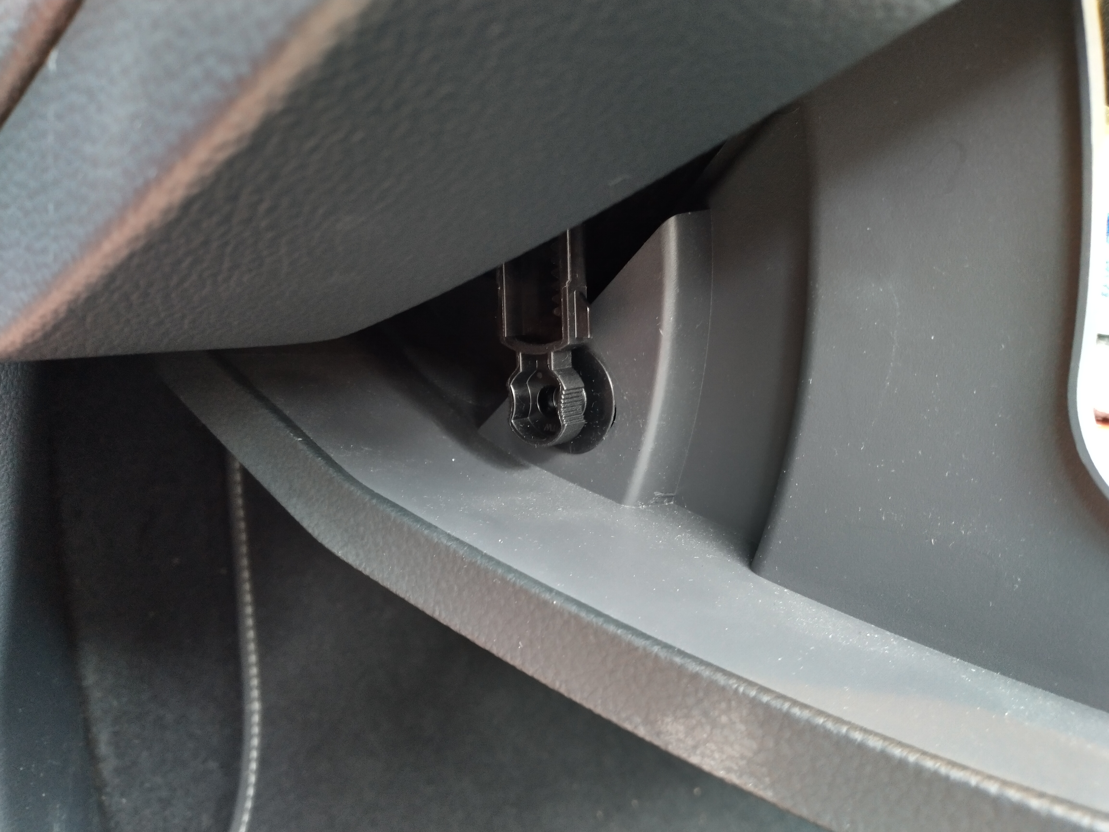

I had to access the fusebox recently to hard wire my dash cam.
Open the glovebox and locate the clip in the left side. Pull this towards you to unlock.
Once unlocked, find the two tabs and push them up and the glove box will drop.
Once complete, push the glovebox back up and push the clip back to lock.
