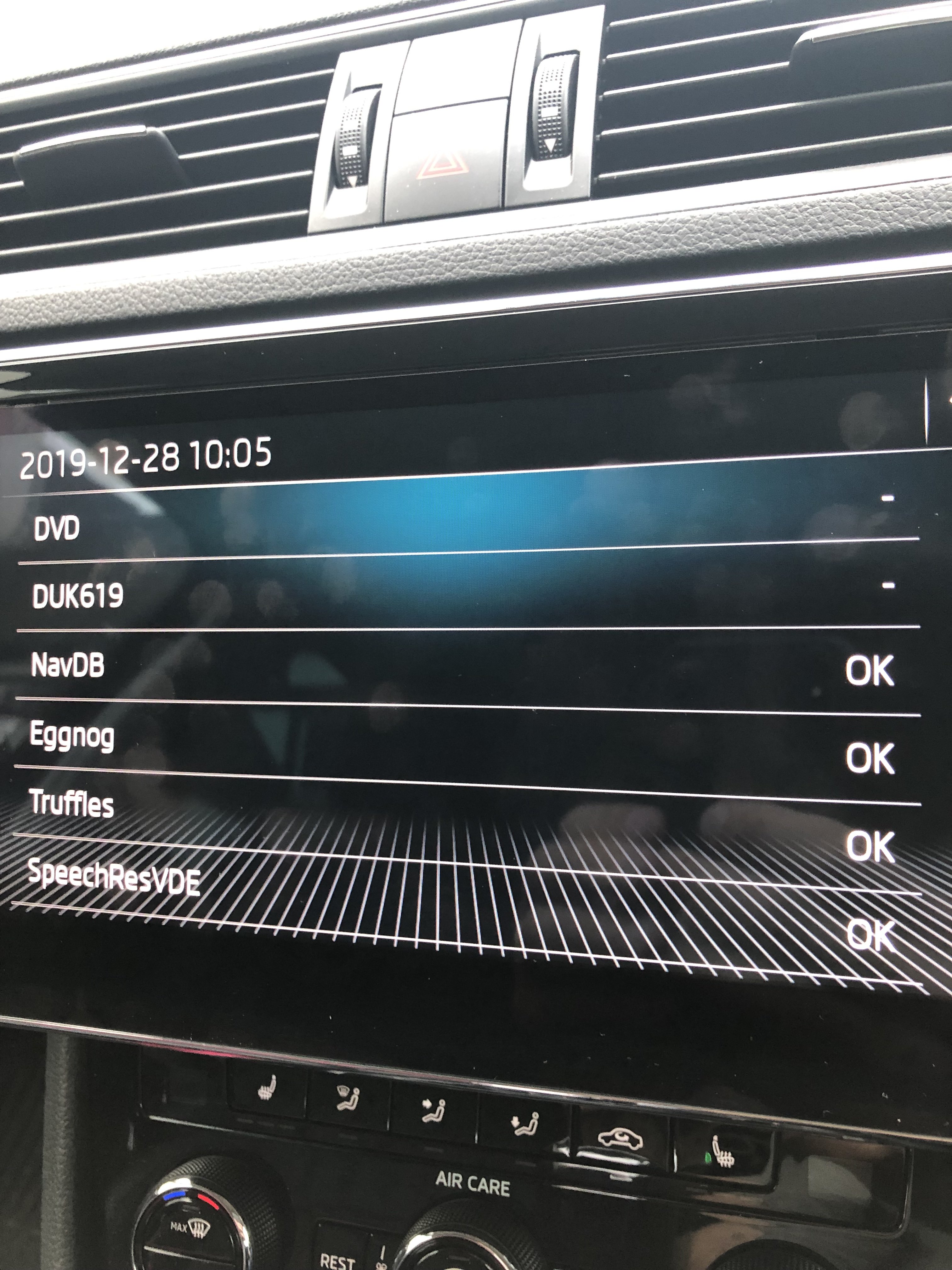

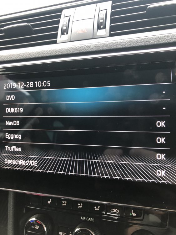

Oh, I finally managed to launch the update. I pressed the « Menu » button for 2-3 s and accessed to another menu I had never seen to update a whole bunch of softwares.
The system has recognized navigation update information on the SD card.
Upload is pending. I cross the fingers...
The strange thing is that it’s a complete different process, compared to the previous map update, I made... Not very intuitive...
What a bizarre menu! Eggnog, Truffles, what on earth are these???

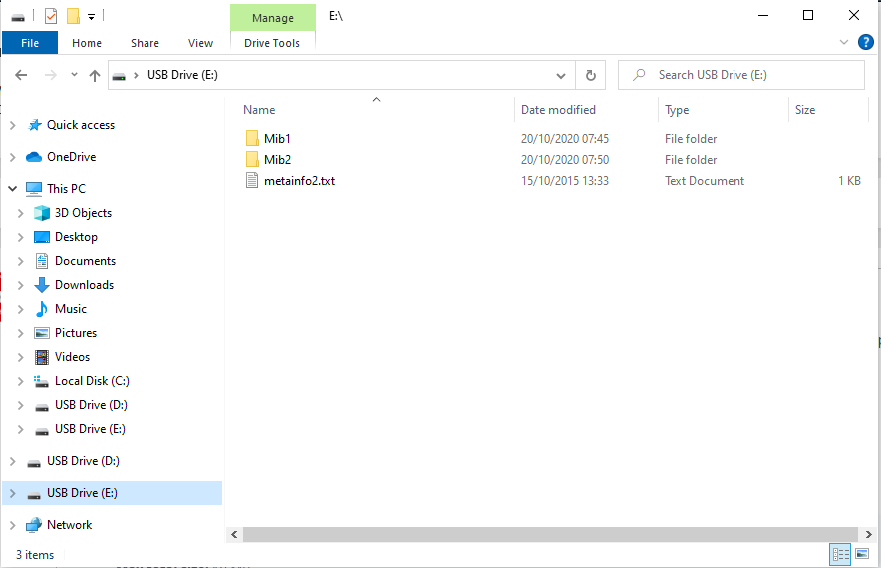

Hi Everyone, I am a new owner of this wonderful (used) car but I am having a problem with updating Columbus Sat nav with latest version (2017>21/22). I have done many times what other people do with no success. I went to Skoda portal, used the WIN number and downloaded the update. I have used different programs for un-zipping the software, using different full size SD cards (all 32GB class 10), alternating between slot 1 and 2, running engine or not - Columbus simply does not want to know. It is reading the card and then after half a minute or so it disregards it as if there is no data worth to look at.
Can someone please enlight me?
Hi Martini, thanks for the reply. Unfortunately, I did not find there anything new I could use or try. Just to confirm - there is one file WMPInfo & folder on the card - HIGH12_P192_EU_202125 with Mib1. Mib2 and metainfo2. Aprox. 541MB left free on Sandisc ultra 120MB/s card. Error message: no data available
I’ve not had a problem updating my Columbus 2018 (done a couple of times and due to do again), I use a 128gb micro sd in SD adapter (borrowed from the dash cam usually) and just extract the downloaded file using standard winzip on windows 10 with the card formatted using windows and copy the extracted folders across.
