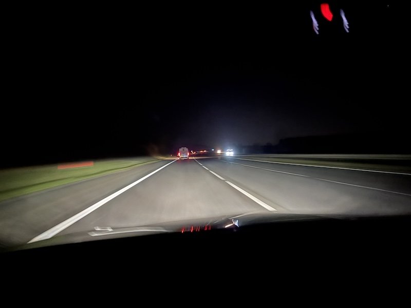

Holy thread resurrection, Batman!
I took a photo yesterday morning, just after 5am, as Mrs Cubbington was driving and wanted to get an idea of the light output, as it was looking pretty good, and she never complains about the lights being dim.
Take the pic with a pinch of salt, as iPhones do over-expose dark images, but I was pleased that the standard beam wasn't any worse than a lot of the other vehicles - it was only vehicles with LED lights that were much brighter...my last three cars have had LED headlights, so I think my issues have been just getting used to how much of a difference there is between the two technologies!
Cheers,
Nick
