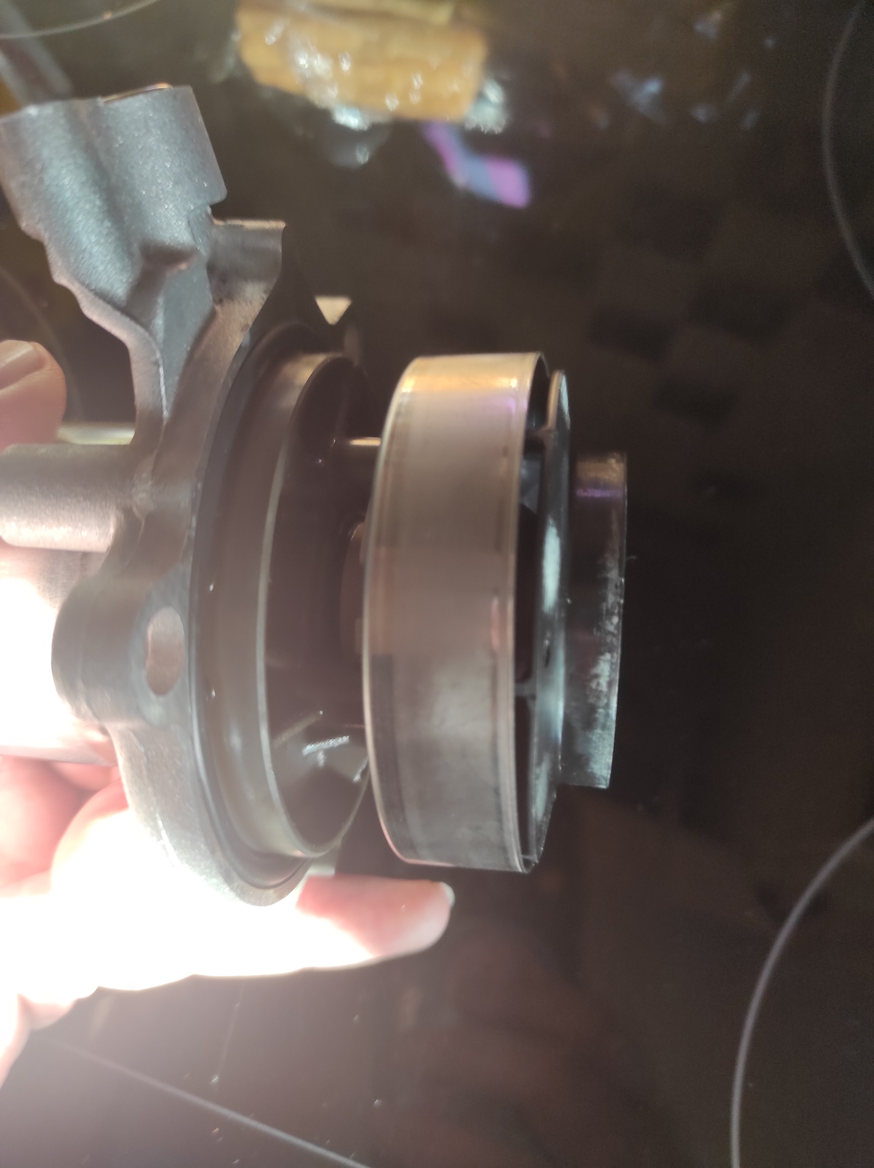

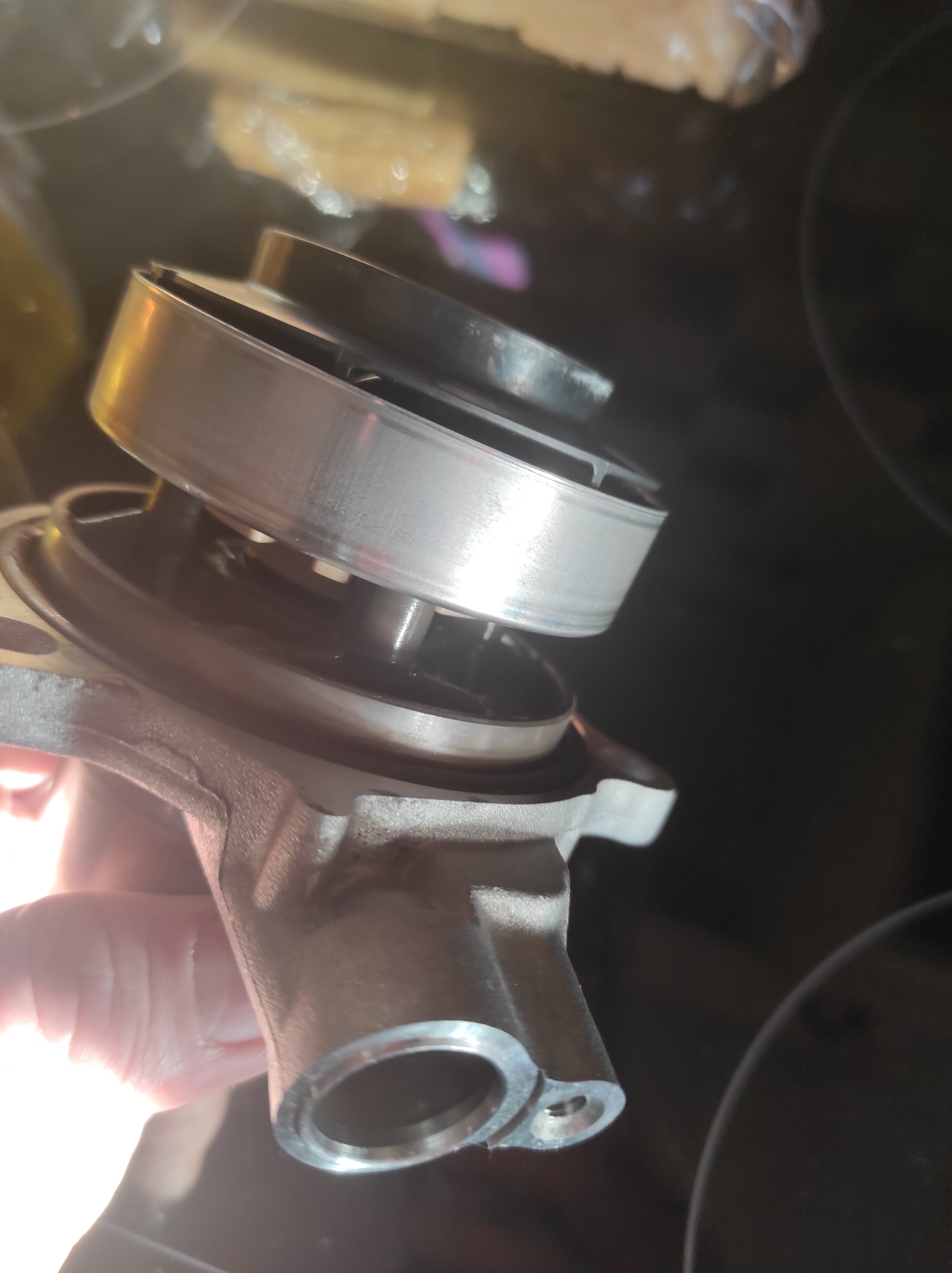

Mine is a Skoda super 1.9Tdi there using the same water pump in a lot of the VW brand and a lot of failures they know all about it
Kodiaq overheating at "random"
Mine was a 2019 had 40,000 on the clock it's a knowing fault try Skoda and see if they can do a deal I think Skoda UK recommend timing belt change after 5 years or 120000km which ever comes first if it is the water pump your better off getting the whole trimming belt kit done
How old is the car is it still in warranty I had the same problem ended up just bringing it to my local mechanic and got the timing belt and water pump done got the water pump without the problem part that's causing the problems

Had same problem on a superb tried disconnecting the wiring to the water pump but there wes a lot of stuff had to be removed first ended up getting the whole timing belt kit replaced by my local mechanic and made sure the water pump didn't have the shroud. Mine failed at 40.000 KM wouldn't risk the hassle of it failing again

That's the faulty water pump .
