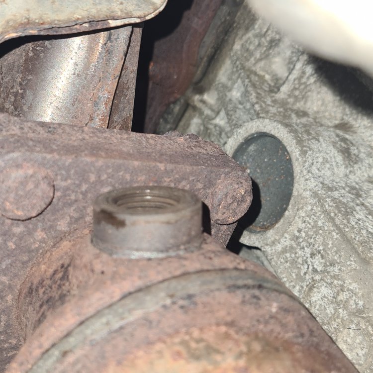

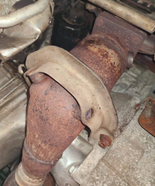

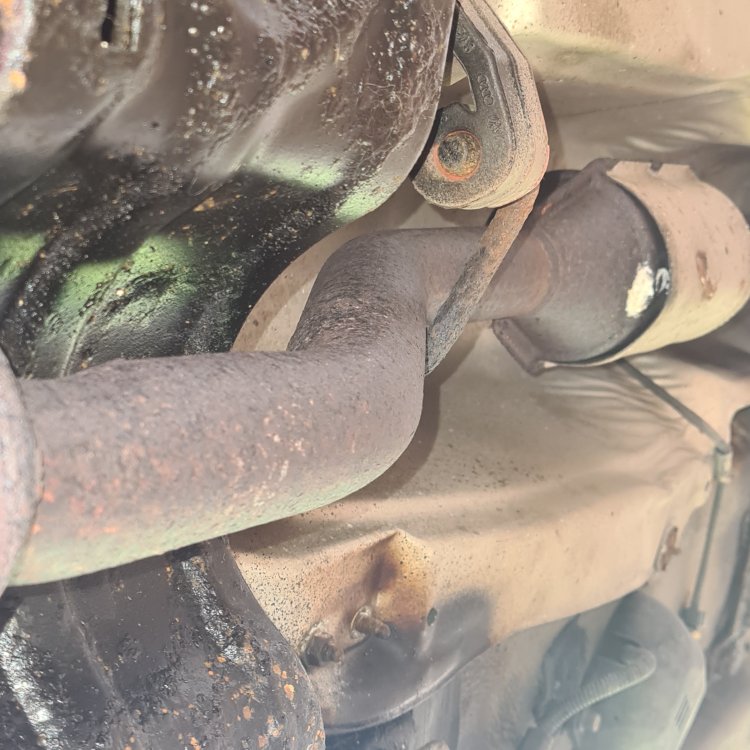

I need to replace my main cat as its blocked and leaking.
I thought it would be a simple matter of cutting out the old one and fitting an equivalent Euro4 replacement. Problem I'm having, is that I cant find a suitable unit as the pipe is 1.75" diameter and none appear to be Euro4 anyway. So, It would seem I have to replace the front pipe section from the exhaust manifold.
On my car, there is a big pre-cat can with an O2 sensor port atop it, but the replacement sections on line don't appear to have a pre-cat, nor a sensor port.
Can anyone please advise me on the best way to resolve this.

I think the aftermarket ones will as you say omit the precat, which only really affects emissions during warm-up, so not essential for MOT.
Both sensor bosses are present on this one, if you zoom in on the images. Not recommending this particular one, there are several similar I think.
