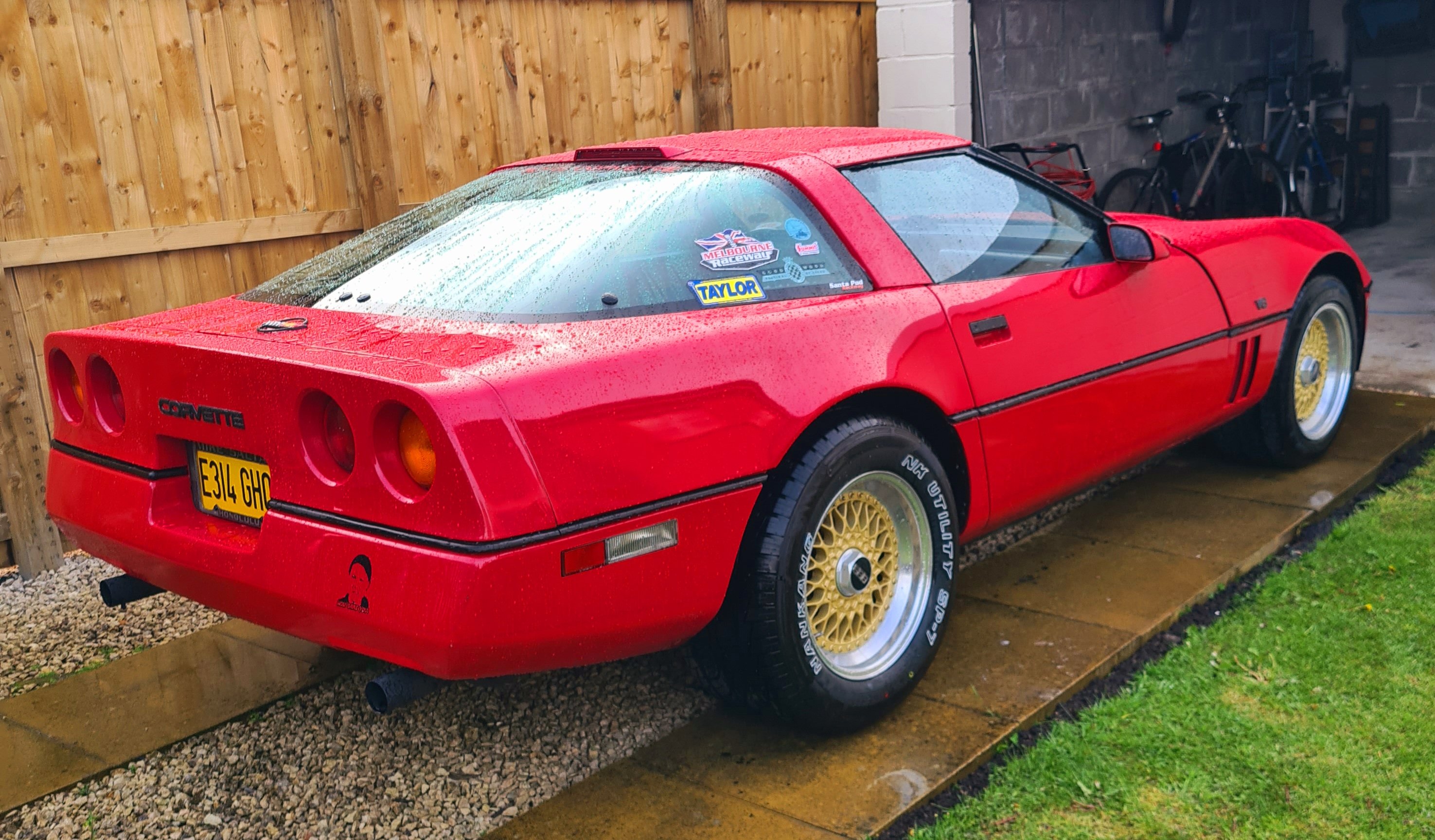

I'm 71 and been tinkering on cars since I was about 10, (my daily since 2004 has been an '87 Corvette that is really simple to maintain) but this Fabia's engine has me stumped, but as cheap as it is, I just can't give up on it, ..its been a great car up til now.
