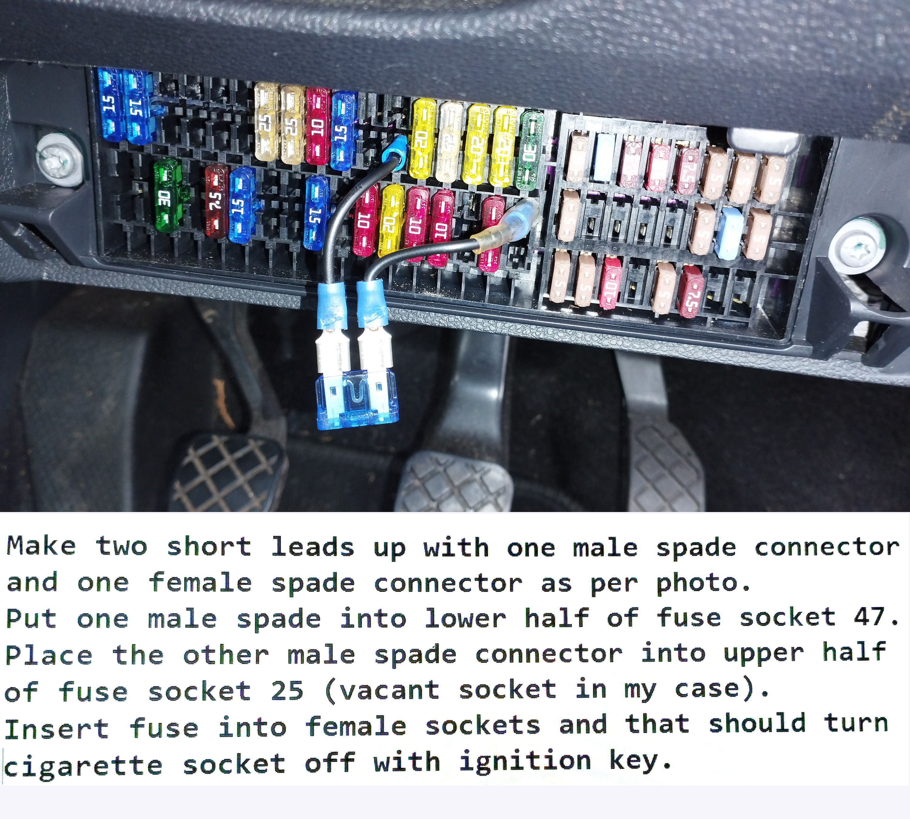

  3. How to turn cigarette socket off with ignition key.
