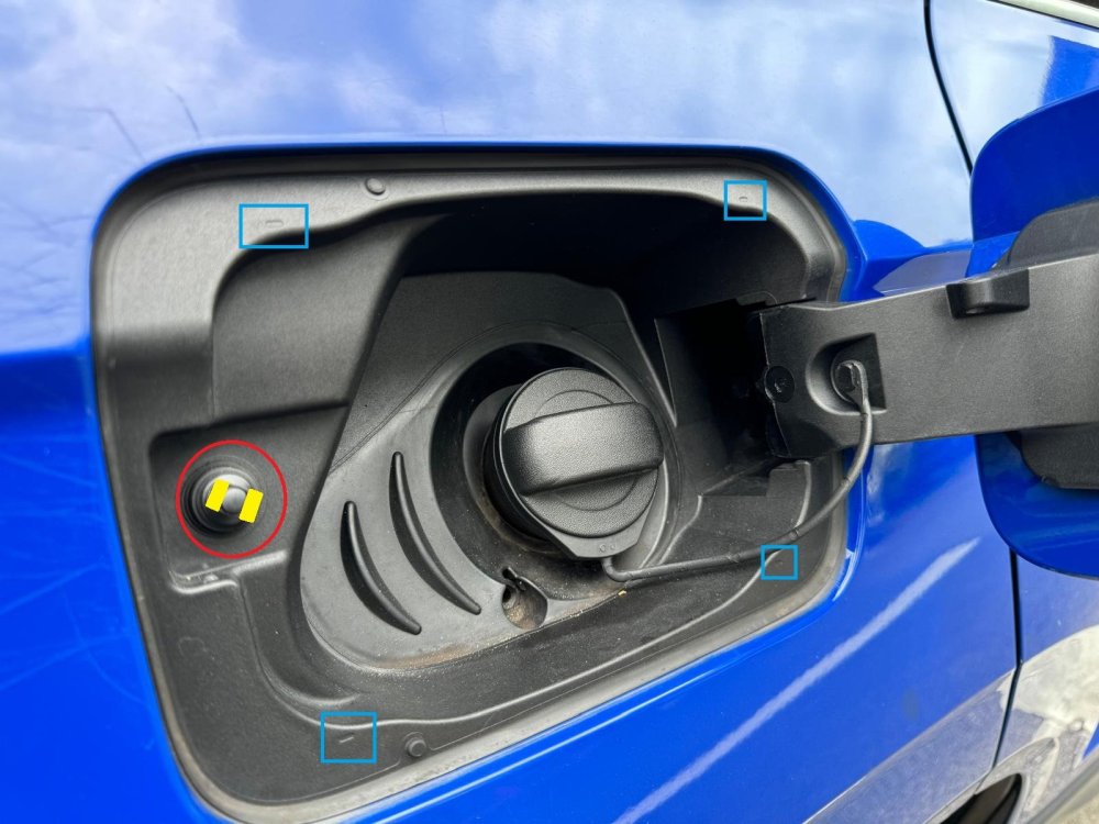

Dear All,
Did anyone attempt to remove the inner lining by working at the points marked in blue ?
I am so tired of sucking.

There are two distinct issues and they occur on many VAG models with this design of filler flap latch and acutator.  One is the latch sticking in the filler flap (it has to rotate through an angle to latch and unlatch).  This can be fixed, or prevented, with silicone spray or graphite lubricant, which will need repeat treatment if it washes away.  The other is actuator failure, which needs a replacement solenoid.
A really crummy design with two flaws, and it has gone un-fixed for at least 10 years, as it occurs on a family Leon from 2014 as well as a 2023 Karoq.

Looking at the part shown on an eBay listing, it looks like there is a manual way to operate it, pulling a red string. Perhaps accessible through the same panel on the interior where you get to the back of the rear lights?
https://www.ebay.co.uk/itm/276401112321
