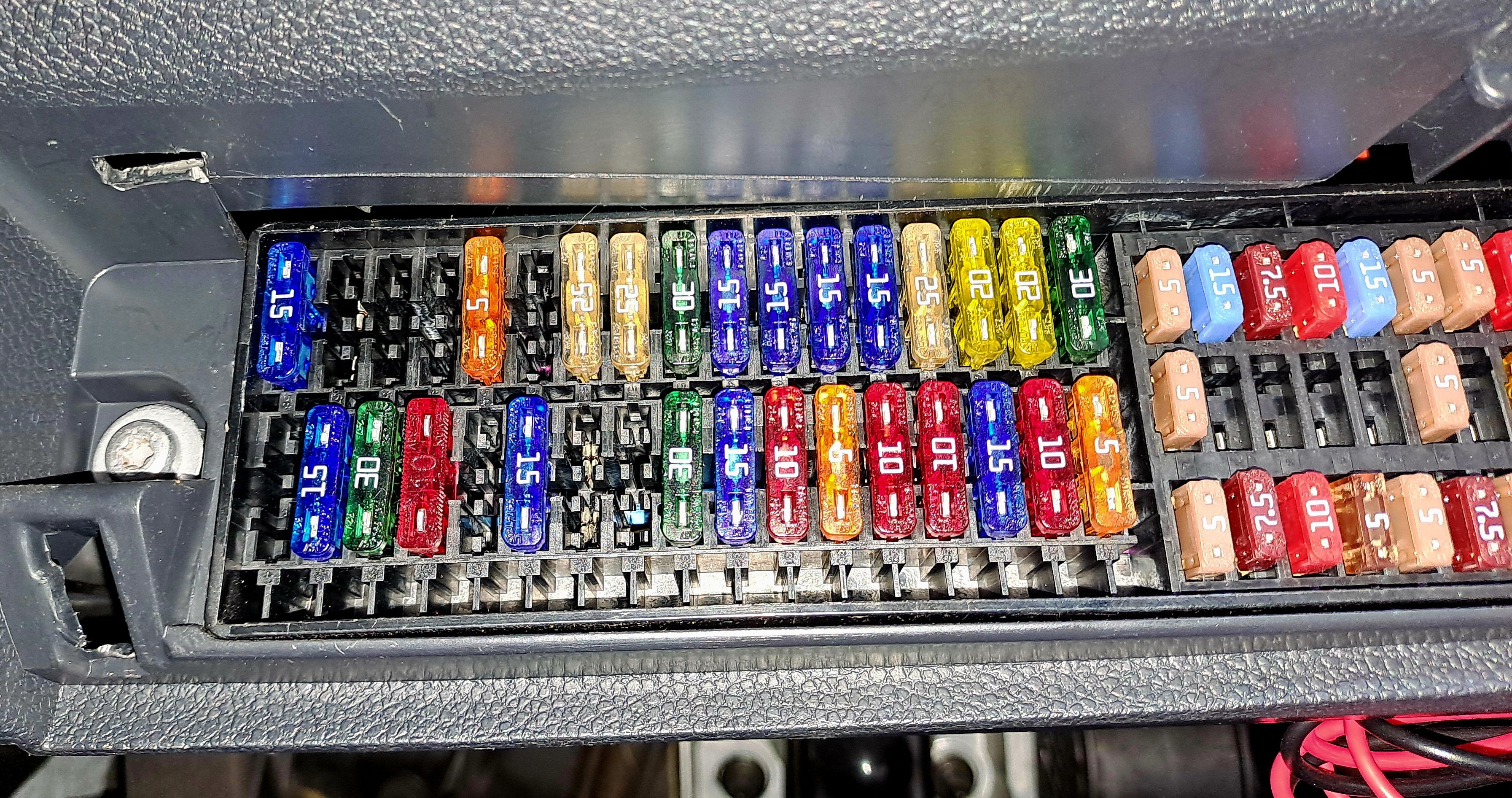

All sorted now; user error 🫣 I had put a fuse back in the wrong bay. Eejit.

Hi, can anyone with a UK Mk 2 Greenline Estate (mine is 2011) post a photo of the fuse compartment under the steering wheel? I need to be able to see the fuse ratings and their position clearly. The handbook tells me the assignment but not the values and I may have repositioned one of them wrongly yesterday after installing a dashcam. Neither my tail lights, sidelights, headlights, or dashboard lights come on when I turn the lights on. This is what mine currently looks like (I’ve removed the dashcam piggy-back, which was using bay 44, rear wiper). Thanks!
