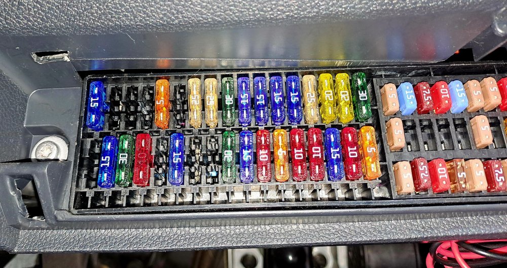

can anyone with a UK Mk 2 Greenline Estate (mine is 2011) post a photo of the fuse compartment under the steering wheel?
I need to be able to see the fuse ratings and their position clearly.  The handbook tells me the assignment but not the values and I may have repositioned one of them wrongly yesterday after installing a dashcam.  Neither my tail lights, sidelights, headlights, or dashboard lights come on when I turn the lights on.
This is what mine currently looks like (I’ve removed the dashcam piggy-back, which was using bay 44, rear wiper).
Thanks!
All sorted now; user error 🫣
I had put a fuse back in the wrong bay.  Eejit.
