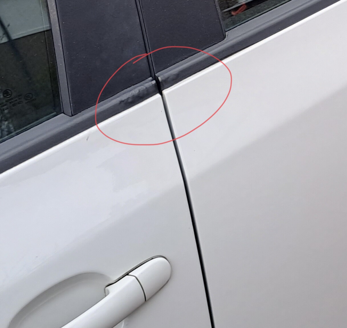

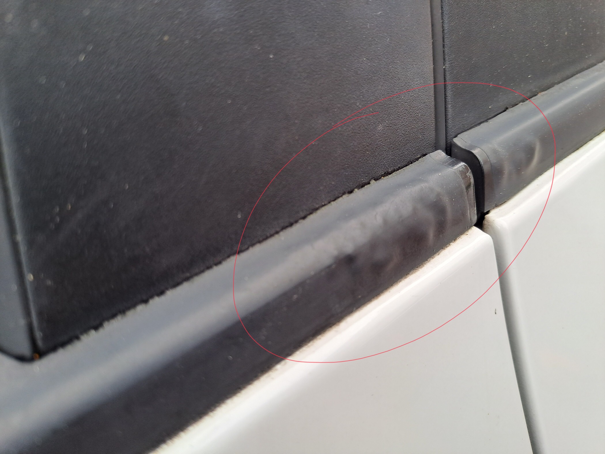

My car went in today for a warranty repair to the common problem of rust around the registration number lamps area of the tailgate. At the same time that I reported the tailgate rust (last October), I also reported the bubbling rust under the paint on the metal trims that sit at the top of each door. This affects both sides of the car but is worse on the passenger side (see photo). No explanation has been given, only that ”they believe this is not a defect” but I don’t see the difference between that and the tailgate rust. Both are a result of rust under the paint and there is no paint damage that has allowed moisture to get in. Anyone else had the same rust and had it repaired under warranty?
