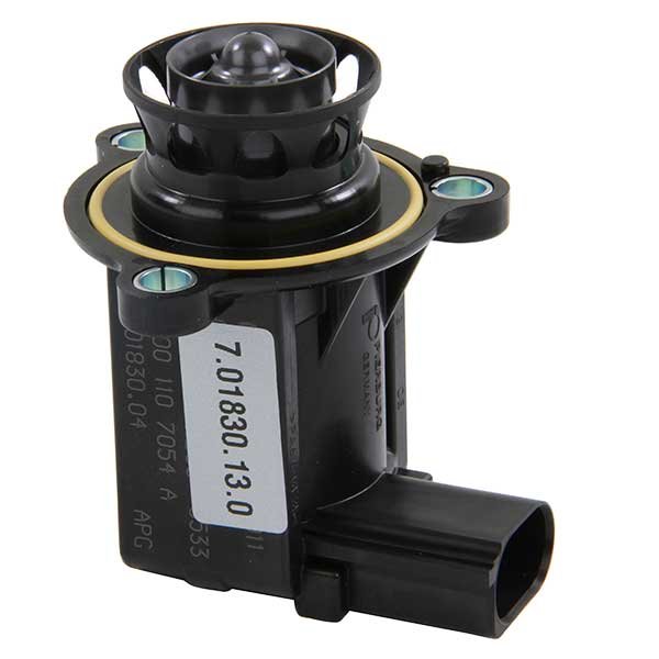

  6. Thanks for your reply. The seller says it's an RTMG BOV that he's installed on it, he said that he left the one that he took off originally in the boot. I checked it and this is it (see photo) (not actual item but looks exactly like this).
  7. Hello Forum, I've just bought a Fabia VRS (2014) 1.4 Petrol and it came with a blow off / dump valve already installed. I'm not really liking the loud hissing sound it makes. Can anyone point me in the right direction as to what part the dump valve replaced? So that I can remove the dump valve and replace it with the original part. Thanks
