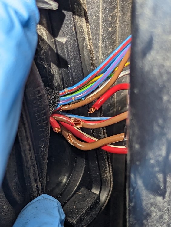

@Breezy_PeteWell the driver's door loom looks fine. The passenger much less so. Picture attached. Two wires broken and at least 4 others damaged. Great design, but many thanks for the diagnosis ! On my Superb twinboot, once I had repaired it, I threatened all of my family to never let me catch them using it as a boot, but only as a tailgate (which means we can't use the button on the keyfob). Is there an way of stopping this happening again once repaired (other that climbing in through the tailgate) ? If I wrap lots of pvc tape round it is that just going to push the 'flex' elsewhere ? Why is the passenger door loom shredded and the driver's door loom look perfect ? Surely the use factor should suggest it should be the other way round ?

I'd repair it any old how for the time being, and see if any functions are restored, seems like some things ought to re-awaken.
Perhaps drivers side loom has been replaced before now?
@Breezy_Pete Yes, perhaps the driver's side has been replaced. We only know the history of the last 5 years. Will update once I have finished soldering ....
@Breezy_Pete Well, I am very sad to say that after repairing 2 wires and re-insulating 5 other wires on the passenger loom, and then re-inspecting the driver loom and finding cracks in the insulation on 4 wires UNDER the cloth tie that hold them all together and re-insulating them too, that it has made absolutely no difference to the locking behaviour :-(.
