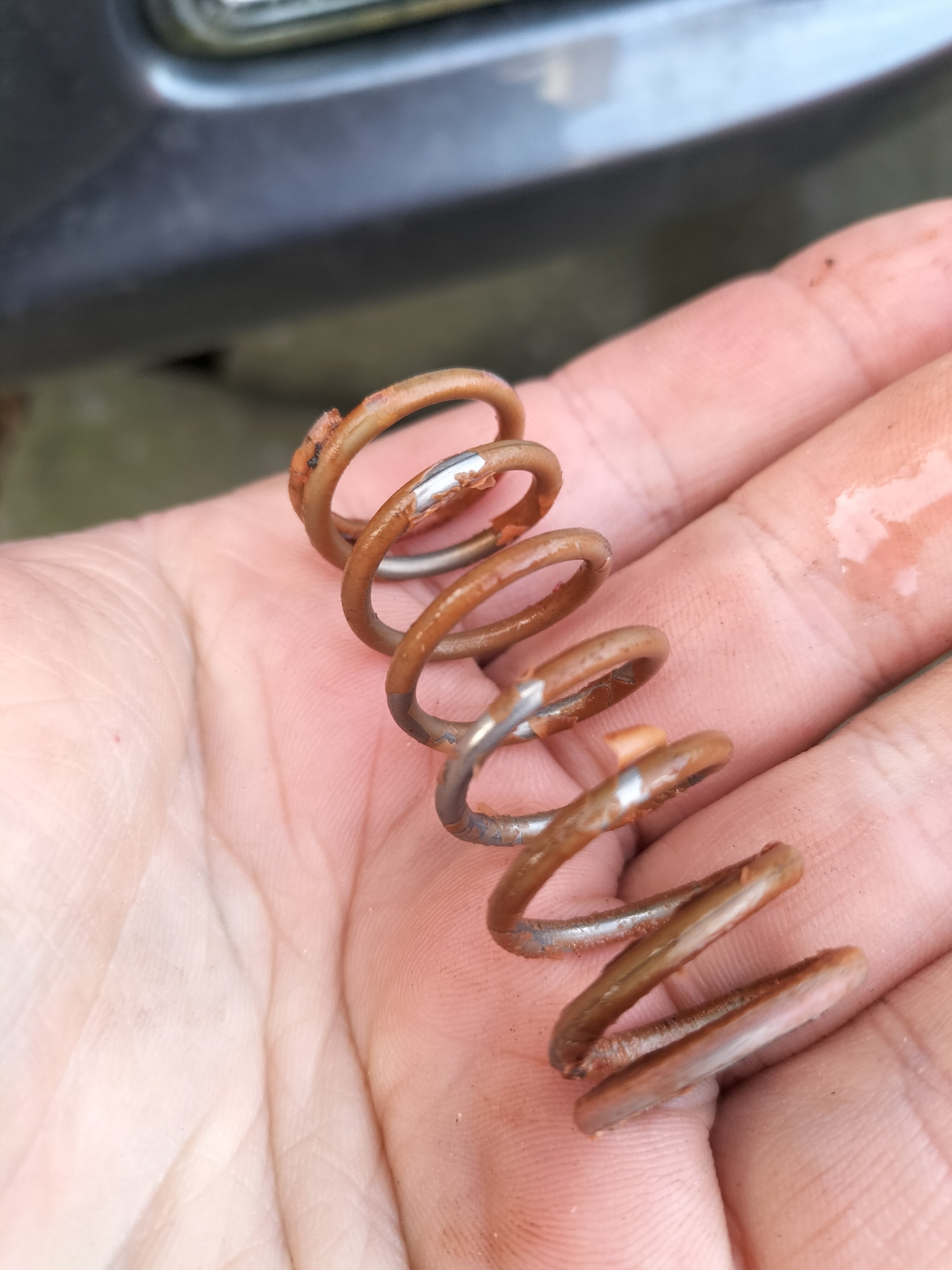

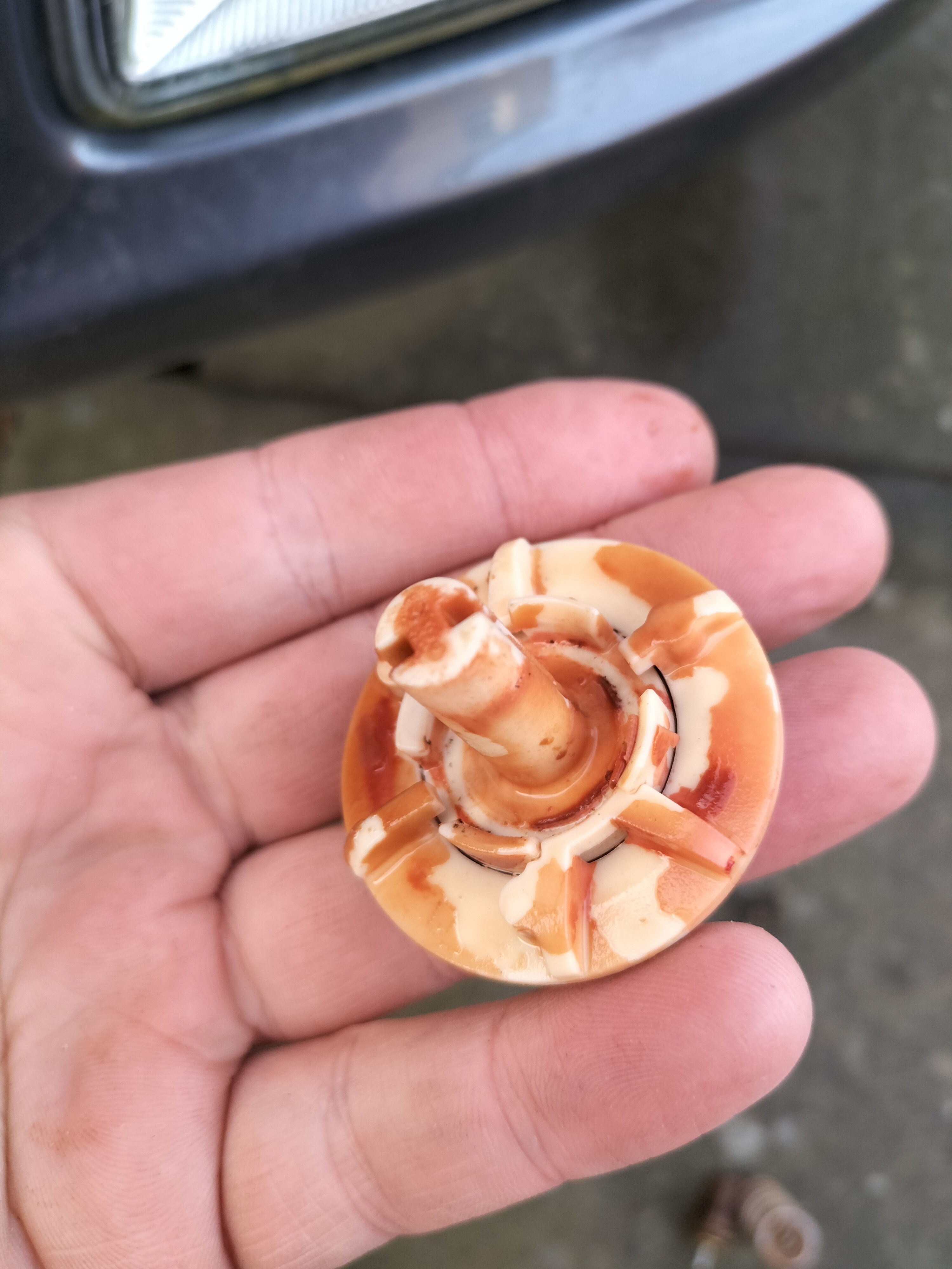

Prior to the rad being changed, rad weld was put in the cooling as a temp fix to avoid a big bill just before Christmas. The coating on the spring and plastic part is like a skin and does peel off.
It could have had incorrect coolant added when it went in for a pressure test to find out it was leaking from the rad and again when the rad was replaced. G12/13 is the correct stuff to use?

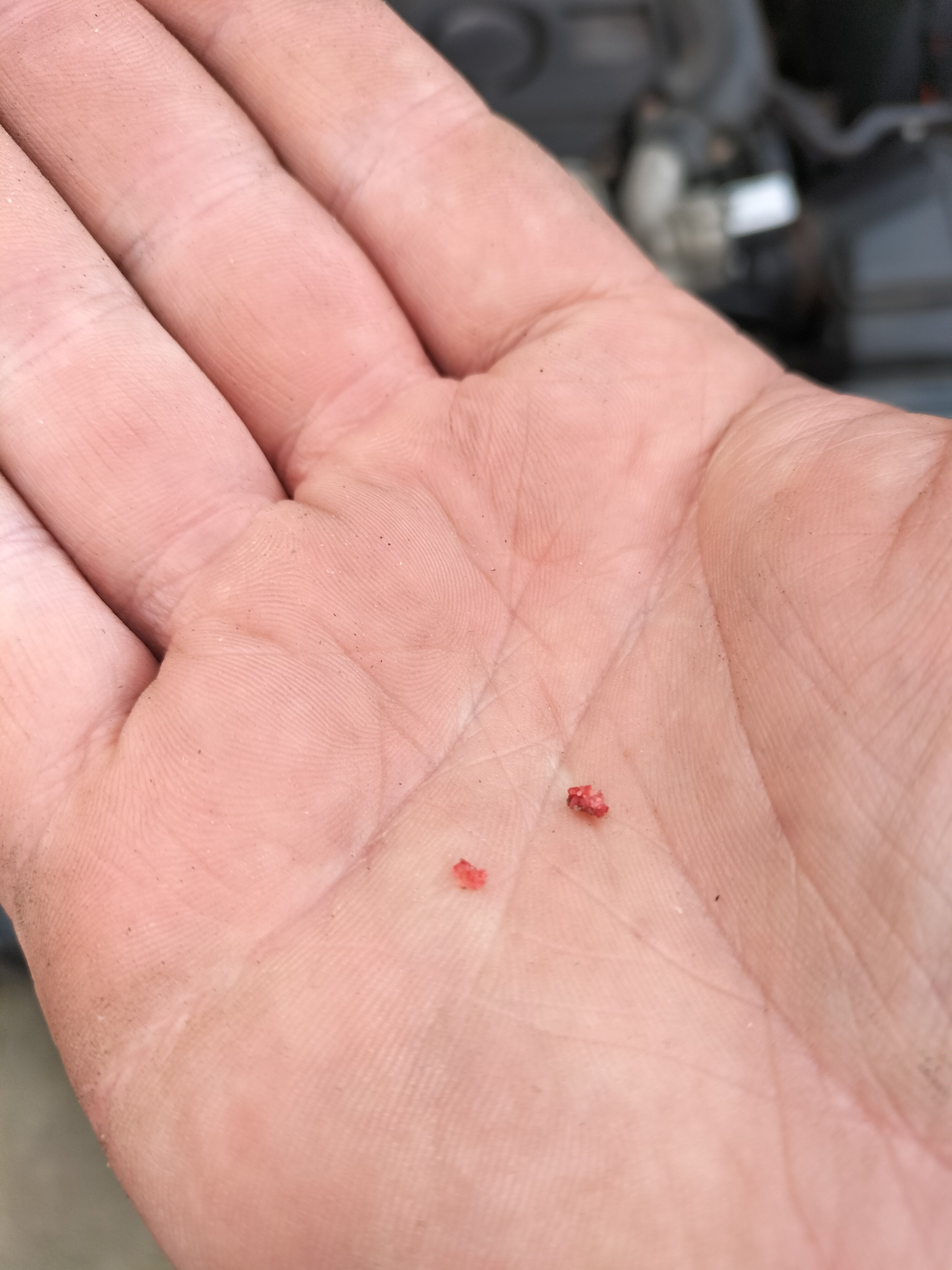

Changed out the thermostat and hasn't overheated since. Plastic and spring part of the thermostat were covered in a film/sludge and I found random bits of red crap (congealed coolant?) around the part that opens. Still having problems with getting hot air at windscreen vents but warmish at the side vents. Tried the flap reset a few times, but doesn't seem to be working this time.
