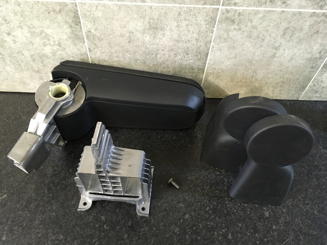

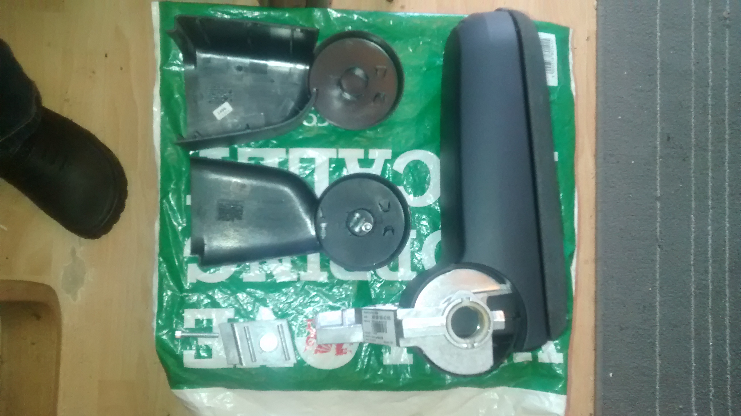

I hope someone here can help. I've taken delivery of an arm rest for my MkII Fabia. Looks as though there is some part/parts missing as ther is nothing that actually attaches the rest to the car but there are four M6 Torx bolts but nothing that they fit onto. Under a pocket that pulls out from between the seat there a four threaded hole that take the bolts. Does anyone have any idea of what fits between the car and the arm rest? And where I can get it from?

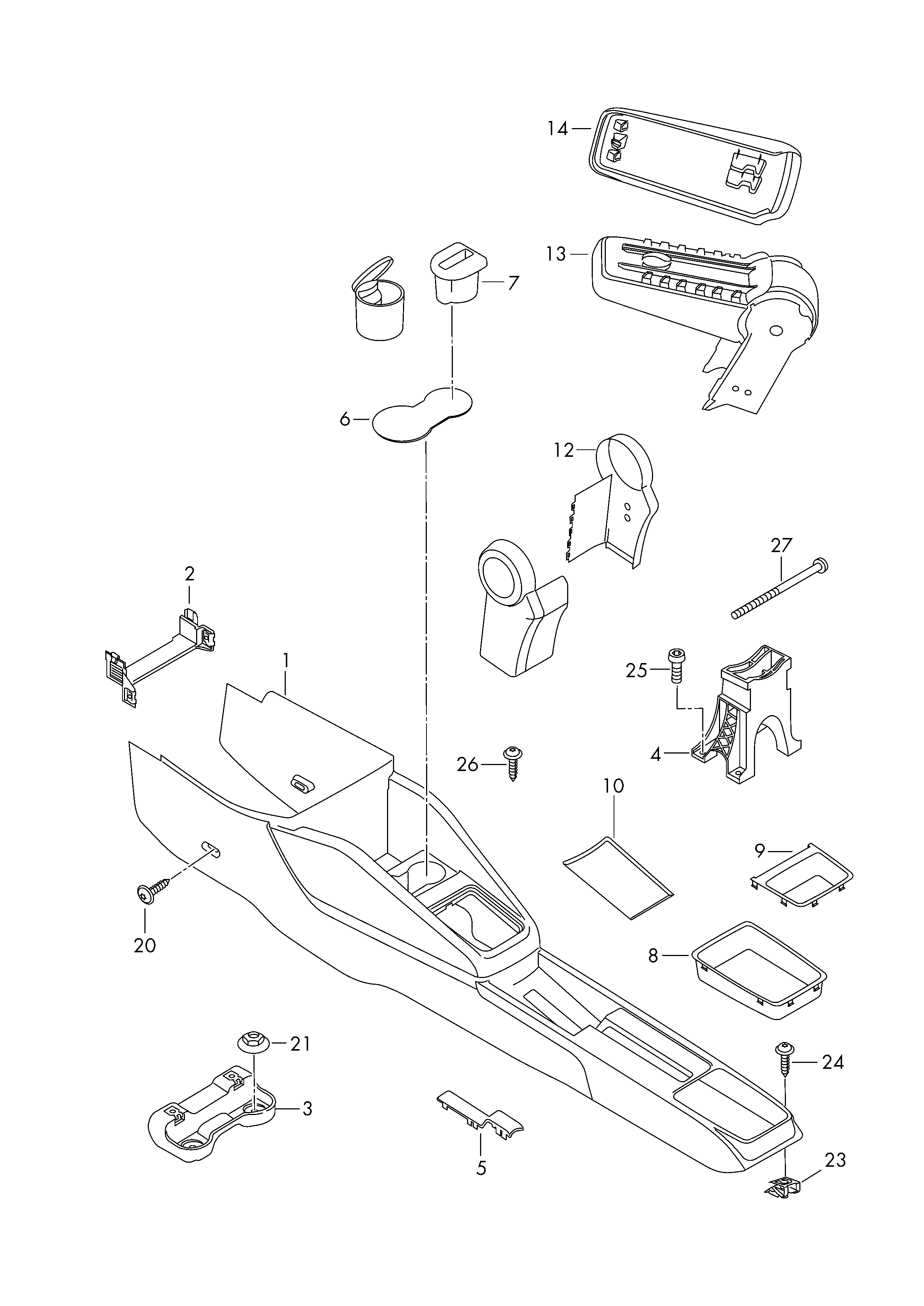

From memory there was
A.plastic thing that had 4 bolt holes in the bottom to bolt to the tunnel
A large section with a. Long bolt which the armrest pivoted in
The two plastic covers for the side
Item no
9
4
25 x4
27
12 X2 different ones
13
14
Thanks Malc for the replies. I have managed to find a guide on here that shows the part I need. It's a different shape (MKII not III) but it's part 4 that I need. The guide shows it to be an alloy part not plastic.britskoda.thumb.jpg.969c2519521e6c0b2ee7119326db7969.jpg
