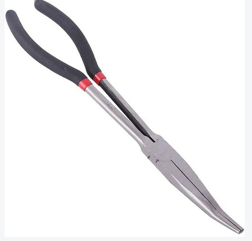

  9. Something like this may help (along with a mirror and torch)
