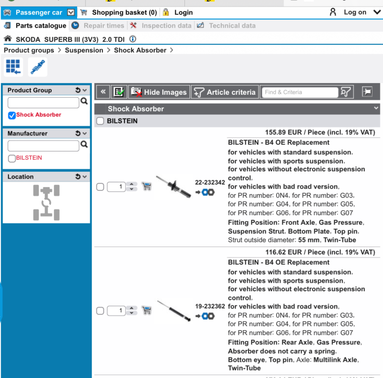

Sorry for late reply, not been on recently... This was what I ordered... Weren't suitable for my Sportline. Ended up selling on ebay to a gent on here that had a 4x4 superb...

I generally swear by the Bilstein's. Been my go to replacement on last 3/4 cars. Have a set sitting in a box here that were on the superb.... found to be incompatible with Sportline model. so be sure to cross check part numbers. So, now have KYB on, they are OK, harsher than Bilstein's. Yeah, simple enough job at the back, all done in the arch. 👍

Minefield! I can’t get my head around how many different part no’s there are for these shocks… final spanner on my side is the rear originals not matching the part no’s worked out from my build sheet… I’m going to order the KYB’s and keep everything crossed they suit! Not getting anywhere matching up to a set of B4’s. Hopefully I can sell the ones I have, to try and recoup some money!

Well heard back from Bilstein this last couple of days… strange response, I’m sure there has to be a few people on here with sportline model that have fitted B6’s or B8’s… I’m lost as what direction to head in… approaching the supplier of the shocks appears like a poss non-starter especially as they are advertised on Bilstein as fitting all models! my current plan is to see if I can find a matching set of OE shocks from a Passat, or something else similar as a possible way to matching up to a more suitable set of B4’s.

Thanks Carlston, I got all my build codes last night, yeah significantly more than the sticker has in the boot. Too add to that, my 2017 car does have a sticker in the boot (it's a 09/16 build). I managed to decode between my build code and the original long list of part codes you posted first that I have.... 5Q0411105HD Coil spring 1 paint mark 1 paint mark brown white 2 PR-L17 3Q0413031BG Gas shock absorber D >> - 29.07.2018 2 PR-G02 3Q0511115T Coil spring 2 PR-1JC+0YB 3Q0513049FP Gas shock absorber rear 2 PR-1JC 3Q0513049FN Gas shock absorber rear 2 PR-1JC Guessing the rear shocks can be either of the 2 part no.s... I've started a communication with Bilstein, hopefully they will come back to me asap. With a confirmation of these B4's not been suitable, and a better recommendation if required... In the meantime, going to review old shocks & try and find paint mark/numbers on springs to confirm all of these... Cheers.

thanks @Carlston, for the detailed response. I’ve purchased a vin decoder.. so see what that comes back with. Assume this is more info than the sticker in the boot? regards the B4 shocks, I have read your post within this thread on this… last night before posting my query today. The shocks I purchased are the only B4 standard shocks offered on Bilsteins website…. so, once I have the info to identify standard shocks, I will review the post you had up. Bit worried/confused why Bilstein wouldn’t offer the Passat shocks you identified as a fitment against the superb. Looking like this is going to be a costly issue if it is the shocks that are an issue /mis-fitment… I checked these shocks against Bilstein, autodoc, and a post on the forum that stated them as a fitment for the superb…. I’ll update post with anything found out… resolution for my dodgy handling… 🙈 fitting B4’s was supposed to be the more cost efficient/sensible ‘it’s just a box for getting A to B’ option, rather than paying twice the price for B6’s or konis!
