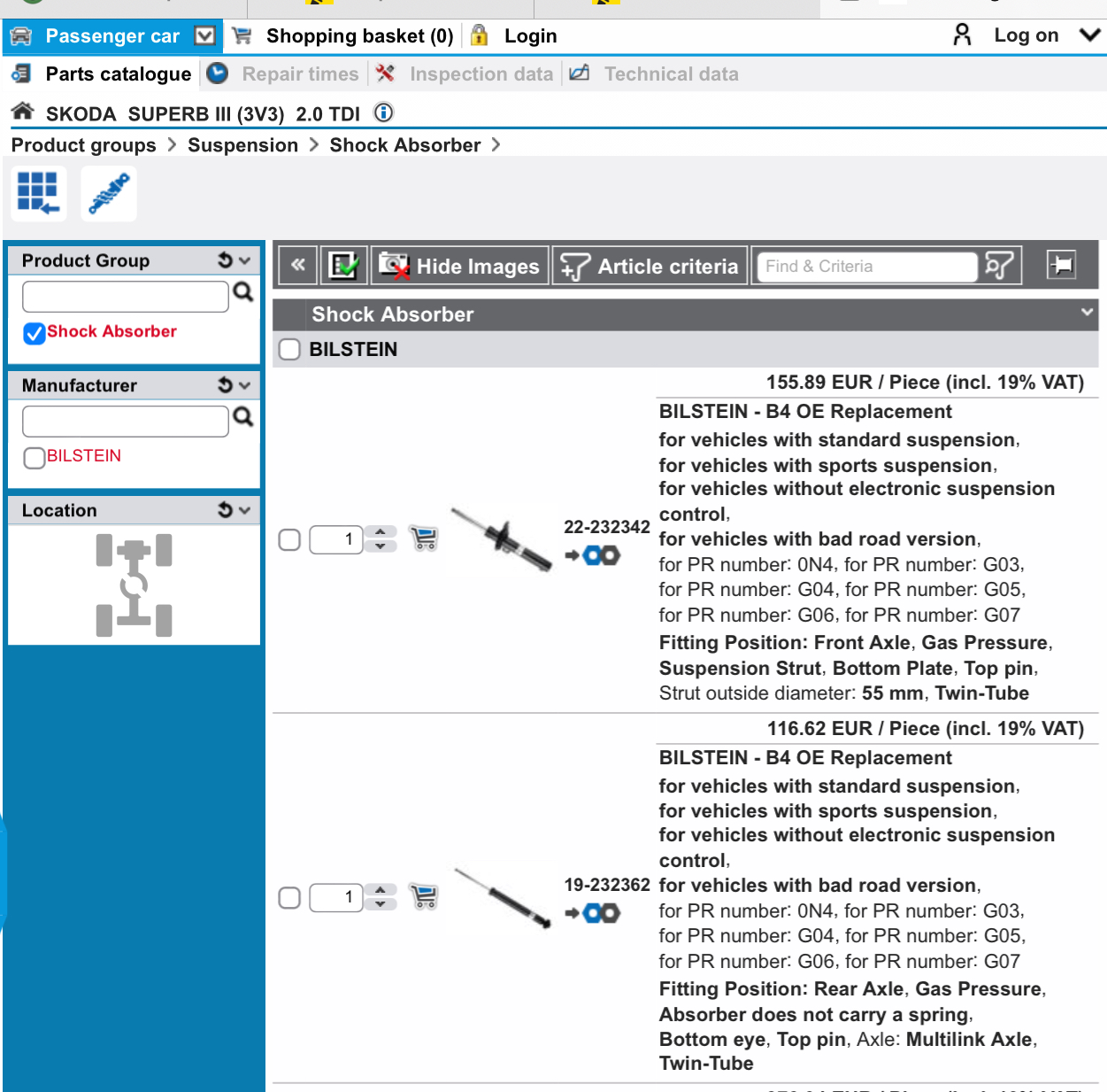

  4. I generally swear by the Bilstein's. Been my go to replacement on last 3/4 cars. Have a set sitting in a box here that were on the superb.... found to be incompatible with Sportline model. so be sure to cross check part numbers. So, now have KYB on, they are OK, harsher than Bilstein's. Yeah, simple enough job at the back, all done in the arch. 👍
  5. Minefield! I can’t get my head around how many different part no’s there are for these shocks… final spanner on my side is the rear originals not matching the part no’s worked out from my build sheet… I’m going to order the KYB’s and keep everything crossed they suit! Not getting anywhere matching up to a set of B4’s. Hopefully I can sell the ones I have, to try and recoup some money!
  6. Although can get a set of 4 KYB’s that match OEM numbers for less than £200 on eBay with discount code just now… not sure how KYB compare to Bilstein.. been my go to for replacements the last few cars…
  7. Well heard back from Bilstein this last couple of days… strange response, I’m sure there has to be a few people on here with sportline model that have fitted B6’s or B8’s… I’m lost as what direction to head in… approaching the supplier of the shocks appears like a poss non-starter especially as they are advertised on Bilstein as fitting all models! my current plan is to see if I can find a matching set of OE shocks from a Passat, or something else similar as a possible way to matching up to a more suitable set of B4’s.
  8. Thanks Carlston, I got all my build codes last night, yeah significantly more than the sticker has in the boot. Too add to that, my 2017 car does have a sticker in the boot (it's a 09/16 build). I managed to decode between my build code and the original long list of part codes you posted first that I have.... 5Q0411105HD Coil spring 1 paint mark 1 paint mark brown white 2 PR-L17 3Q0413031BG Gas shock absorber D >> - 29.07.2018 2 PR-G02 3Q0511115T Coil spring 2 PR-1JC+0YB 3Q0513049FP Gas shock absorber rear 2 PR-1JC 3Q0513049FN Gas shock absorber rear 2 PR-1JC Guessing the rear shocks can be either of the 2 part no.s... I've started a communication with Bilstein, hopefully they will come back to me asap. With a confirmation of these B4's not been suitable, and a better recommendation if required... In the meantime, going to review old shocks & try and find paint mark/numbers on springs to confirm all of these... Cheers.
  9. thanks @Carlston, for the detailed response. I’ve purchased a vin decoder.. so see what that comes back with. Assume this is more info than the sticker in the boot? regards the B4 shocks, I have read your post within this thread on this… last night before posting my query today. The shocks I purchased are the only B4 standard shocks offered on Bilsteins website…. so, once I have the info to identify standard shocks, I will review the post you had up. Bit worried/confused why Bilstein wouldn’t offer the Passat shocks you identified as a fitment against the superb. Looking like this is going to be a costly issue if it is the shocks that are an issue /mis-fitment… I checked these shocks against Bilstein, autodoc, and a post on the forum that stated them as a fitment for the superb…. I’ll update post with anything found out… resolution for my dodgy handling… 🙈 fitting B4’s was supposed to be the more cost efficient/sensible ‘it’s just a box for getting A to B’ option, rather than paying twice the price for B6’s or konis!
  10. Hi Folks, Wonder if any of you can point me in the right direction.... I have a 2017 150 diesel Sportline, have recently replaced the shocks with B4 replacements. The car is at 60k, and the handling was becoming dangerous!! The shocks have now been fitted for ~600 miles, but the feel is not 100%. I had the alignment checked in the first instance... but it was just needing one minor adjustment to correct. Feels like the car is not as planted as it should be, still bounces uncomfortably at slow speeds through town/rough roads. Country roads the car feels much better with the new shocks at 40-60 mph, through a rough bend is not such a concern anymore, the support is greatly improved.... The slow speed discomfort is now the issue... I feel my rear springs may need replaced. The crashy/unspottedness seems to be from the rear more than the front. Struggling to nail down how to confirm the springs I need. This seems like it would be the next step to try and improve the ride.... On a side note, I have fitted a towbar to the car when bought at 45k, so the rear has had more load for around 5/600 miles of the last 15k. Wouldn't have expected that to cause issues with the springs, but maybe the standard ones aren't capable enough of the extra load. (Although just occasional use - with a 1-1.5t trailer (60/70kg nose weight)) I note reading some posts with regards cars with factory towbar's possibly having uprated springs. If anyone can point me in the right direction to confirm standard replacement springs, or alternatively a more suitable spring to compensate for the occasional towing? I don't believe I need a hugely stronger spring, as the car spends most of its time lightly loaded.... Just the 5/6 times away with family in the year full with gear (often with bikes on the towbar) and occasional towing single axle trailer at 1.5t max. Many thanks for any help Marc
