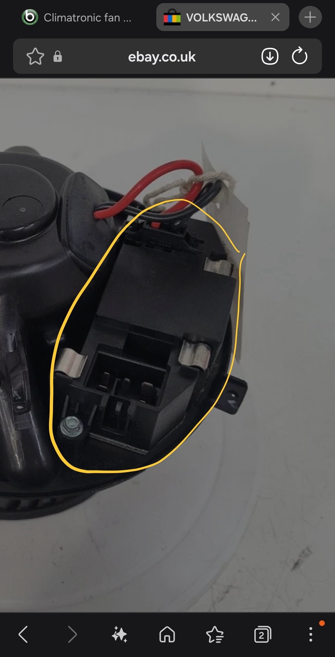

Not sure if the clutch is spinning (don't know wat I am looking for) can anyone mark it on a pic? Ta

Am I looking in the right place?

Right the arrow is pointing to the front pully of the aircon pump, if you look at the front,(the bottom pully in 2nd pic) it should be spinning if the pump is working.
Also the green wire at the back is part of a conection that runs from the clutch at the front, make sure that both of the wires are ok no splits etc.
Hope this makes things a bit less muddy for you.:D:thumbup:
