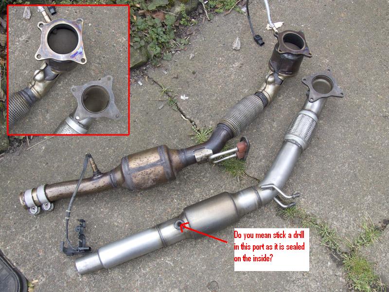

Stage 6 (above) a comparison of the stock 2.5" DP and the 3" PipeWerx DP, note that the stock DP appears to have 2 catalysts, one directly after the Turbo and another further down the pipe and it is pretty narrow in places.
The Pipewerx DP is very straight in comparison with minimal bends and changes in diameter. It also has some very nice welding (if you like that kind of thing!) and looks to be of exceptional quality. Overall it fit perfectly with only a minor adjustment being made to 1 of the 2 mounting prongs, it was about 10mm out so I had to bend it back using a bit of pipe for leverage...30 second job

vRSy PM'd me to say you were getting come errors? did you drill out the blank C02 sensor hole? if not, you will need to. i got intermittend CEL light saying that the CO2 sensor was slow to respond.

Thanks Ron, I tried to PM you directly but had a 'no can do' message. I got a CEL which Shark's STS unit showed as a P0139 and a P0140 code relating to slow and non-functional rear O2 sensor respectively. I cleared the codes and CEL went out although P0139 returned with no CEL.
For the life of me, I really do not remember two rear O2 sensor ports (you meant O2 rather than CO2 , yes?) and would be surprised if I missed that...however, I have done dumber stuff in my time! In fact, I can't even see it on the picture up above ( http://briskoda.net/forums/uploads/2/6/7/8/3/27492.attach ) of your DP. I will get the car up in the air and have a look. Interestingly, I also found the following thread:
http://www.mk5golfgti.co.uk/forum/index.php?topic=7760.15 I can see the alternative sensor ports on the final picture here!

Hold on, I think I have been taken off in the wrong direction after being confused by the picture on the GTI forum...
Do you mean that there is only 1 post-cat O2 sensor port but it is blanked off on the inside by a steel tube which shrouds the sensor. So, even if you screw in the sensor, it will go in fine but can not 'see' the exhaust gases? I stuck my pinky in to test this before but would not have sussed this method of blanking out the sensor.
If so, was it a case of just sticking a large HSS drill bit in and drilling it out (and hopefully not going through the other side of the exhaust ;) )
Edited by muckipup
thats my take on it, there were only two holes on my DP, so i think he must have drilled one of them, one at the top by the turbo, and the other on main pipe. i think it was the second one he drilled

Jeez, I think you are right. I have since found this thread from the Hof:
http://briskoda.net/forums/topic/123927-performance-down-pipe-question/
If my post-cat sensor port is capped off in such a way then that would explain the P0139 code - no wonder the sensor is reading as inefficient if there is a steel tube shrouding it off from the exhaust gasses!!!

Yep, second sensor hole is blanked off on the pipewerx DP, Ian who makes them said it was due to some big turbo conversions running too rich and so ruining the second O2 sensor but on a standard turbo like my car was I had to drill this out as it caused a CEL, it fixed the issue. Easy job, £3 6mm drill bit did it as you just need to puncture the blank so that the gasses get in and not completely drill it all out.

UPDATE: I went under the cat and popped the O2 sensor out. The port for the sensor was not blocked-off on my PW exhaust. Perhaps they stopped doing this.
