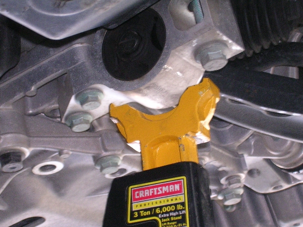

Where did you put the axle stands for holding the car up? Normally when jacking up on the sill, you need a hockey puck with a slot in it. Do you need something similar for the axle stands?
Edited by FatblokeVRS
under the front aluminum console bushes either side should be fine and no puck is needed as the console is curved and sits nicely in the axle stand
Any chance of a photo??? Would that bit be strong enough on a CR with all the extra weight?
