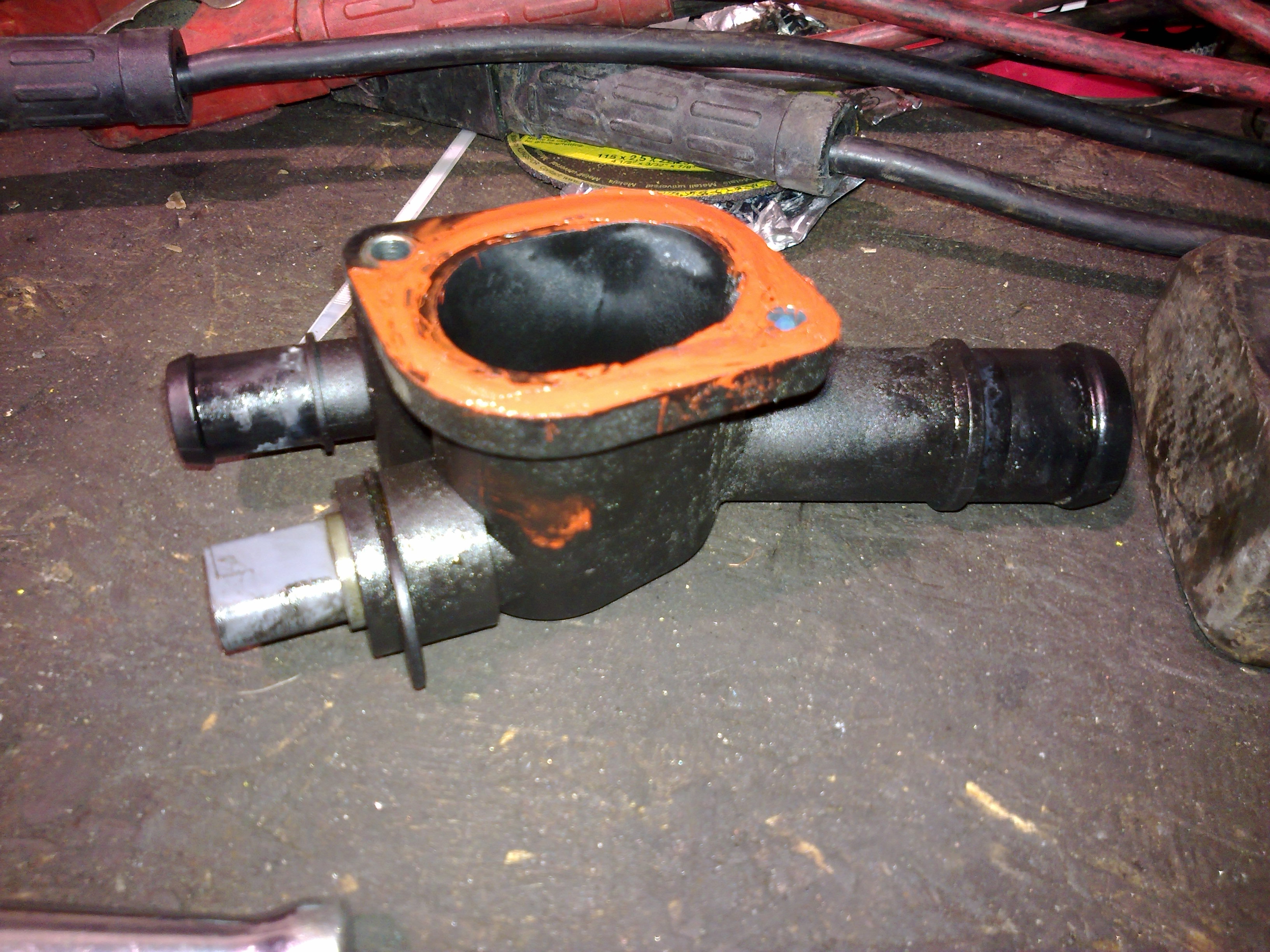

Hi, sorry to revive such an old thread. While trying to track down a coolant leak, my mechanic traced the leak back to this unit. The rubber seal sits in a little channel and a portion of this seams to have given way (melted??) causing the rubber seal to give way in a couple of places. I think this is the thermostat housing, its located on the right hand side of the block underneath the metal EGR pipe.post-22824-0-89834300-1323042831_thumb.jpg
