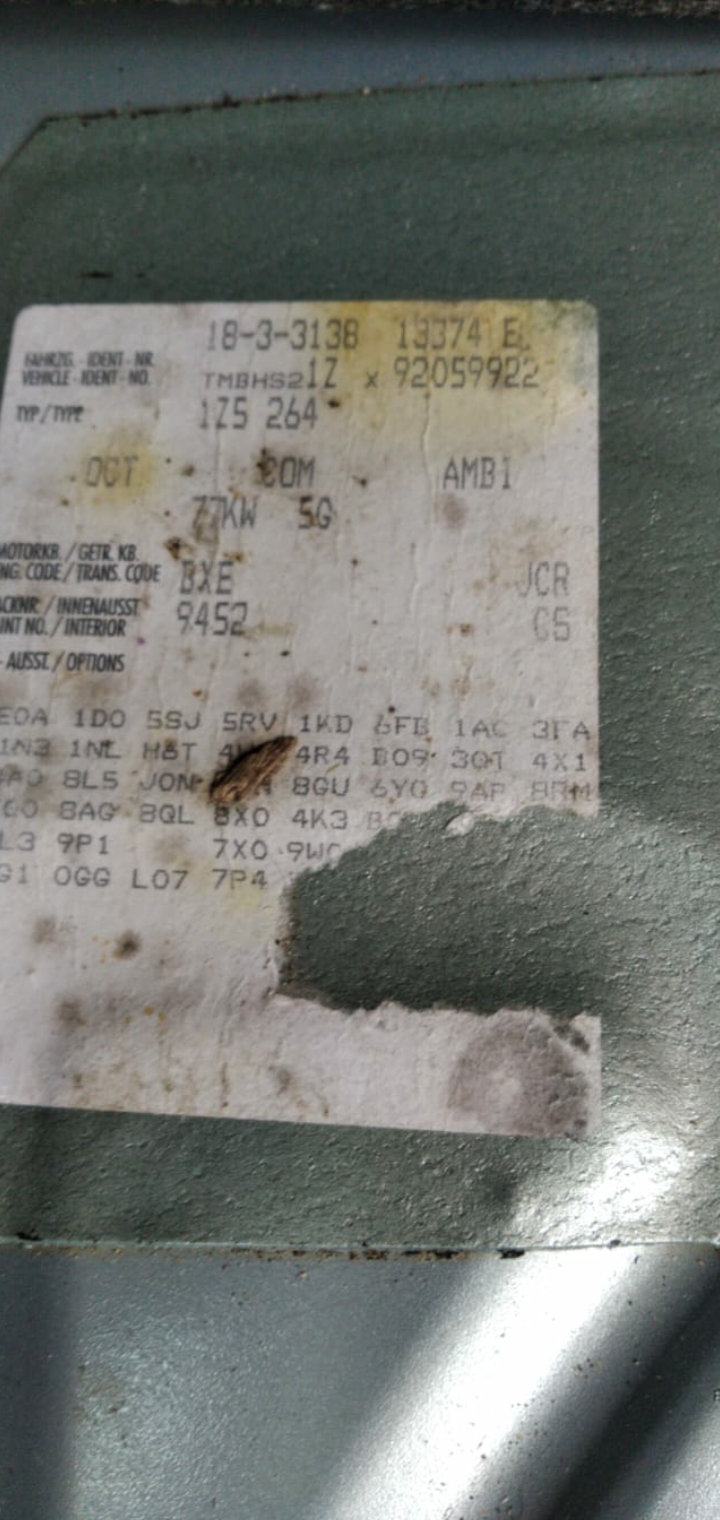

If exhaust pointing down there should be no dpf but also a great way to tell if it has a dpf or not in the cross over year of 2009, lift boot floor cover,lift out spare wheel, there should be a label there, if you see the code 0gg(theres no dpf)👍see pic

my car is 2008 Skoda, I checked the lebel, with an OGG there. so no DPF.  But thanks for the help.

for skoda:
code: OGG - NO DPF filter
code: 7GG - YES, DPF is installed
