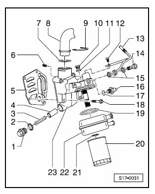

location of oil pressure switch
octy 1.8t had a quick look and could only see 3 sensors on the oil cooler on the block is it one of these? if so which one, thanks in advance
Edited by mikelvrs
The oil pressure switch is Part No 16 on the attached diagram:
I've seen oil pressure problems on more than one 1.8, caused by a blocked oil pick up.
