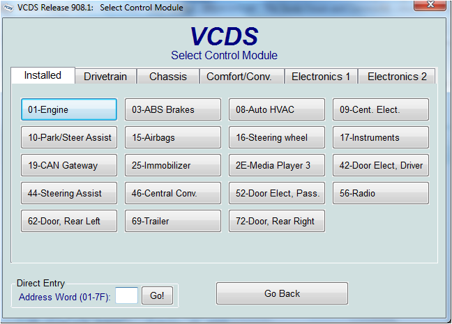

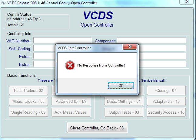

I have just got my VCDS (HEX+CAN) and have run a fault code check and I appear to be unable to access the Control Conv module #46
I have an Octavia vRS FL Estate - November 2009 and am using the HEX+CAN and 908.1 software
The output below shows that the moddule #46 is OK, but it just skips it as can be seen.
Any ideas?

Quote from matrix... ;) "There is no spoon."
46 got incorporated into 09, hence no 46 anymore - just 09.
